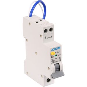

I have heard it mentioned that consumer units are often not tall enough for ease of fitting RCBO's.
Some may be more difficult to fit - but that's just poor design by the manufacturer.
Not all RCBOs are tall either:
Other manufacturers are available, although in the case of the cheaper ones, they probably all made in the exact same factory anyway.
