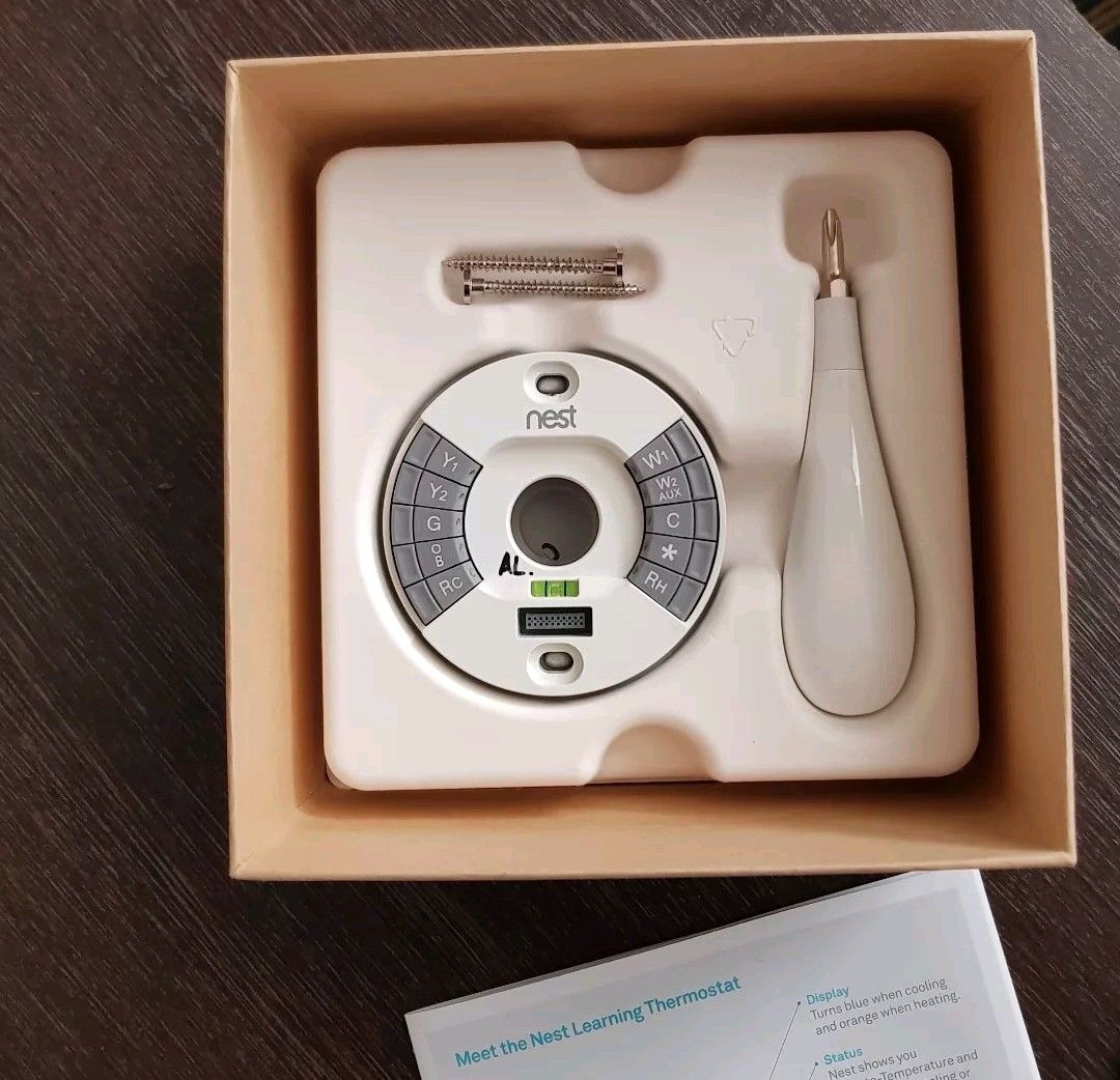

Unfortunately I have 1st Gen Nest so there's no Heat Link with it. I do have the following Wiring Base:
Would you be kind enough o suggest the connections for this please
Sorry then I can't help, you. I have never seen one like this, only the versions with a Heatlink, and so I don't have a wiring diagram to know what each of the terminals does. I suspect that it may only be suitable for 24v operation and the wires in the diagram for your boiler are 230V so you might not even be able to use it. Hopefully someone who has experience of it will be along shortly to assist.
Yes I can thanks, and I'm afraid I can confirm stem's suspicions. This is the American version and is not compatible with UK heating systems, you've been sold a dud
:(:cry: Really
That's too bad. I got it from ebay last week. Seller was from UK as it was delivered in couple of days. He didn't mention anything this being Us version and no compatibility with UK systems
