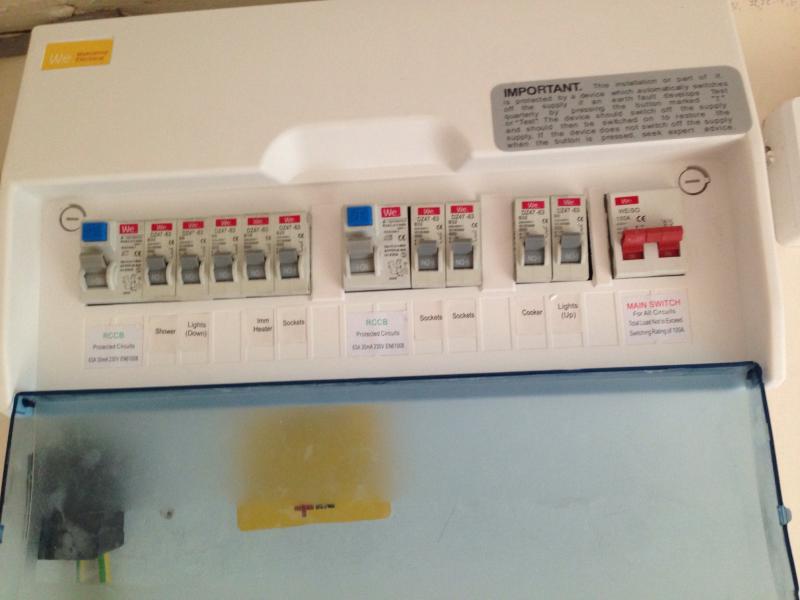

JBH Can we have a pic of your consumer unit please?
Its very handy if you can post photos like this.
//www.diynot.com/forums/viewtopic.php?t=129539 Tks
Here's pic
There is no easy fix, the switching arrangement will need to be rewired for it to work.

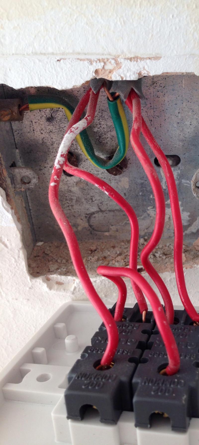

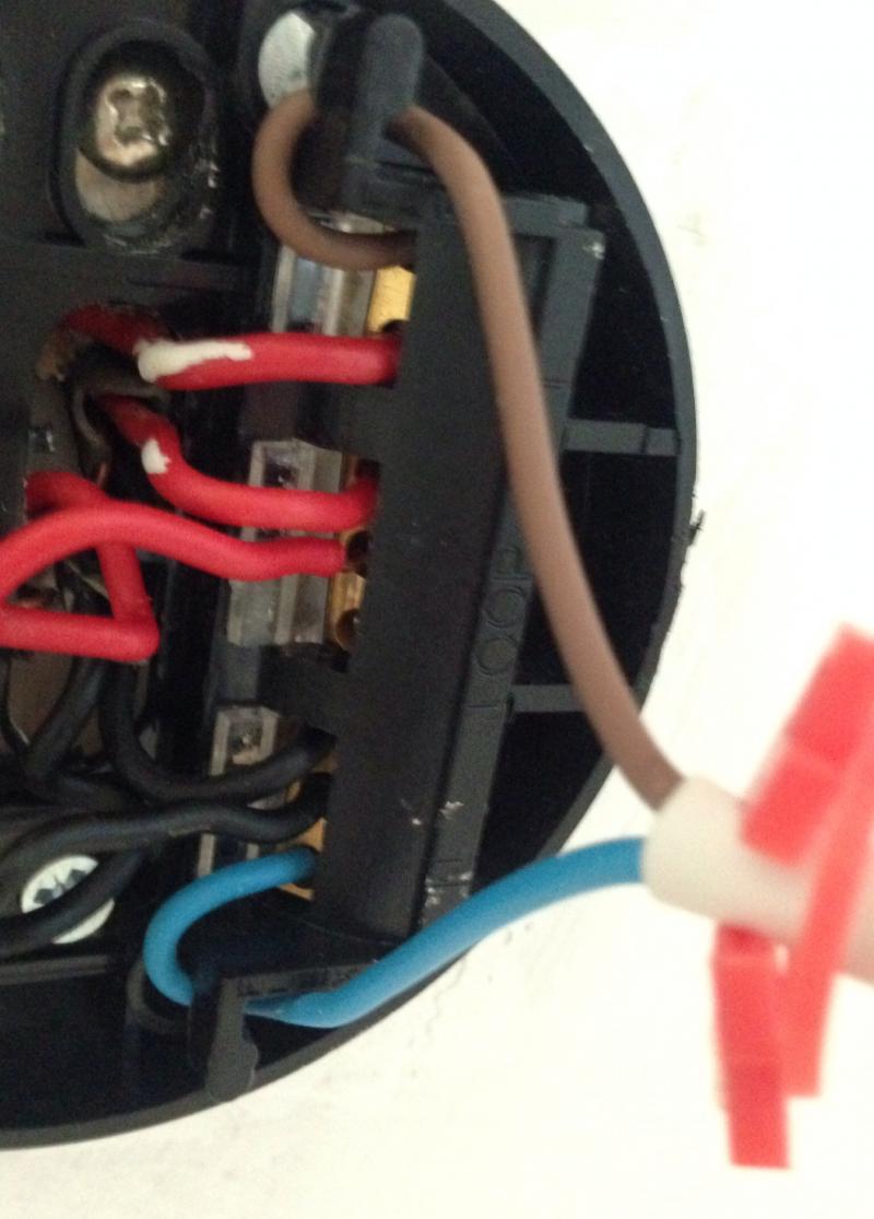

Step 1 is to replace the single cable between the light and upstairs switch with twin and earth. This will get the upstairs switch working and is quite easy.
Step 2 is to replace the cable between the switches with 3 core and earth which I would imagine is more difficult!
Do we know for certain it is a single cable?
Could it be a twin and earth cable with one core cut off?
I imagine a picture of the upstairs switch would help.
Call Mr Suspicious, but I wonder why there's a blank between the sockets and the cooker MCB on the right hand RCD set…...
