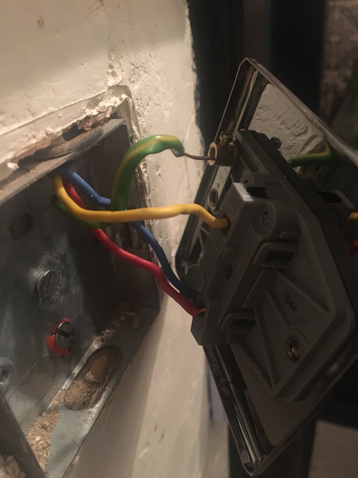

Hi I have a switch with three red wires and 1 red and 1 yellow . I have no idea where all the red wires go to get the switches to function properley. It is a hall landing light . I can manage to get it to turn on and off but not sure how it to function to turn off once on from down stairs to up. Hope am making sense help me !!! I have tried it 100 ways am sure
I thought I could remember the way it went back not so clever as proven. So no idea after mesing with it the correct positions of the wires. The red wires in the top at present is the wire to connect the switch down stairs. Just can’t figure the others does one go to each other section the down stairs only has one red wire help
Move one of the reds (doesn't matter which) that is with the blue and put it with the yellow.
The Red wire at the other switch must be in the single terminal end with the Blue and Yellow at the other end.

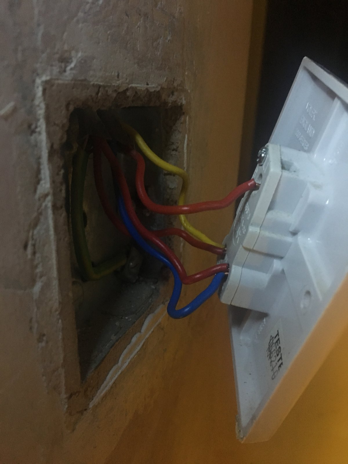

This is the down stairs I have left the old switch plate up stairs but changed the down stairs but it’s not working does the wiring look ok on this pic to mirror what you have said red in L1 blue in L2 yellow com

Would you put the red in com on the new switch if you are saying single terminal end sorry was not sure which area was single terminal end

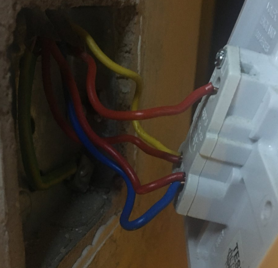

I would put the mew switch upstairs if you could guide me. In relation to wires in L1 L2 Very much appreciated. I have figuered that the red in the L1 in the white switch is the main red to down stairs.

OMG it worked you are amazing haha thank you. Does the earthing look on on the metal plate . On previous pic and please could you type the colour codes and area codes for me to add the new switch please if possible. Would the yellow and red go to L1
The earth attaches to the face plate if it is metal.
Just copy this to the new switch:
Do not mix up the lone red.
The others don't matter except Red and Yellow to one side and Red and Blue to the other.
