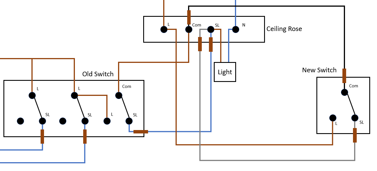

I'm fairly certain the answer to this is no... because you wouldn't be able to wire the common, but I thought I'd see if anyone had any bright ideas.
I've got an existing light which has a single switch cabled as a 2 core live/switched live. Is there a circuit possible which will add another switch to make this into a 2-way setup without changing the cable to the existing light switch (which is buried in a wall)?

Thanks - I guess I should have clarified I meant without having to change or run a new cable to the old switch. I was wondering if there was a way of doing it at the ceiling rose.
Yeah I looked as LightwaveRF stuff, that can do hub-less master/slave but it all seems to be priced a little over the top. You're looking at around 80 quid to do a single 2-way setup.
Actually.... I think it is possible... because the existing switch is multi-gang and has other lives in it. If I pinch one of those Lives from another light to be the Live in the first switch, then use the existing 2-core as Common/Switched up to the rose, then use 3-core from there to the new switch... I think it'd work right?
Like this:
I guess the danger here would be potentially mixing Lives from different circuits - but if I verify that all the lights in the old switch are on the same circuit, is there any problem with doing it this way?

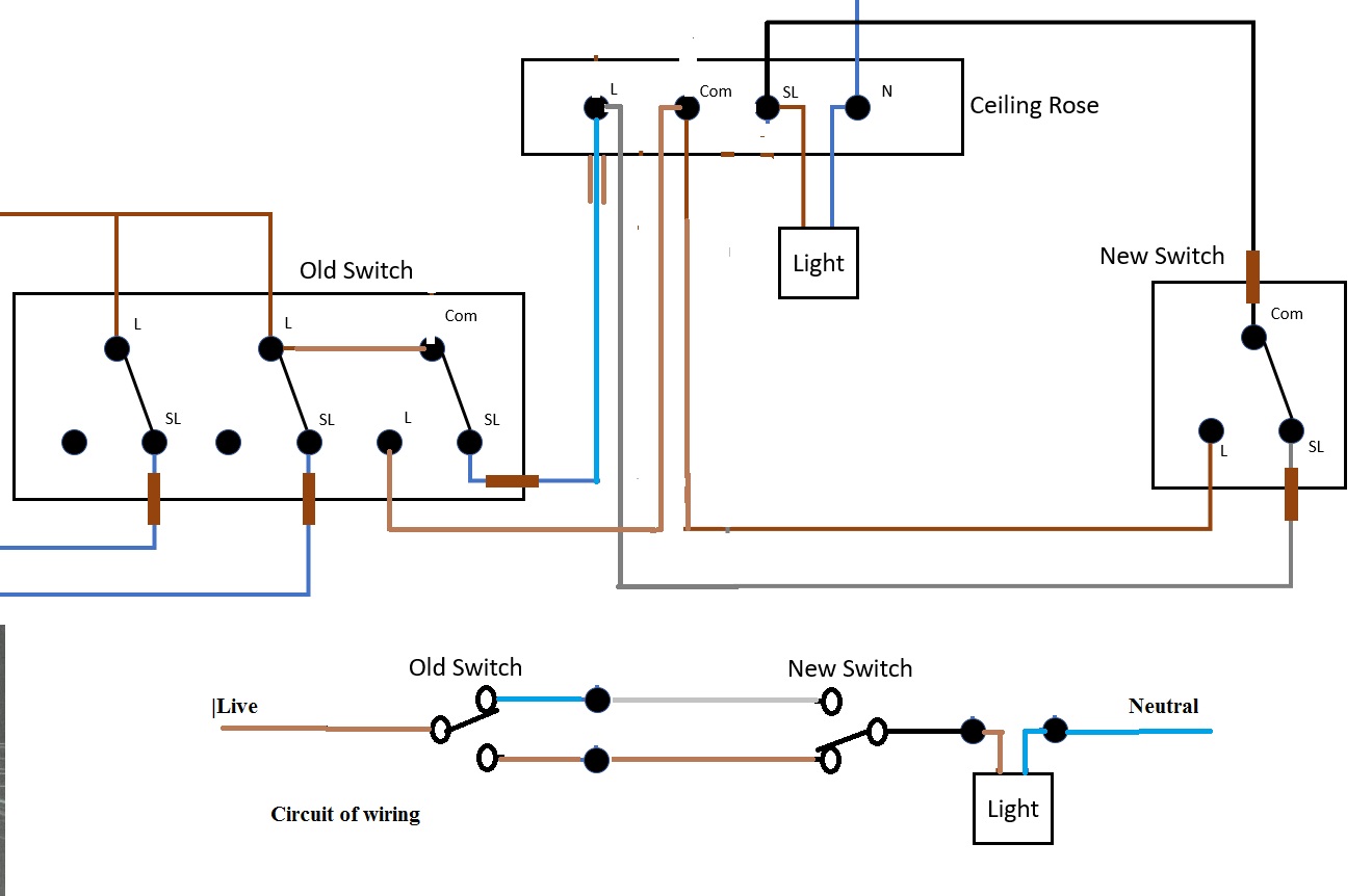

This way may be easier to wire.
The now unused Live in the ceiling rose would need to be terminated in a terminal block
