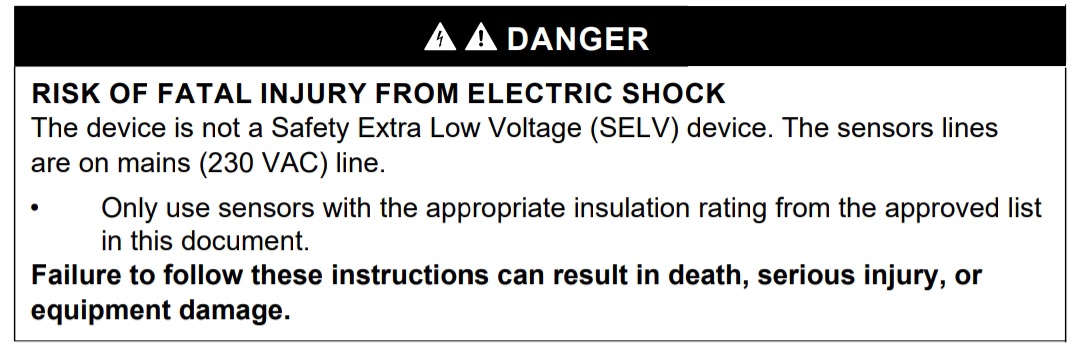

230V rated electric UFH temperature sensor
23 Jun 2006
344
9
Hampshire
I've just got a Schneider Wiser electronic load controller which I was intending to use to replace the existing UFH controller for the bathroom floor. https://www.draytoncontrols.co.uk/product/wiser-electrical-heat-switch
The only issue is that the sensor lines on the new controller are not isolated so they require a temperature sensor with mains rated insulation as can be seen in the attached pic.
I have their sensor which has the correct rating but its bulky and wont fit in the pocket in the floor!
Before I hack up part of the floor does anyone know of an analogue 10k NTC isolation barrier that I could add to the existing sensor?
