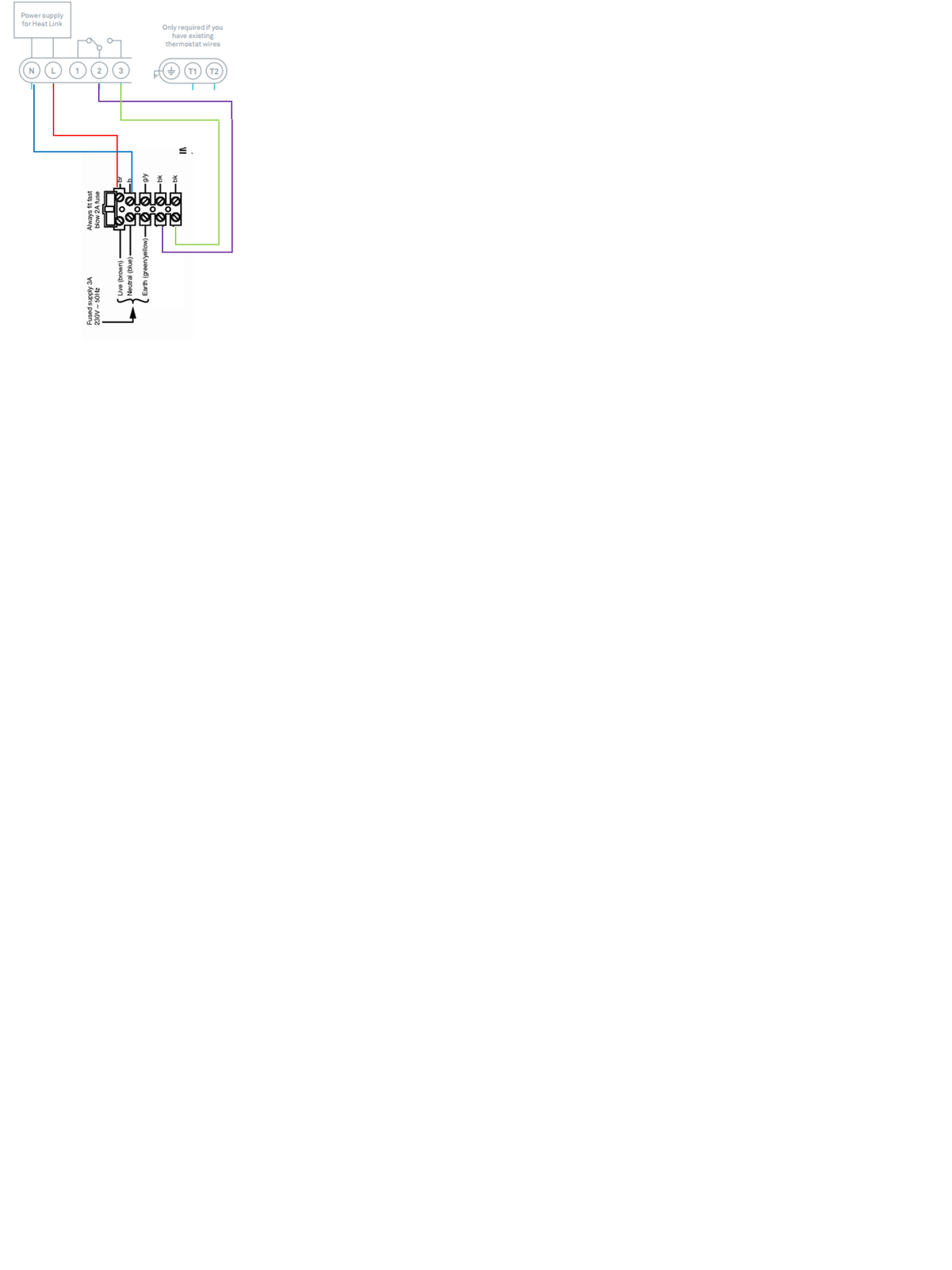

1. Removed existing link cable in Boilers terminal block - see attached picture
2. Installed and wired the Heat link to the mains (240v) and connected terminal points 2, 3 to the link cable i have removed in point 1
3. i installed and connected the thermostat and everything looks good.

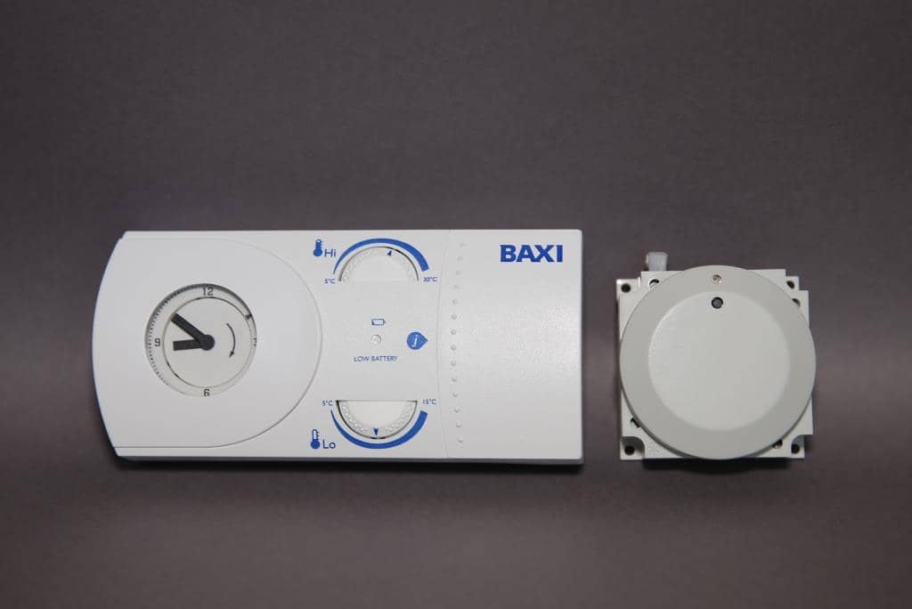

7. After investigation i found that the existing setup had a 24 Hour Programmable Room Thermostat single channel connected (see attached).
8. again after researching the internet this is a primitive connection (RF/wireless) thermostat which has a receiving device connected to the boiler.
9. i made the assumption that this thermostat may overide and stop the NEST working therefore i removed the connecting cable from the fitted RF device to the system motherboard and removed batteries from thermostat,

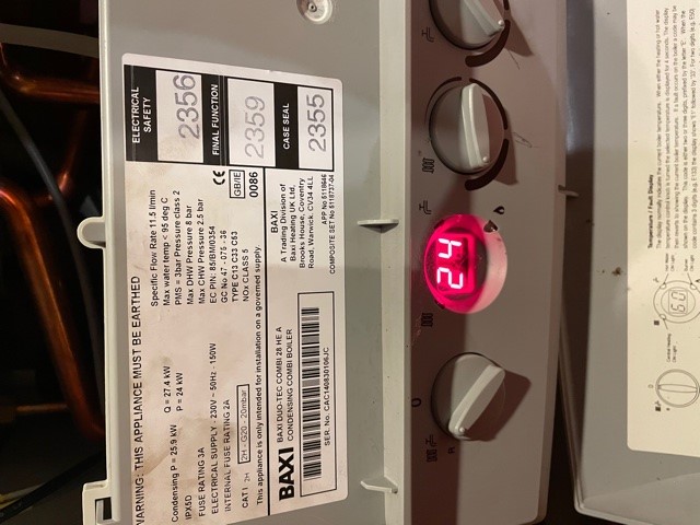

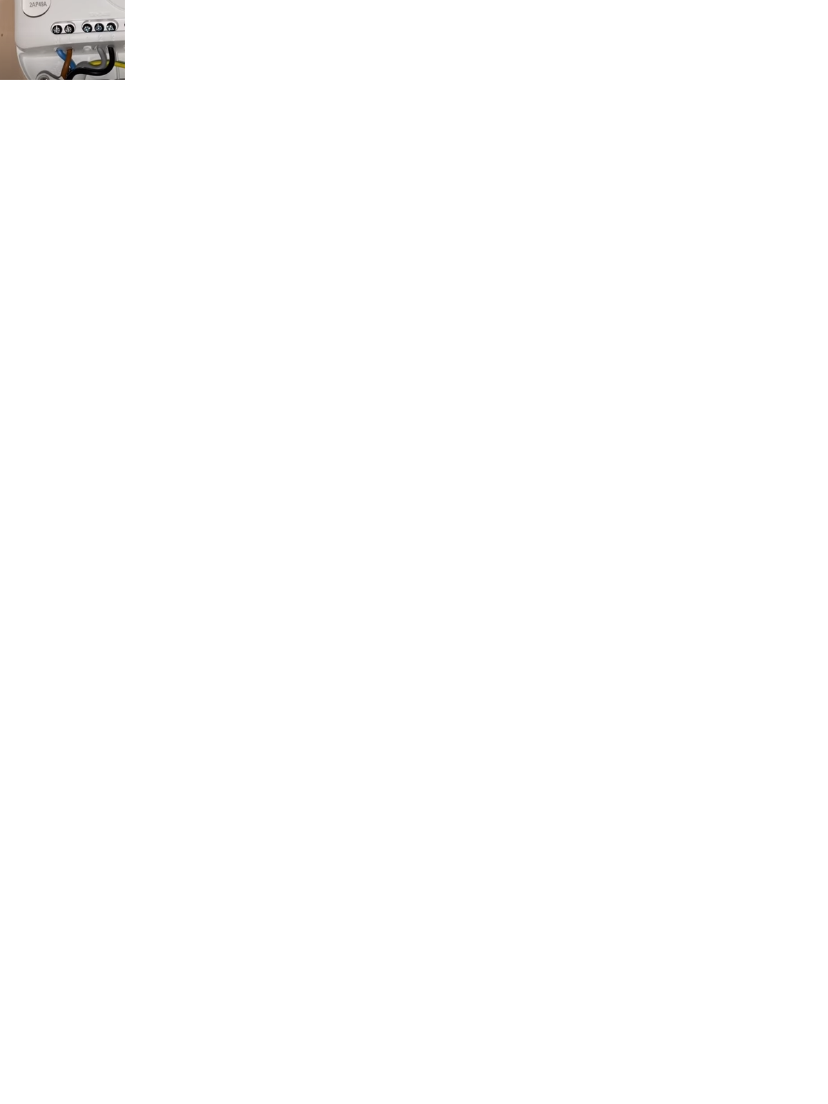

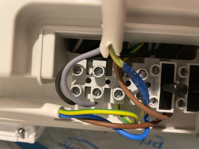

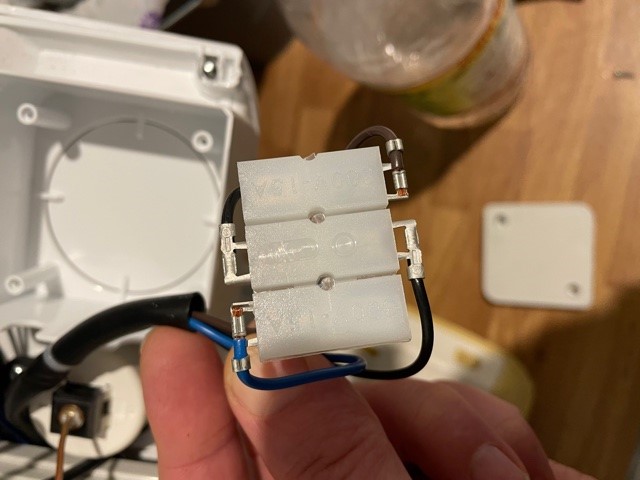

Please post photo’s of boiler wiring, nest wiring and boiler front panel.
Hi
Thank you for your reply.
Attached pictures as requested.
i have also checked with my neighbours boiler (same model) and attached the picture MY BOILER which shows there boiler with no programable thermostat.
if i replicate this with my boiler ie put connectors back as in my picture would the HEAT LINK work.( removing RF/wireless thermostat)
It would make common sense i guess as i previously had two thermostats in situe.
thank you in advance.

2 thermostats , was that one upstairs and one downstairs ?
I think it’s possibly more of a case of the old one was left in as well as the new one?
Not sure if this is relevant or why it will not work, on the photo at boiler it appears that the earth wire is being used as a neutral, yet nest end shows neutral wire and earth wire?
HI
Yes i dont the power issue is the problem, i acknowledge that the installer has used the earth as a neutral.
So basically the call to heat is not working from the NEST heat link - they have used 1.5 flat twin and earth , solid cable rather than strand, would that cause an issue.
is there any further tests i can carry out ?
And yes the old RF receiver was left in, i have removed it and re linked the blacks and isolated the Neutral and live, still no joy.
You could try disconnecting the wires that were for the old receiver, if that doesn’t work, maybe place a link on two switching ports on Nest, if it fires up, probably a faulty nest?
