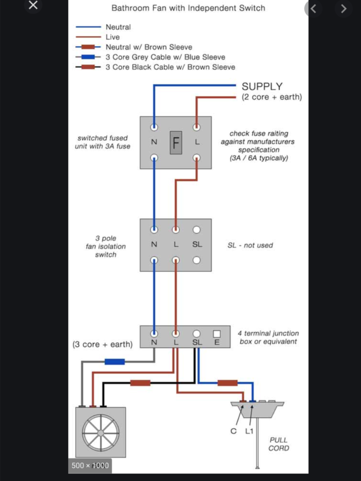

Hi, removing the fuse makes the light go out. The way it’s wired is that there is a 3 core and earth used going into the fan isolator switch. There is then 3 core and earth used as a link to the 3amp fused switch. There is 3 core and earth then going into the en suite which I have put a temp light on to test the supply. The three core to the fan isolator has live, switch live, neutral and earth connected. The link out to the uses live, switch live, neutral and earth. It goes to the 3amp switch but only live, neutral and earth are connected. The switch live is connected to a terminal block. There is a 3 core and earth used from the 3amp switch and this runs into the en suite. Only live, neutral and earth are used. Switch live connects to the switch live in the terminal block coming out of the fan isolator. He has wired the main bathroom fan the same way. The fan isolator in that also makes the neon on the 3amp switch go out. This is the multimeter. Just need to know the setting I should use to check for a supply and if the lights need to be isolated at the consumer unit.
This is why I am confused as to why it is wired this way.

Not sure what you mean or where that comes from. It does not match your description.
In the diagram, the 3-pole switch is completely unnecessary as the FCU will isolate the fan.
I have never seen instructions require a 6A fuse. The circuits in Britain have a 6A circuit so it would be pointless.
Actually the 3A fuse is almost as pointless electrically but an FCU, when used, has to have a fuse in it.

You should still wire it as per my diagram.
You can use the 'out/load' connector to join the two switched live wires, otherwise the fuse will not protect the switched live.
