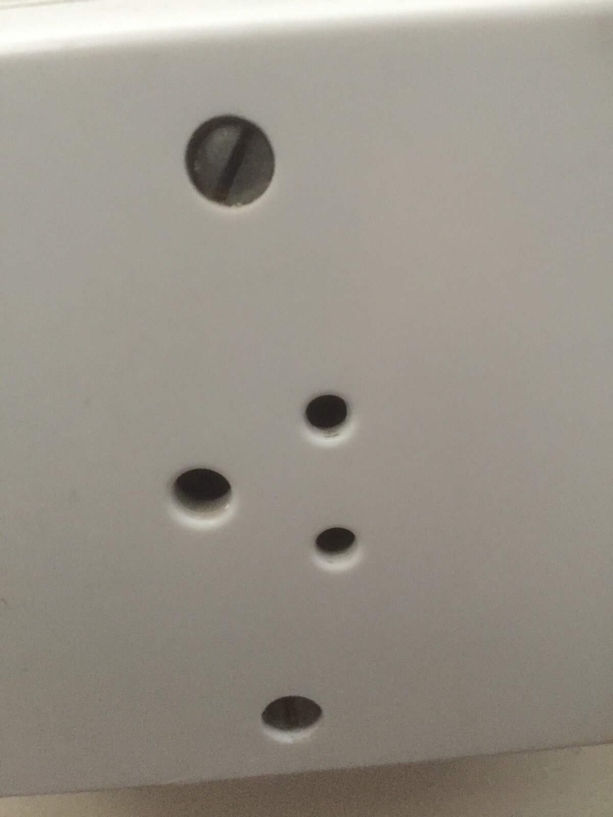

Hi, I’ve recently moved house and in one of the bedrooms there is a 3 pin socket. Can someone please tell me what it would have been used for?
Kind regards Dave

Providing an electricity supply ,via a suitable plug ,to something. Possibly a lamp.
It’s a 5 amp socket. Usually used (in the past) for powering a low power device or plug in light from the lighting circuit.

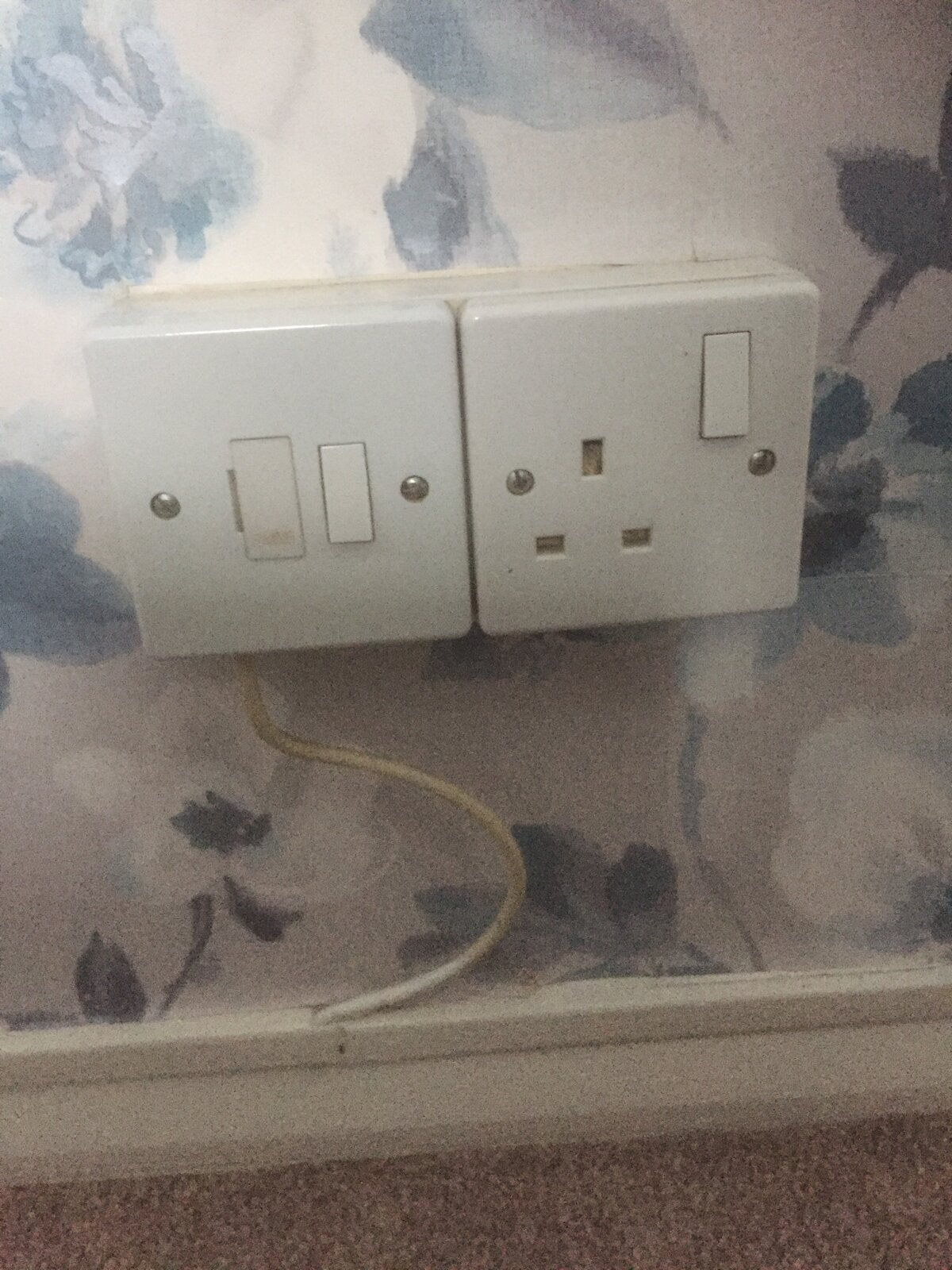

Should I disconnect it or leave it in situ as I don’t think I’ll be using it?
If you want to remove it you first need to consider what you’re going to do with the wiring. Simply removing the face plate means that the wires supplying it will still be live. Are you able to disconnect the supply at the fuse box?
Does the cable from the switched ,fused ,connection unit go directly to the socket in question ? You need to establish that ,and if it is ,you can disconnect from the connection unit.
This is how it’s connected
