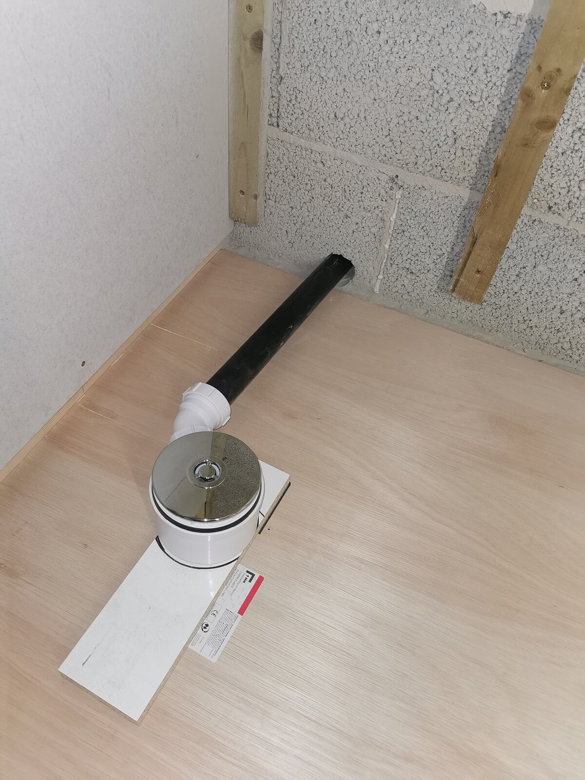

I've cored through the wall for a 40mm waste from the shower and now need to arrange the pipe along the outside wall to the svp, the utility room is upstream of the shower and will have a washing machine and tumble dryer in a standpipe.

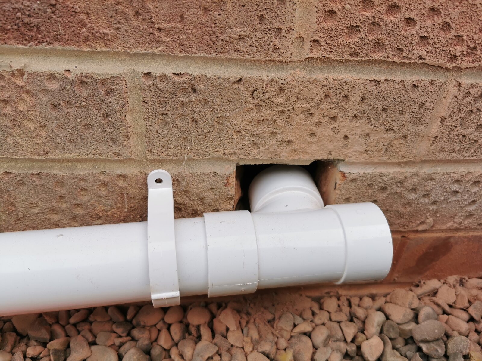

If you need to upsize the pipe, then use a standard 50mm tee and 40mm pipe reducer.
I've seen them but I'm concerned how close I'll be able to get everything to the wall if I add the reducer into the tee
Could you place the tee slightly lower and use a knuckle elbow?

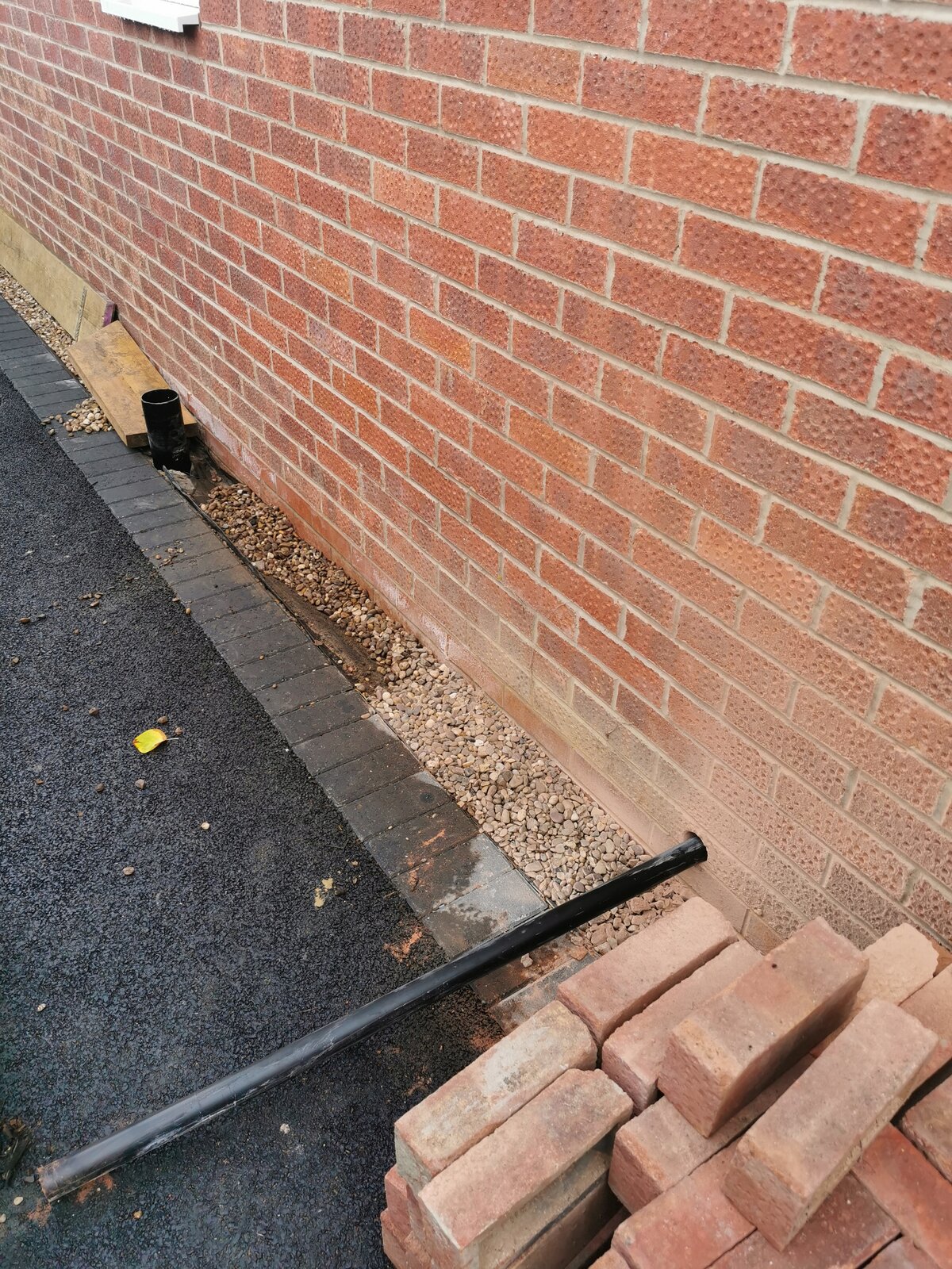

This is what we're working with, that 40mm waste needs to get to the svp sticking up to the left. Utility waste will come out about 300mm to the right other side of those bricks.
Taking the shower trap apart looks like I could get a snake down it if required and I'll put a rodding point on the utility pipe end to rod the full length.

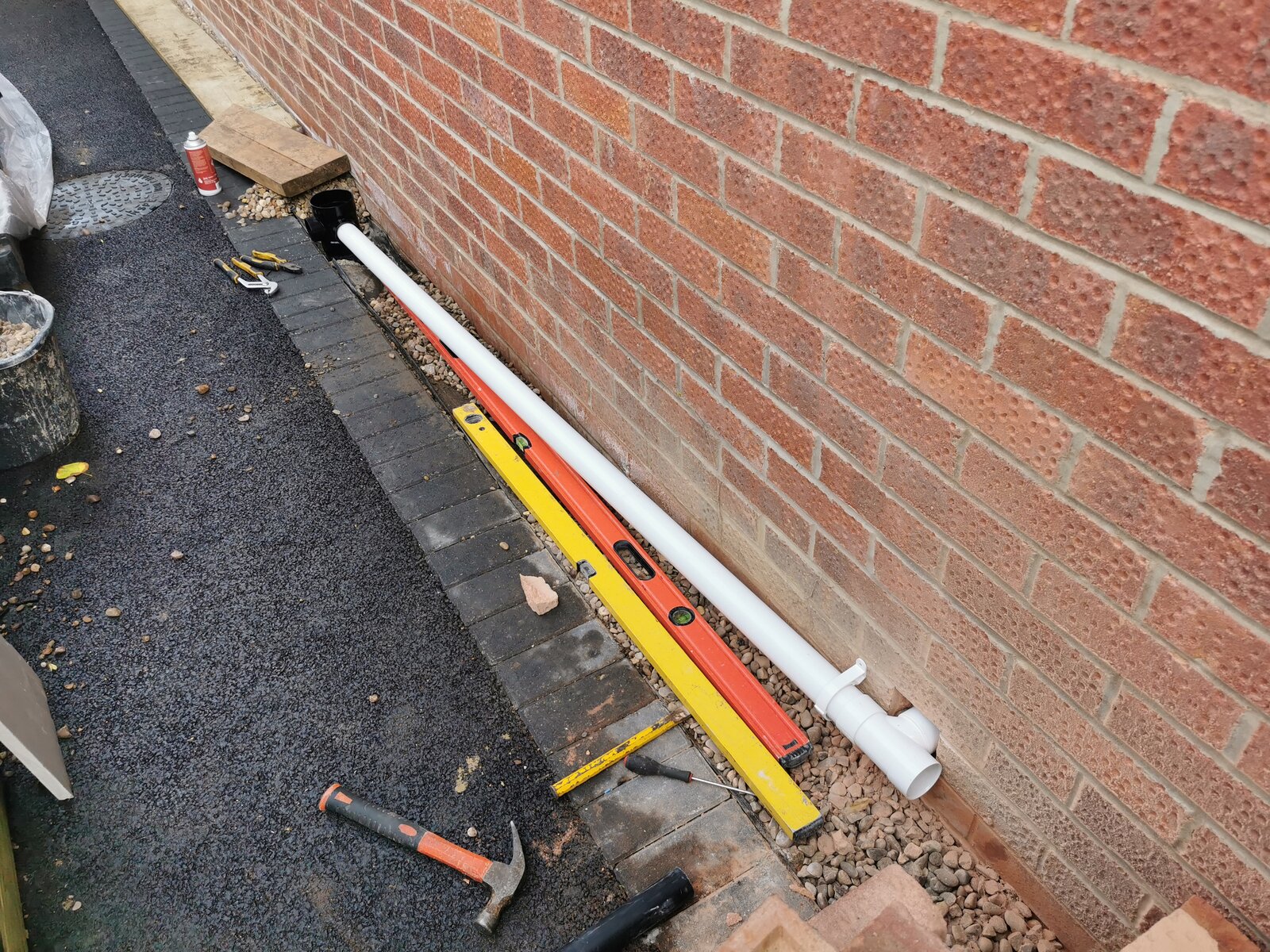

I just need to get that 40mm waste and the 40mm waste from utility upto 50mm so I can run a 50mm along the wall.

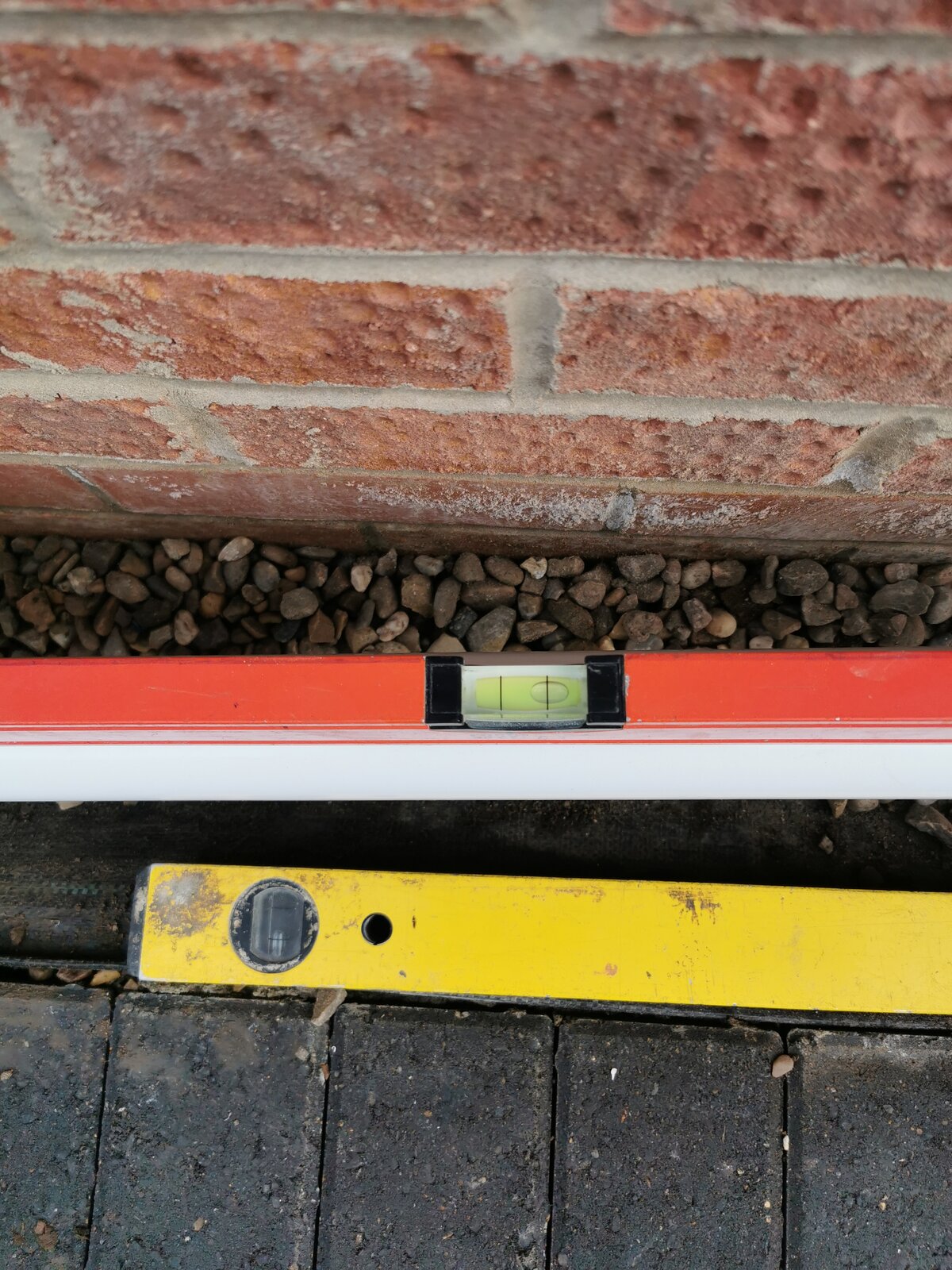

I think we're there, cut a section of brick out to allow the 50mm tee to fit close enough to get a pipe bracket fitted. Used a 50mm to 40mm reducer that fits inside the tee so that it doesn't interfere with lengths.
Got plenty of fall, possibly too much for the washing machine but it's fully accessible for rodding so hopefully should be an issue.
