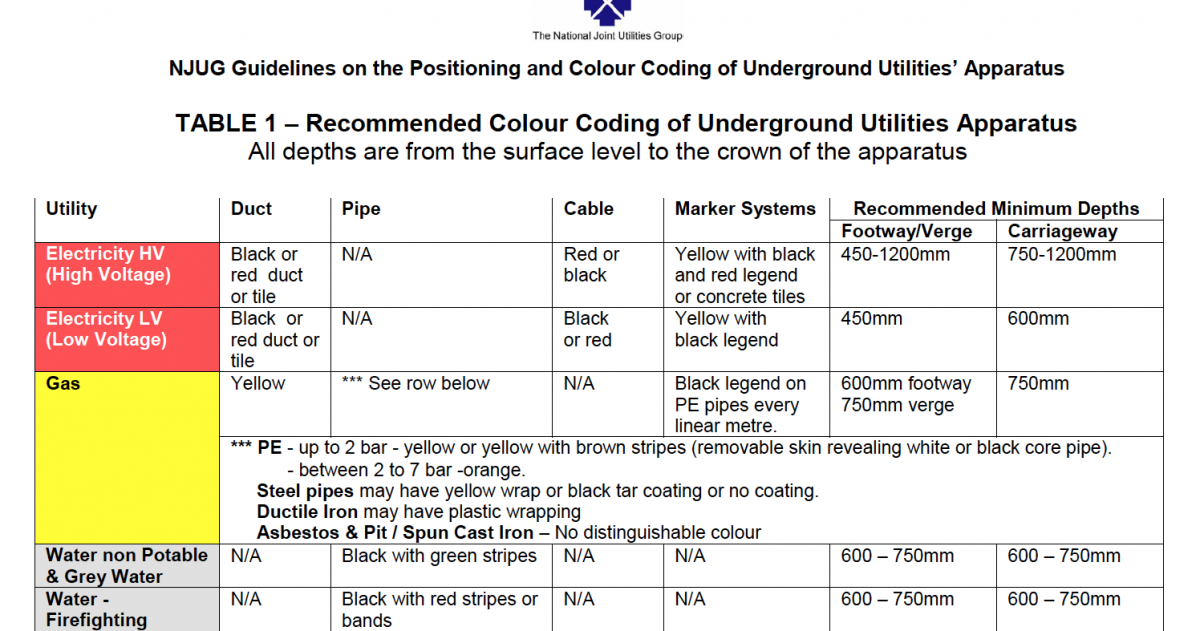

No, 1 metre.
Show me the regulation that says 1 metre
We are talking a domestic installation, in his own garden. There is NO repeat NO regulation regarding the depth of buries SWA cables in this situation.
I'll show you a regulation regarding this. But that is from NJUG (National Joint utilities Group). They specify the requirements of utility services in PUBLIC streets.
Here's a the relavent bit
So, where do YOU get your 1metre figure from. I don't think the OP is talking about an HV supply (don't forget the definition, now.....)
Unless I need another visit to Specsavers, the requirement for LV in the STREET is 450mm. In a garden its down to a risk assesment, but I guess he isn't going to run a plough or a seed drill across his lawn.
So. I am happy with my position on 450mm.
I await, with interest, your reply together with a copy of the regulation that states 1metre......................
Useful and ta. I was only going from what the electrician who did design and install for my garage power told me- I'd searched around and found various different depths and requirements, he wanted it a metre deep, he was responsible for signing it off so I buried it a metre deep to his specification. Good excuse for a mini digger for the day :)
