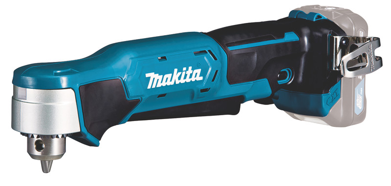

Or should I look at a dedicated right angled drill unit? Makita do a cordless one and I have some of their cordless tools.

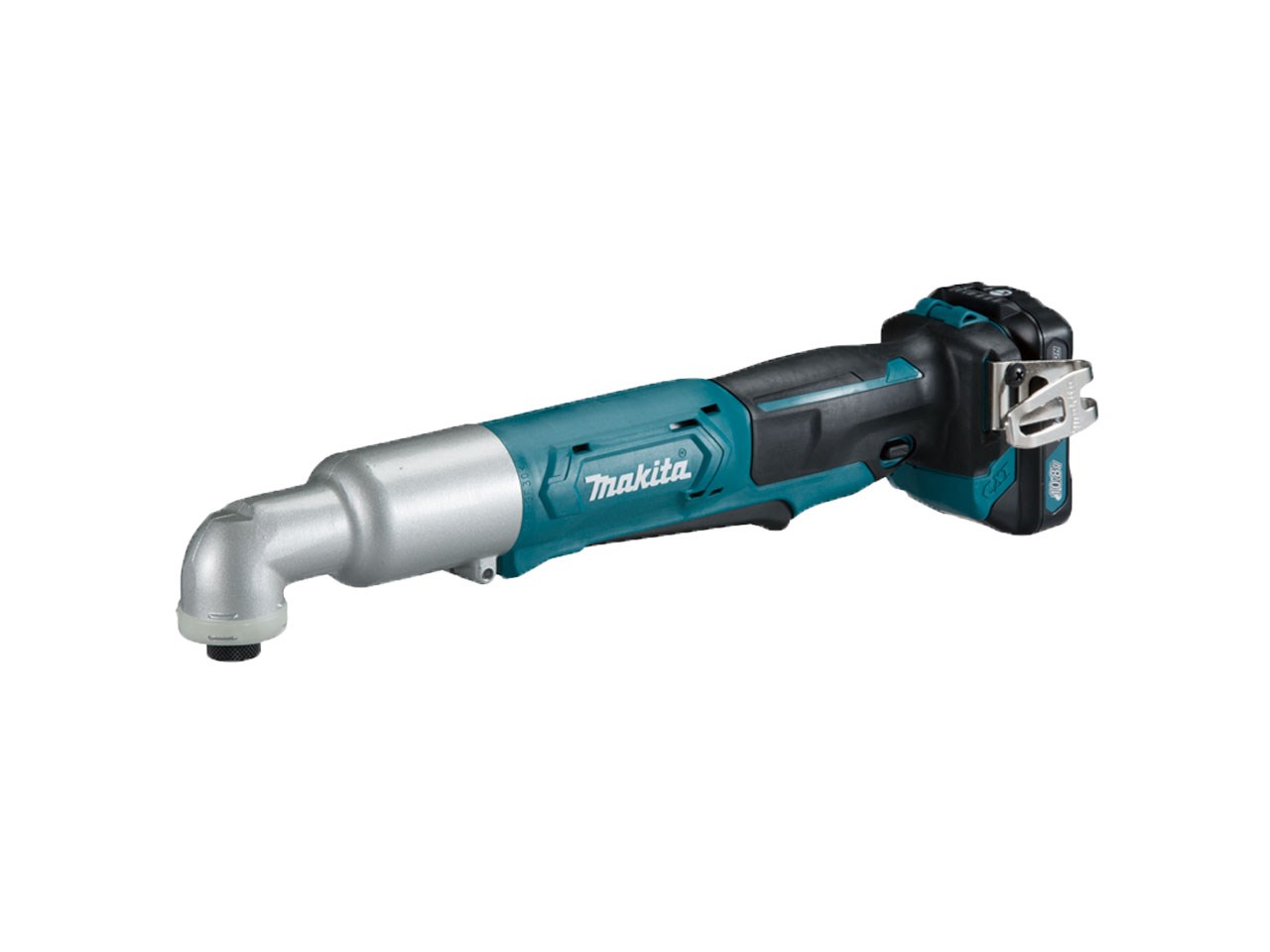

I've got a Makita CXT Right angle driver which I like. It's about 60nm so plenty enough for driving beefy screws. I use it to get into tight spaces to do up or break M8 bolts. Depends on how much of this work you do to justify buying the proper tool I suppose.
They're doing a CXT right angle drill, ordered one from Germany just after Christmas but it's got lost in the post so I'm not sure how that is but currently it's only out there and in Hong Kong I believe.

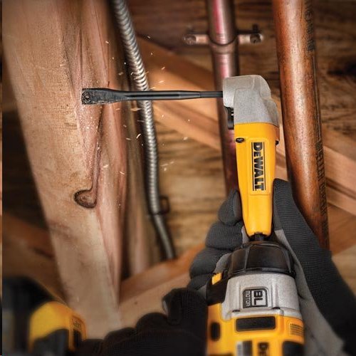

As for attachments, I've always preferred dedicated tools but I know a lot of people who recommended the dewalt attachment. They're quite tricky to get hold of here mind so it might be a case of ordering one from the states. DWARA100 is the item number. There are variants of this online but I couldn't comment on reliability.

I'd rather try to avoid bodging something if I can. Sometimes, it's inevitable. In this case, there are alternatives. The Dewalt angled chuck for £26 might be enough where I don't need a right angled drill (the Makita one is about £160).
