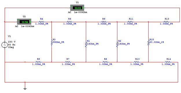

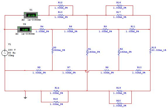

I could not find a 0.5 ohm resistor in my electronics work bench so used two 1 ohm in parallel the top shows a figure of 8 the bottom a standard ring loads are the same the ammeters show the load on each leg. The point is with a single ring the cable resistance is more even spread if we assume 60 meters of cable 40 in original and 20 in the figure of 8 with the figure of 8 being 10 meters from the start/finish then the load on that 10 meters will be much more than if at the 10 meter point the cable was split and ring inserted as the sockets would have some of that extra 20 meters of cable before load is taken.

... the top shows a figure of 8 the bottom a standard ring loads are the same the ammeters show the load on each leg.
I am having some difficulty in seeing in what sense the top diagram constitutes a 'figure-of-eight circuit. One thing I'm not sure of is whether or not the top of R1 is joined to the junction of R6 and R9.
To illustrate the point I was making, you could try the following ... start with a standard ring with loads applied near one end so as to somewhat 'overload' the cable of the short leg. Now add a cross-connection between two of the sockets (in theory any two sockets, but the illustration will be clearer if you chose ones quite a distance apart on the ring), turning it into a figure-of-8 - and you will hopefully see that the degree of 'overloading' diminishes or disappears.

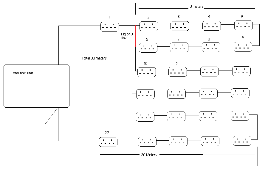

Taking the example shown one would expect the impedance to be about 0.45Ω total each 10 meter section around 0.056Ω we will assume all sockets loaded equal at around 270 watt each. And the fig of 8 link zero ohms.
With the link in or out the balance point will still be the link between sockets 18 ~ 19 but with link in the cable resistance at the top will be 0.11 Ω and bottom 0.25Ω so with link in we have 21.3 amp top and 10.6 amp bottom and without the link 16 amp both top and bottom.
So even with even loaded sockets the figure of 8 can produce an overload.
With the link in or out the balance point will still be the link between sockets 18 ~ 19 ...
Am I missing something. Your socket number is a bit confusing (11 is missing and the 26th one is labelled 27) - but don't you mean between sockets 13 & 14 (assuming that "12" was re-numberd "11")? If so, your arithmetic obviously would change considerably, with far less difference with/without the "fig-of-8 link'.
Even forgetting the above, what you are seeing is surely mainly the consequence of connecting your second loop very close to (12.5% of the circuit length from) one end of the ring? A more realistic/sensible 'fig-of-8' would connect, say, sockets 10 and 17 (the left-hand ones in the third and fourth rows).

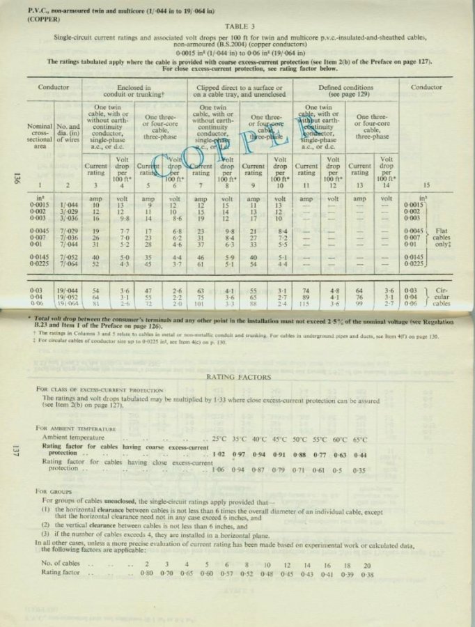

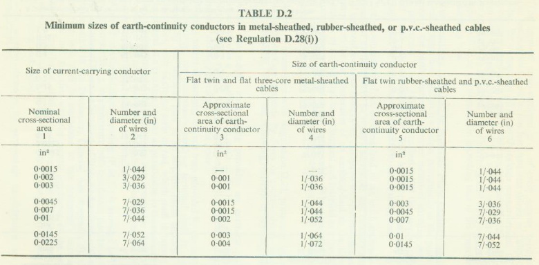

Here are the cable makeups:
And the current ratings:
Both of the above are from the 14th edition IEE Wiring Regs., 1966.
