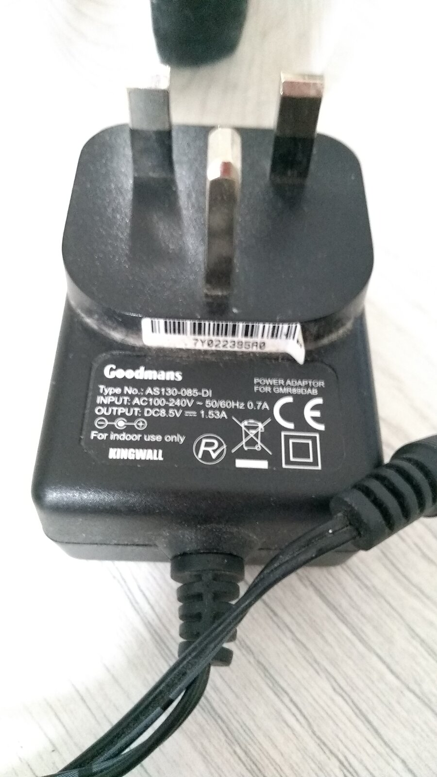

Need a new adapter for a DAB radio the one I am replacing is 8.5V 1.53A but confused as it can also run off 4 AA battery's which equal 6V so can I buy any adapter from 6V to 8.5V

Make and model of DAB radio?
Make and model off the (faulty) existing adapter? (A photo could help).
No guarantees, but that would probably work just fine - it certainly would not cause any harm. Better/ more likely to work, would be one with a higher current rating.

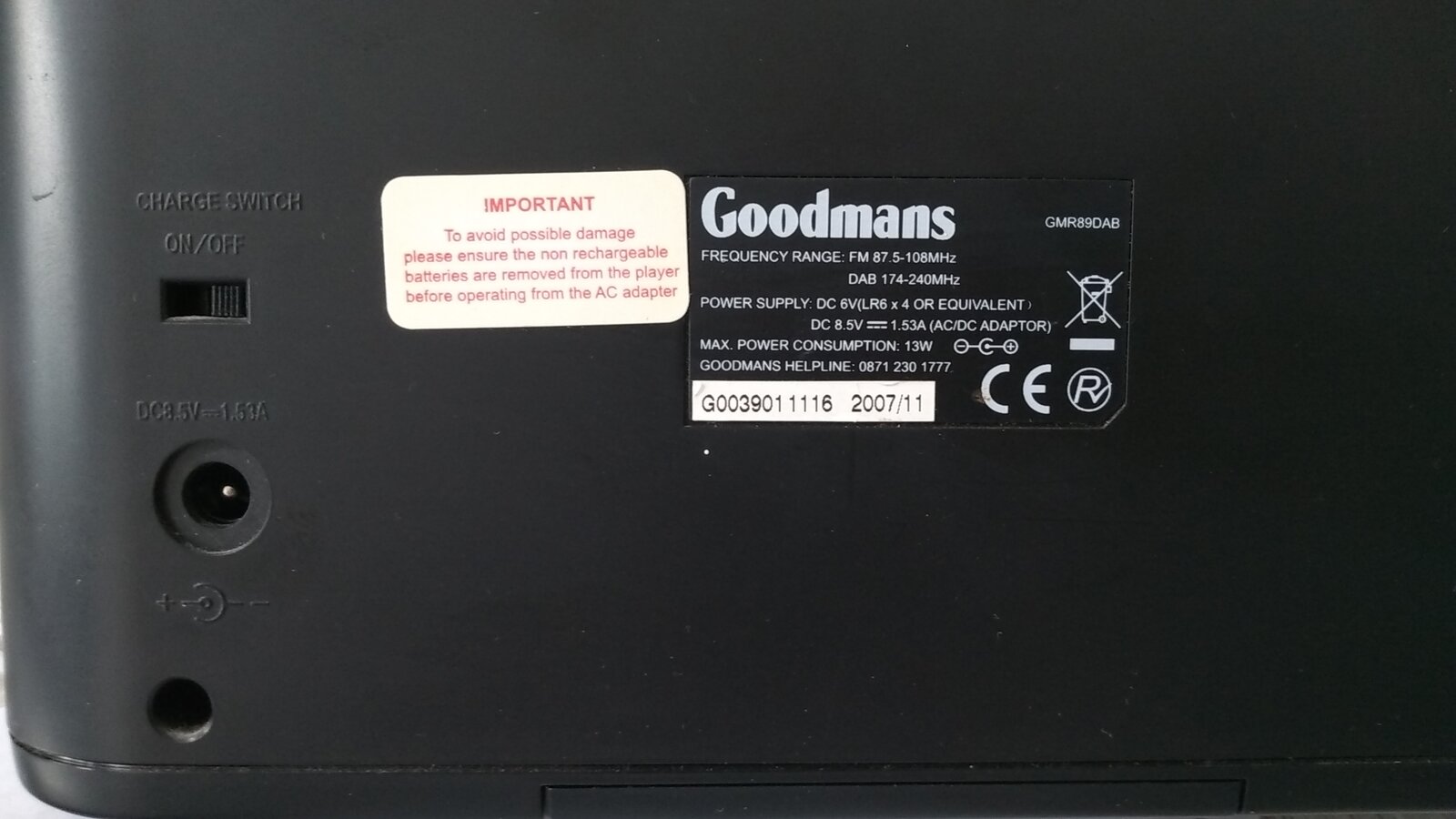

Thanks everyone its a goodman's GMR86DAB and yes looking properly at the back it does have an option to use rechargeable battery and leave them it to charge - so is that why the adapter is 8.5V.
I don't use the facility so just an AC adapter to run the radio without charging would do.
Also I was assuming it was the adapter causing an issue which is when I turn it on the screen flickers for up to 1 min before the radio switches on and then sometimes randomly does it again while it is on. But if I just use it with normal AA's then it works fine.
.... its a goodman's GMR86DAB and yes looking properly at the back it does have an option to use rechargeable battery and leave them it to charge - so is that why the adapter is 8.5V.
Yes, vey probably - to charge 6V worth of batteries needs more than 6V.
It sounds as if you don't use batteries at all but, if you did, you would need to heed the (red) 'Warning' on the back. If you connected the AC adapter whilst there were non-rechargeable batteries in it, it would attempt to charge those batteries which, in the worst-case scenario, might cause them to 'blow up'.
In practical terms, if there are no batteries in it, I imagine that a 6V adapter would work fine for you.

Yes I have a multimeter but where would I measure from when it its plugged and running the radio in as I can not access the barrel plug.

Good question. I would imagine that you could probably measure where the internal batteries would (if present) be - measuring between the two 'ends' of the string of four batteries.

I can not get anything across the battery springs - charge switch was on
