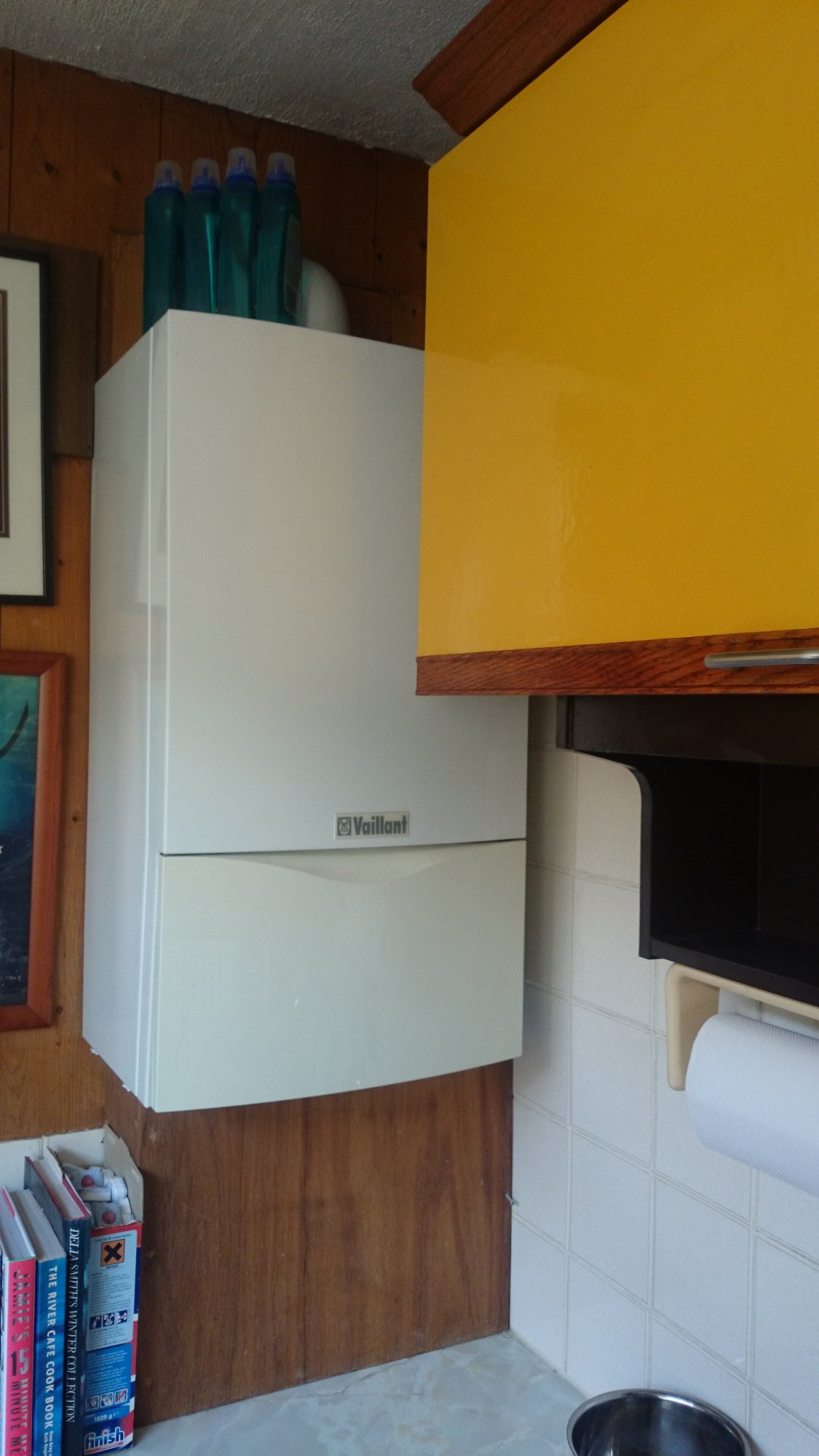

I've got a Vaillant boiler which was installed 13 years ago. The installation instructions state that there should be a 50cm clearance in front of it. However it has been installed facing a cupboard only 10cm away. This faces the right hand half of the boiler - the left hand side is clear. There is a wall to the right. Because of this limited clearance it is impossible to remove the cover, although it can be lifted up to the ceiling so that most of the front of the boiler is exposed.

A photo of your installation would no doubt help to clarify things, but ultimately if the case can't be removed the boiler can't be properly serviced. Dean's analogy is a good one - you wouldn't expect a garage to do a proper service on your car if they couldn't open the bonnet properly. This is exactly the same situation
Here you go. PGS are registered with Gas Safe so they must have found a way to get satisfied about the access. Perhaps I'd better call them in again.

Technically the last chap was correct, but he must have been having a bad day. I think most of us could service that easily enough.
We don't know what model it is but at that age probably a Turbomax.
It would probably be possible to do some service tasks but replacing the fan might be hard.
The simple fact is that the makers specify certain clearances and engineers expect them to be maintained.
