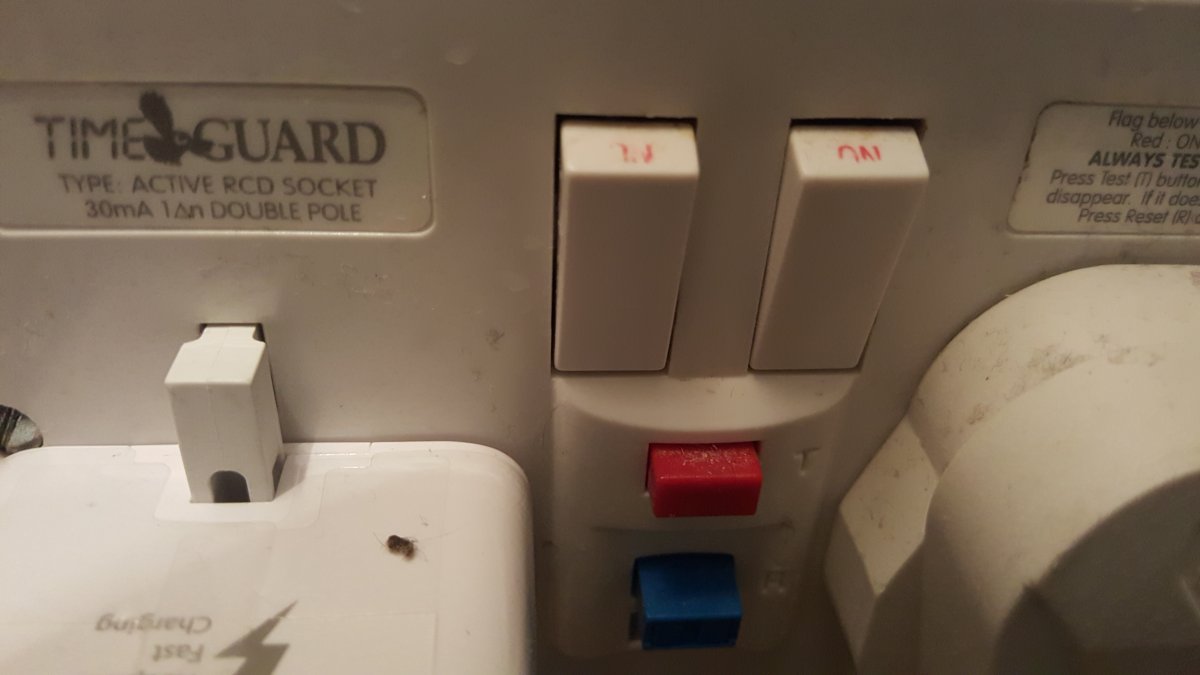

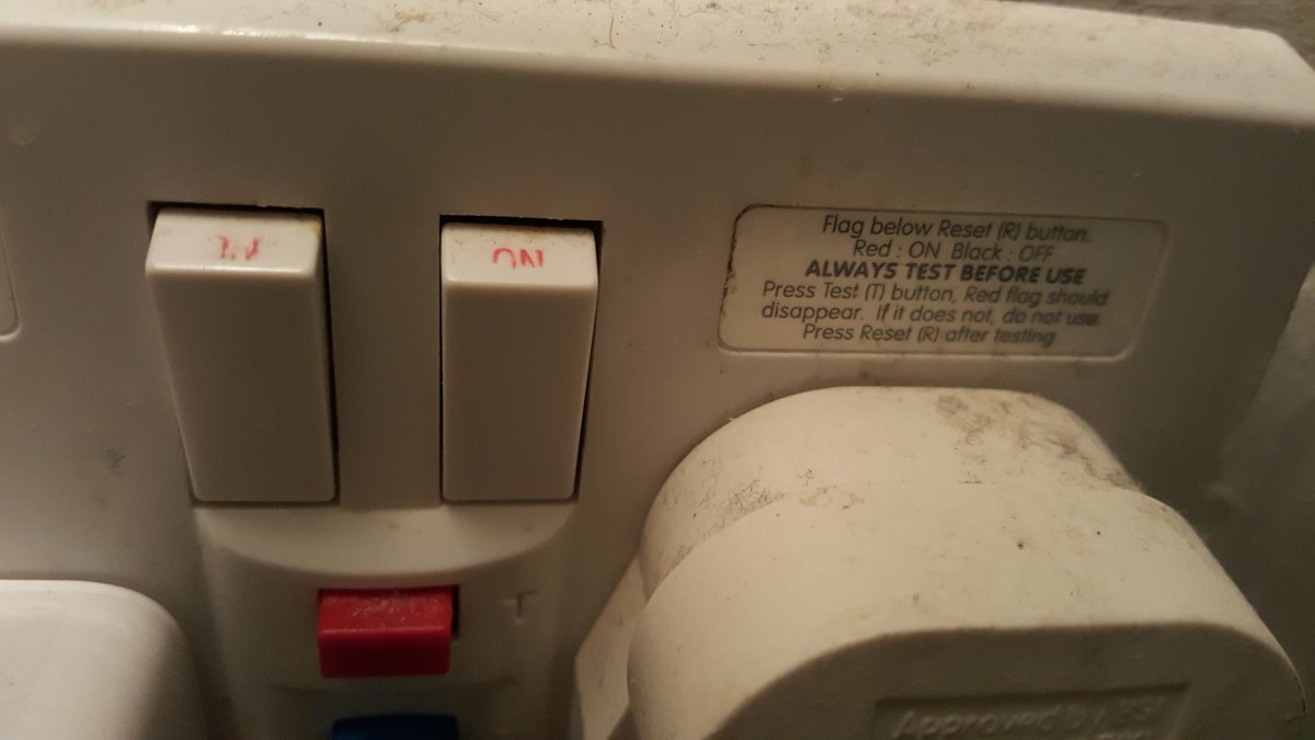

Hi all,
Ive got a plugpoint that can take two plugs, currently not working . Reading the description on the plugpoint, it reads "active rcd socket 30ma 1n double pole."
It also has a red (T) and blue (R) buttons as shown in the pics.
I normally have my washing machine plugged in, but its not turning on. Tried my phone charger and that also does not work when plugged in. It works for a second when i press the blue button and i can hear a buzzing noise in that same second.
Has anyone experienced anything similar?

If you unplug the washing machine , does your phone charger then work? The socket looks a bit mucky, has any liquid got into it?
Hi, does it reset when the the appliances are unplugged ?
DS
Nope. I tried unplugging all and just charger but nothing.
When i unplug the appliance a whirring noise can still be heard in the plug. Even when power switch turned off.
