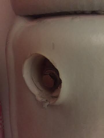

However it has two bolted holes that I presume the immersion rod can be installed ? One on the left and one on the right (although I presume the one on the left is easier to install it as there is more space).

Those connections are not for an immerser, they are just spare tappings for other things. They are too small.
thanks for that, the tank is a flowmax range, so if thats the case , there no other way to do this then apart from changing a tank ? :eek:

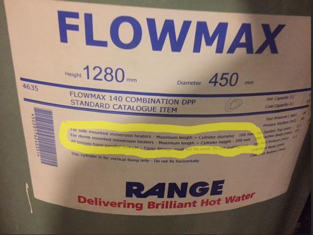

A)Looking on the cylinder it says "for side mounted immersion heaters=maximum length cylinder diameter - 100mm.
see pic:
Does that mean that they were not spare tappings and that an immersion element can be added on those connectors?
b)
In case that it can be added indeed, I still wonder if this is beneficial to install based on John D's response, bearing in mind the cost of the iboost+new circuit+ heating element and install.

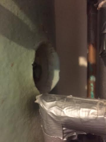

Don't you have a large blanking plug near the bottom of your cylinder?
