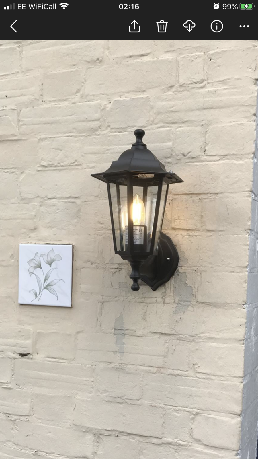

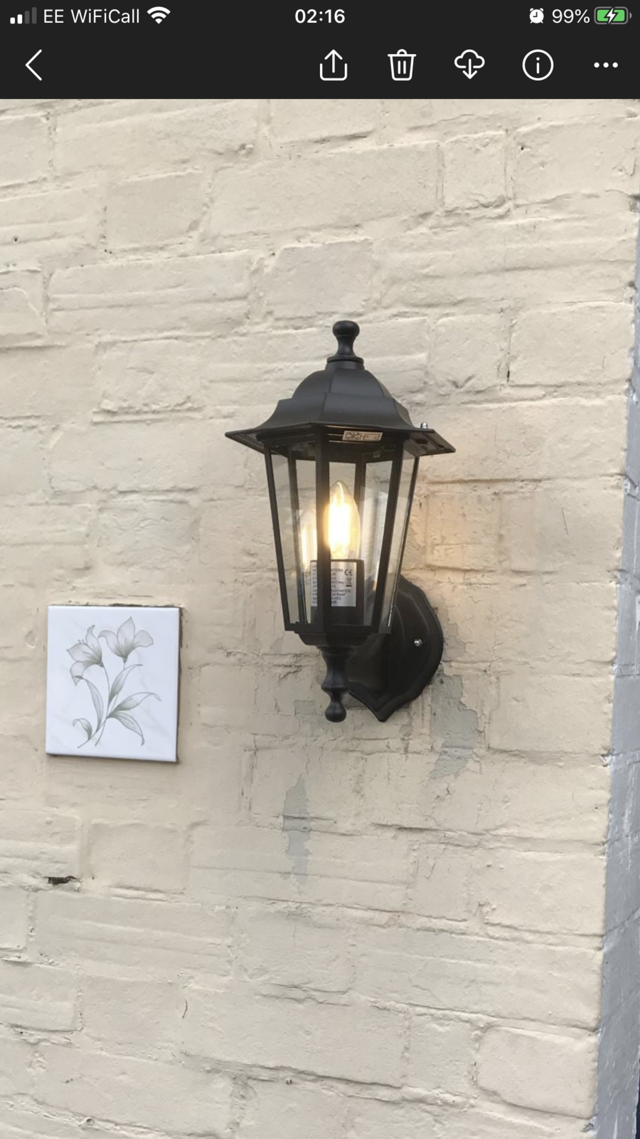

UPDATE: I used the plug method in the end.
Thanks for your help
