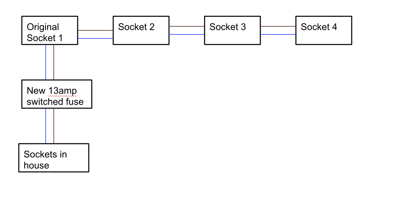

Hi All,
Im new here and am ok at DIY in general but i dont know what legal/safe/reccommended when it comes to adding new sockets.
I recently added some new sockets in my garage. in the garage there is an existing double socket, this is coming as a spur from one of the house sockets. What I have done is added 3 more sockets off of that and added a 13amp switched fused before the original spurred socket. Is this legal and more importantly for me, is it safe?
please see diagram attached
Cheers for any answers
Ste

Yes, all good; you have done it as per the regulations.
You will, of course, be limited to the 13A of the fuse.

Maybe not - but he can tell them why the fuse has blown.
True but, as you said, it is 'recommended' that one does not connect a load >13A to what is effectively a "13A circuit" - but, by the time a fuse blows, they would presumably already have loaded the circuit to 20A+ (since they were until then unaware of the recommendation).
It was just an observation on my part about the limited usefulness of the advice we always give (and probably will continue to give) - since there's not really anything which can be done about the issue I have mentioned.
Similar is, of course, true of a 20A radial supplying umpteen socket outlets (which is one reason why I'm personally no great fan of 20A radials). Again, there's nothing one can really do about it.
Kind Regards, John

As a side question, is there a limit of sockets or distance I can do this over? I think I read as long as it's not more than 50m extension?
Thanks both for your quick responses! I do understand what you're saying about the load and am generally the only one in that space plugging stuff in but it's good to note for other family members just incase I guess.
You're welcome. As I'm sure you also understand, although plugging in more that a total of 13A is 'not recommended'[, the worst that would happen would be that the fuse in the FCU would blow, but no harm would come to anything.
There's no limit to the number of sockets. If the cable length got too long, you might run into problems of voltage drop, but that's not likely to be an issue for you in practice (unless your 'garage' is actually an aircraft hanger :) )..
