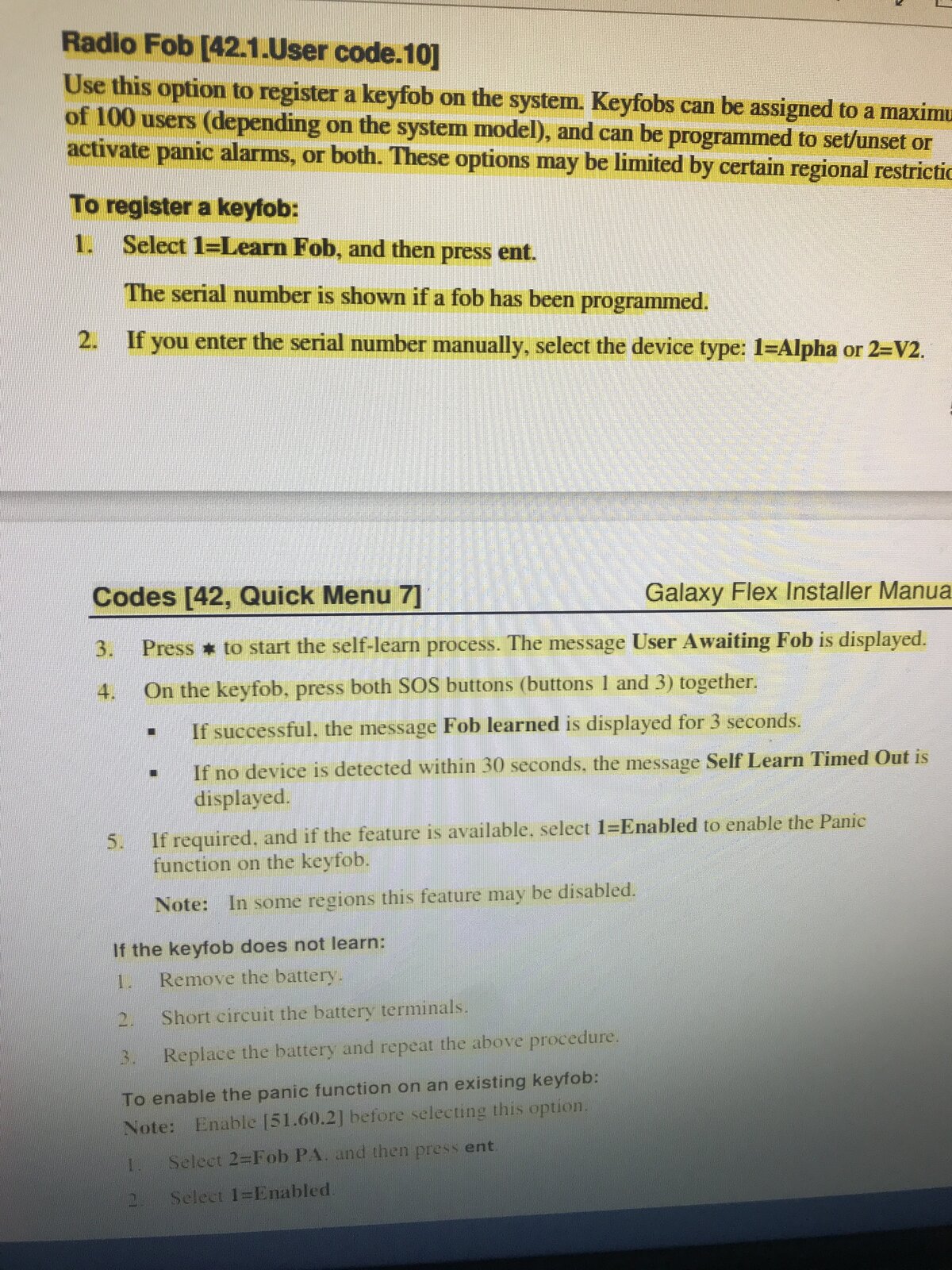

looking for some advice I am trying to get a TCPA2B PA fob to work with me honeywell flex 50 alarm
I have successfully added the fob to a user and also enabled the remote PA fob setting
however when I activate the PA fob the lights flash on the fob but nothing on the alarm
anything I have missed or other settings need changed?
Are you sure the fob isn't creating a silent pa?
What happens after your test, when you enter your code? Does it show a PA reset in the log?
If you want the fob to generate an audible PA, you will need to set a panel input to N/C zone as PA, then link a silent PA output to it.
No don’t see any silent pa on the system log and I can login as installer and get no pa messages for reset. It’s like the alarm isn’t getting the message. I have another RF fob for setting and insetting and that’s working fine.
I have followed the install steps in the manual unless I have missed something.
you think it’s because I haven’t linked to a zone?

I have managed to get a silent PA by resetting the fob and adding it back on the system.
could you please give me a little more information on how to get a audible PA am still learning my way around the flex
