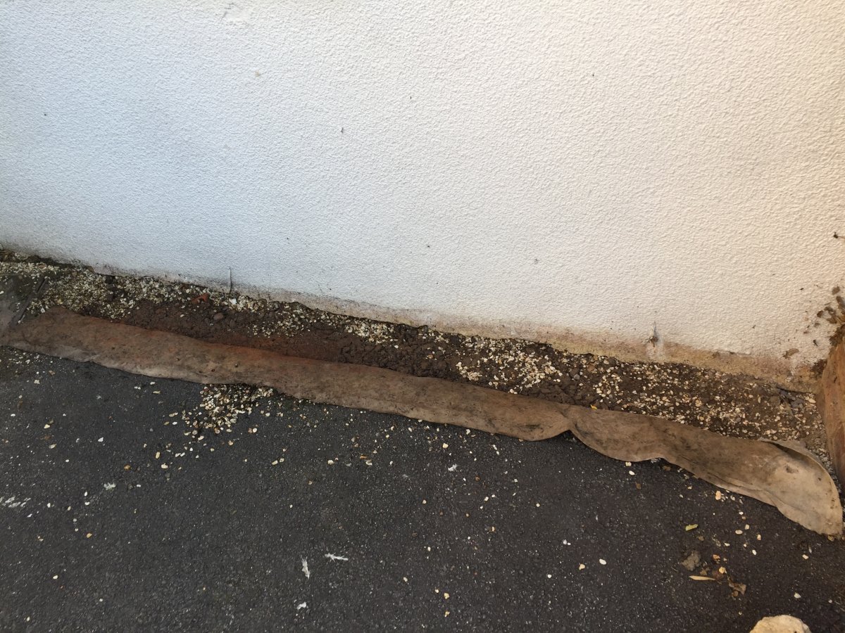

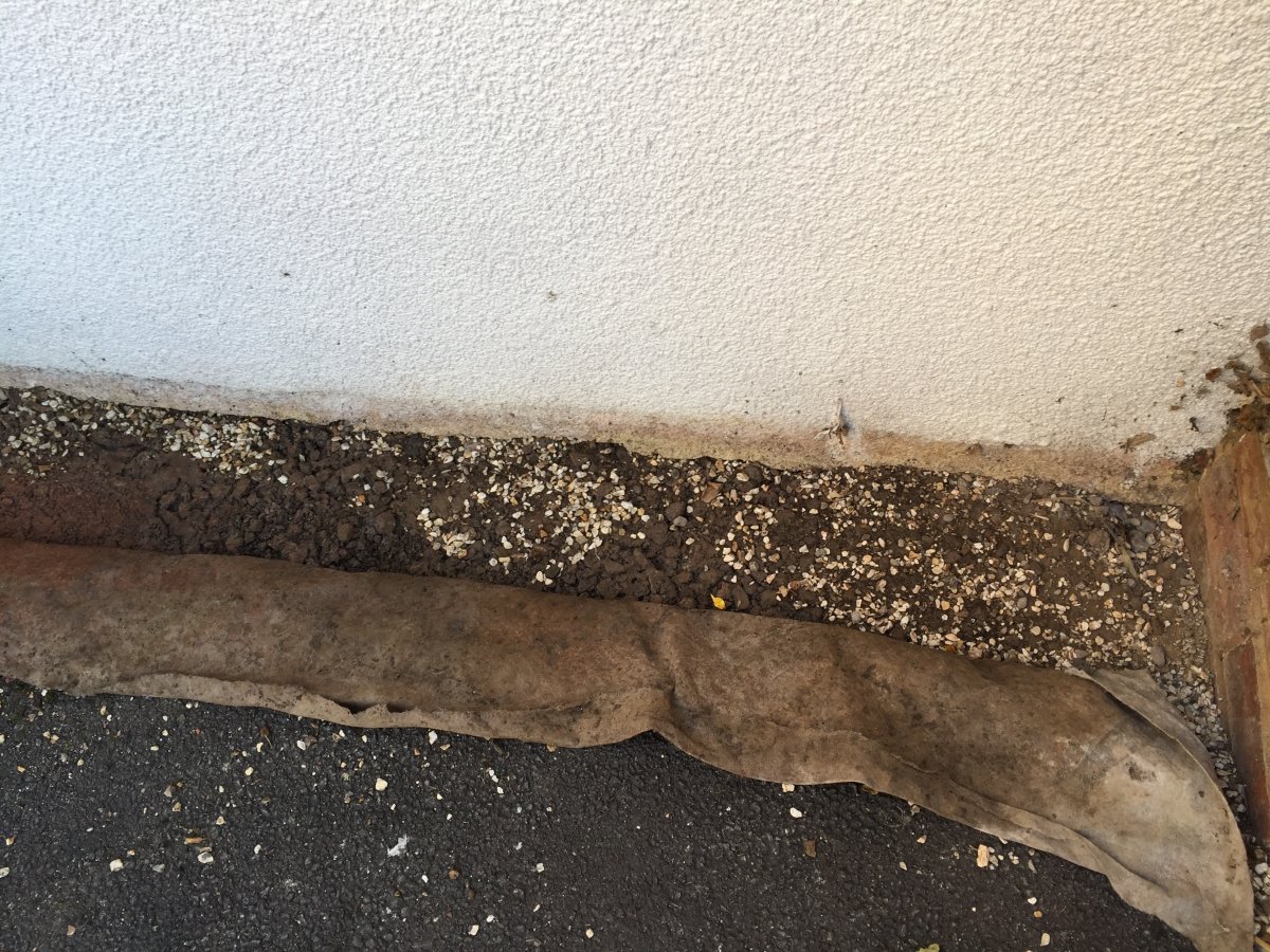

I went to the flat today and removed the gravel on the so called "soakaway" , revealing only 2" of gravel then hard compacted mud and stones. Not a soakaway at all or a path for running water. with the wall to the left of the image it is like a swimming pool with nowhere to go. No wonder it comes through the bl**dy wall !

I think not having the runaway breaches H3 of the building regs. Who agrees? Thanks
I also think that water is working its way through the building via the footplate channel used in the partition wall but again, hard to prove and how do I go about fixing or getting them to fix it ! thanks again

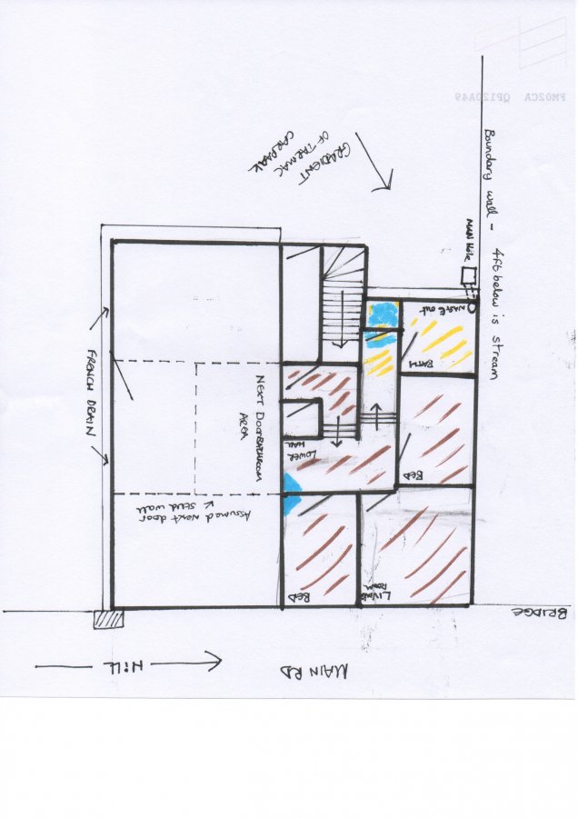

SO below is a picture as requested, overall gradient is from left to right, and top to bottom so basically all towards the bottom right corner.
The french drain around the building is functional however I fear maybe the source of the water that arrives in our lower hallway.
The drainage at the back of our flat , by the bathroom, really is a pooling area and the floor level equals that in the cupboard where the blue area is highlighted. The other blue area in the lower hall is where it pools, which i believe is coming along the foot plate of the partition coming from next door.
The lower hallway is funnily enough , lower than the ground level and thinking about it is the lowest point in the building. (lightbulb moment maybe).
Everything brown is suspended over a dry cellar, everything yellow is a concrete slab that is at the level of the soakaway and is the site of the pooling in the upper hallway area.

Thank you for the sketch.
From what I can make out you have two separate damp areas with no obvious connection between them.
I suspect that the property was built in stages over many years.
The French drain stops short of going fully round the car park side so I assume its draining back towards the main rd?
The short length of French drain that presumably goes into the soakaway is higher than the inside slab? Where does the soakaway run to?
Then there's the matter of the cellar backing on to a stream - am I right?
What is the "footplate channel in the partition wall"? What do you mean?
Presumably the damp in the bathroom is from your plumbing or tiling arrangements - or the neighbour's penetrating the party wall?
HI thanks for your help again ,
to clarify
Footplate is what I know to be the baseplate of the stud framework, in this case it is metal channel C section partition fixed to the floor with the C section facing up to form a U shape. An ideal channel I feel for water that may enter anywhere (next door flat maybe ), running down until it meets a stopping point. This point would logically be where the 4x2 door frame sits in the vertical C channel and the bottom of it collecting the water and it pooling around the door frame in the lower hallway and guest bedroom.
There is no damp in the bathroom and the tiling, bathroom work has been investigated and found to be bone dry even under the boxing in by the toilet. The upper hallway cupboard is the affected area, and this has a concrete floor that is exactly level with the "soakaway" outside in the car park.
The soakaway is a shallow channel that goes right to left towards the stream. It has nowhere to go because the boundary wall is in the way. I would like a channel gutter to be fed in to the spare inlet on the drain cover that can be seen servicing our toilet and the vertical rain water drainpipe form the roof. But currently, it goes nowhere !!
The stream is 4ft below us and has never been anywhere near us. It really is not a concern for us in this instance.
Next door has reported no damp or water ingress at all, we checked when it first happened and she has not had any leaks or any problems to be fair.
The property dates to 1912 and the bathroom area in our flat has been added at a later point however we do not know when.
