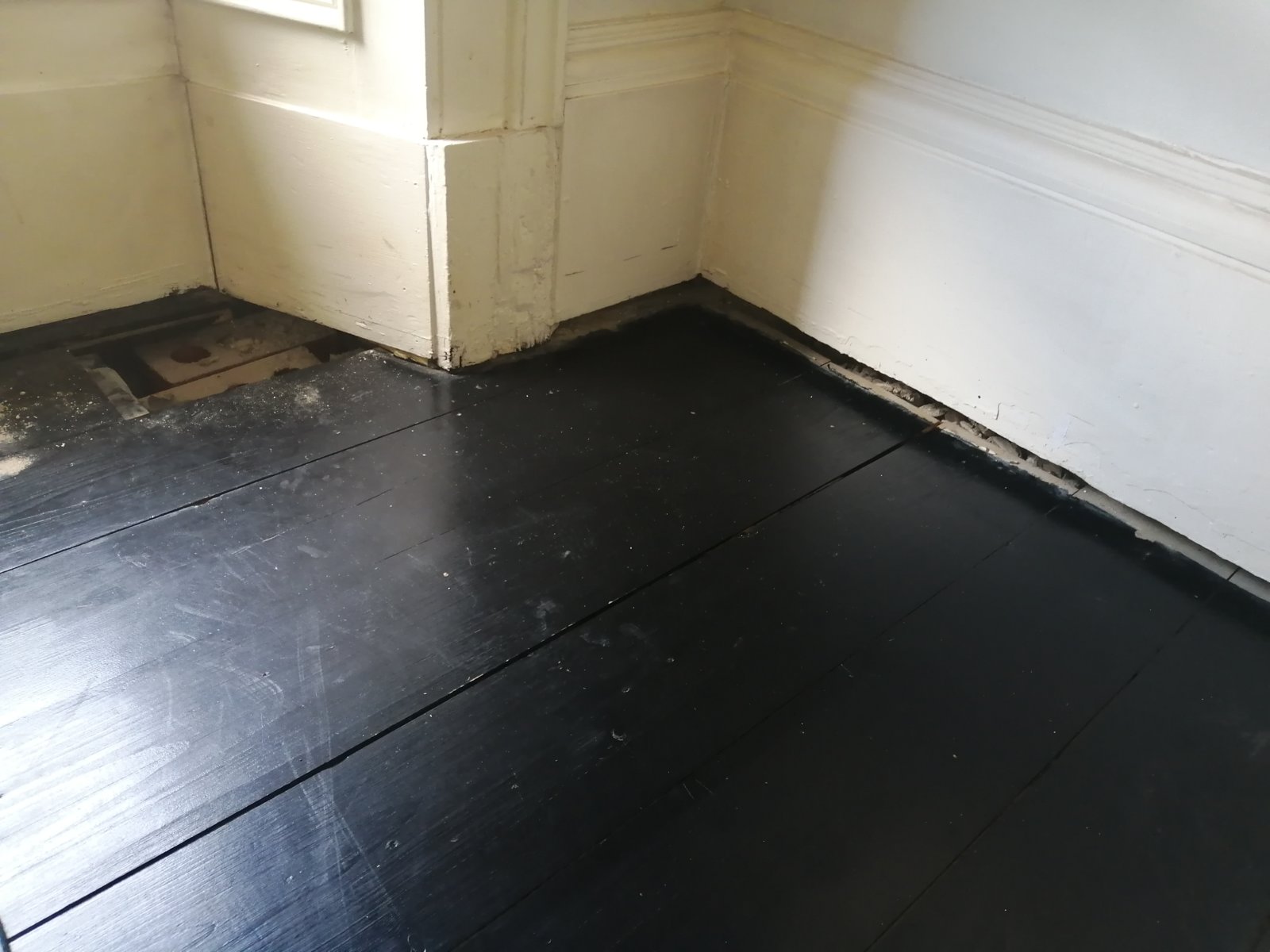

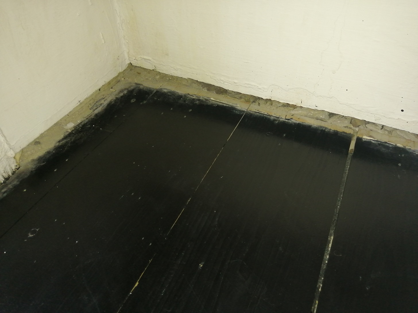

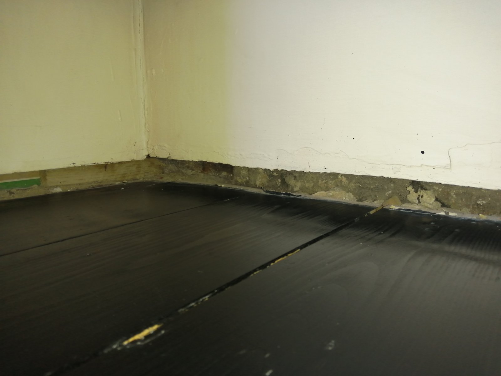

We were away for 12 weeks. When I get home, I clocked the skirting board at the corner of the living room has opened up (There was always a small space at that section due to a bressumer beam replacement 15 years ago prior to us moving in) The gap is nearly 2 inches at the widest point and stretches for over a meter and a half, then it begins to close up. At the window the skirting is fine, but again, a gap has opened up and I can see into the floor. The window is about two feet away from the skirting that has lifted (The area that shares the party wall with next door) This only seems to be happening in one section of the room. Neighbor upstairs commented last year that he could see the building next door pushing forward, but I assumed the Factor was s investigating the movement next door so wasn't too worried.
I just need to ask, how worried should i be at this stage? I called the building control helpline number who said no one has ever been asked to come out and see the building, and that the engineers in 2017 would have contacted them immediately if they thought it was dangerous. They have still to call me back, and to be honest, this might not be a big concern to them. What may worry and concern me may not be a huge deal to someone who is a structural engineer and actually knows what they are looking at. I have been measuring the gaps for 4 weeks and they haven't got any worse. Is this something that can wait until I can force a survey/repair on the neighbors, or should i ask building control to come out and take a look at it? Could something like this cause a floor or ceiling to collapse? And is this definitely related to the movement next door, or can anything else cause this kind of damage? (As you can tell, I don't have a clue about these kind of things. Sorry for asking so many questions)

why not lift the final board in pic 3 and post a pic of whats below?

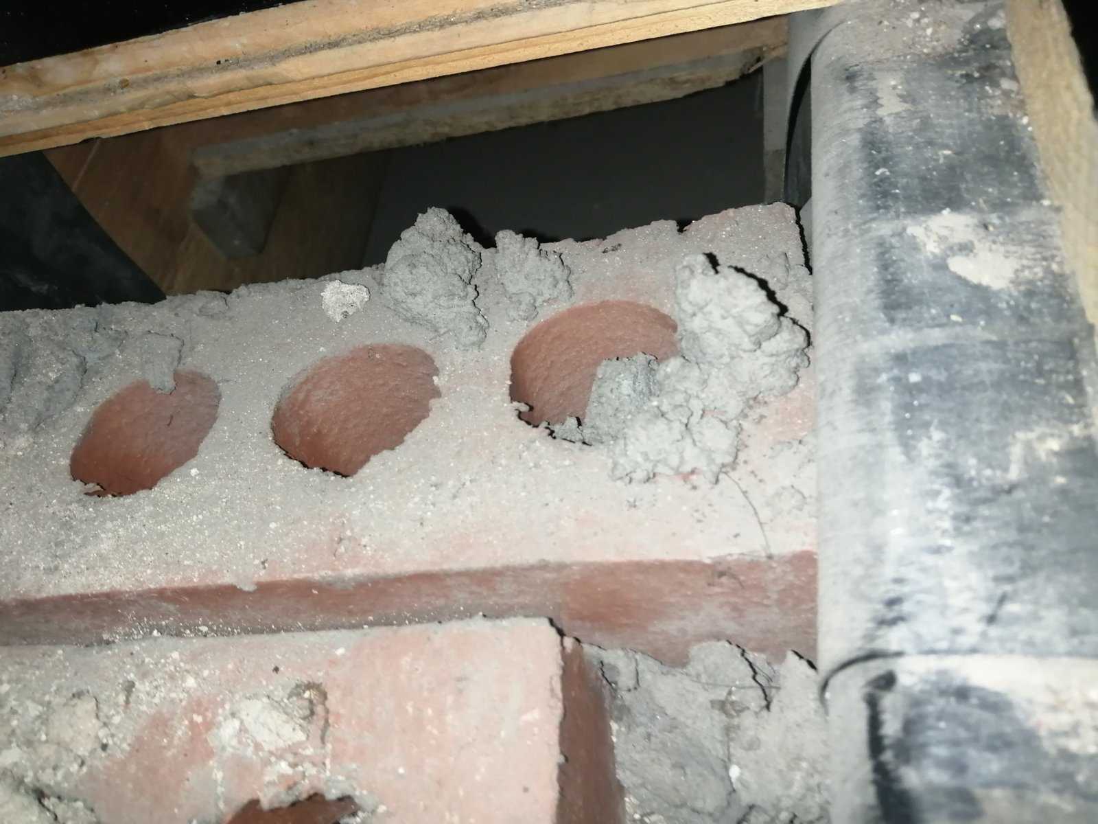

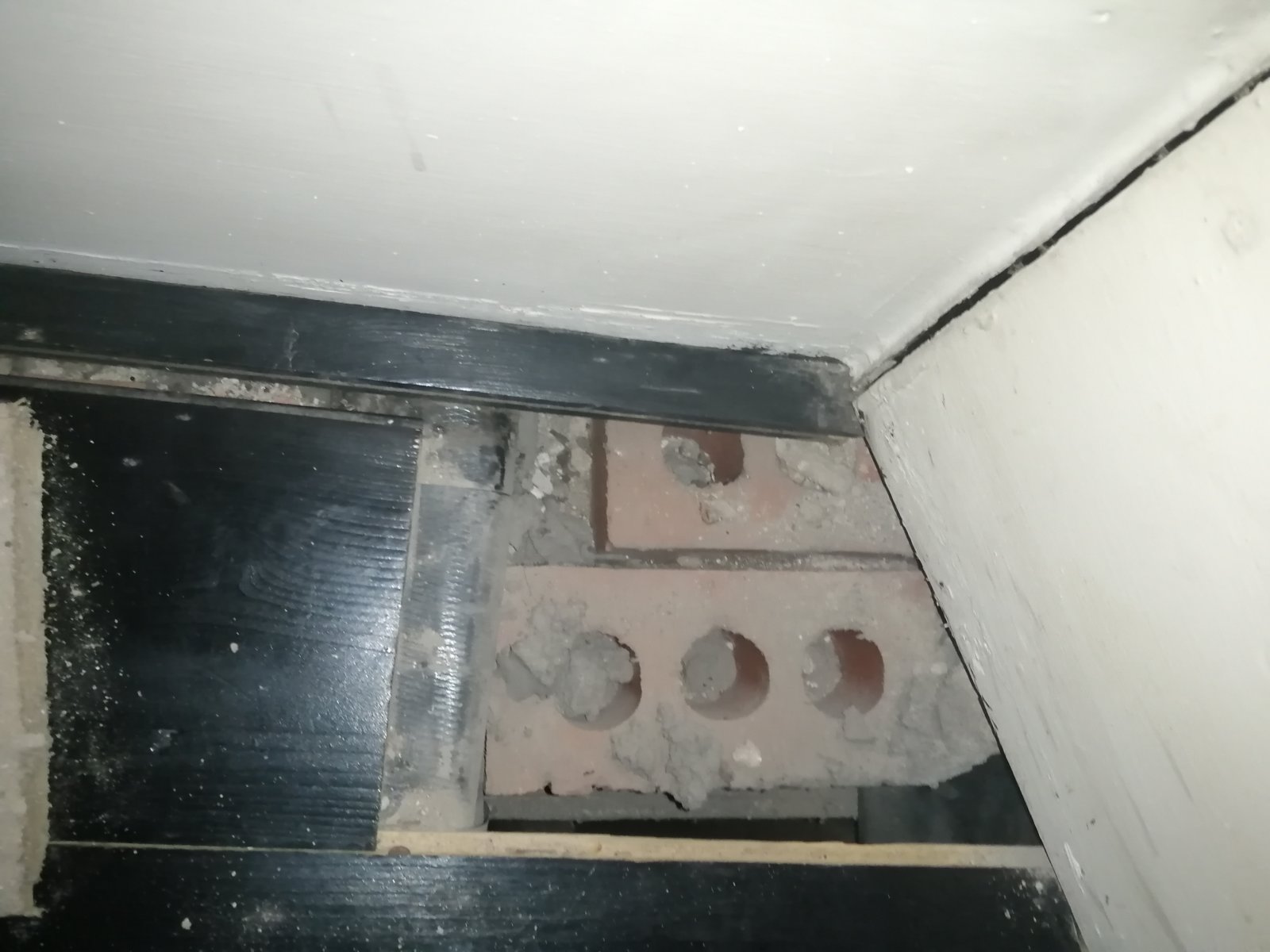

Took me bloody ages to find a screwdriver. Couldn't remove the middle board due to my crap tools, but managed to move the corner one (n)
I found, er, bricks....Don't know what i was expecting tbh.

from the little i can see and understand you will need to lift far more of the boards in readiness for any further investigations - dont go lifting anymore tonight or you could be creating a dangerous trap in the floor. what i can see is well wrong and needs attention from someone on site.

the bricks under the boards were probably to provide a little support where there was no joist to fix the boards to.
how the bricks relate to anything else i dont know, although its possible that they have no connection to any larger structural movements?

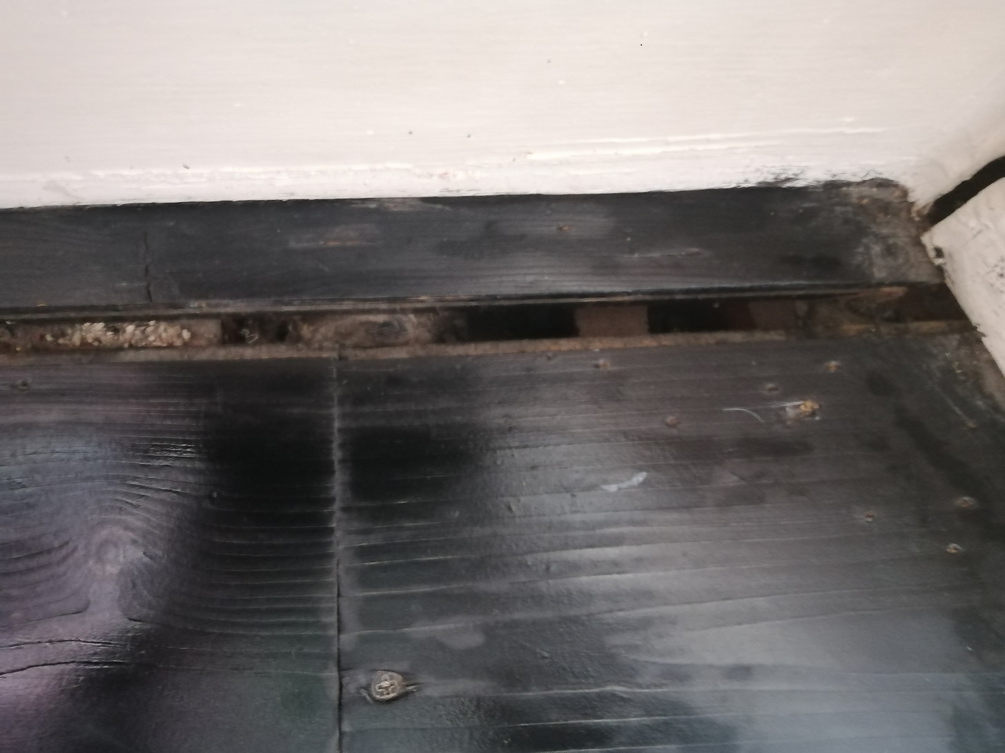

I left the floorboard lifted and took a picture of below the window and the corner where the crack is.
Oh, forgot to mention the flat was built in the 1890's.

What I meant was better context as to house construction, where in the house this crack is, what walls and rooms are adjacent to it, what's above/below, what's outside - trees/drains, window and door locations.
