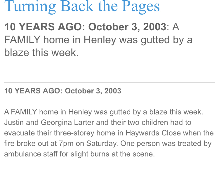

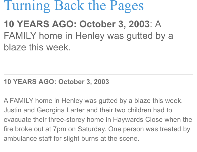

Only one tested in action. Customer with integrated garage that caught on fire. The house was totalled and had to be rebuilt. but they all got out.
