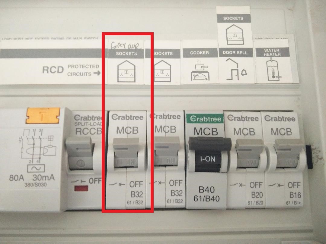

House consumer unit with garage connection highlighted in red :

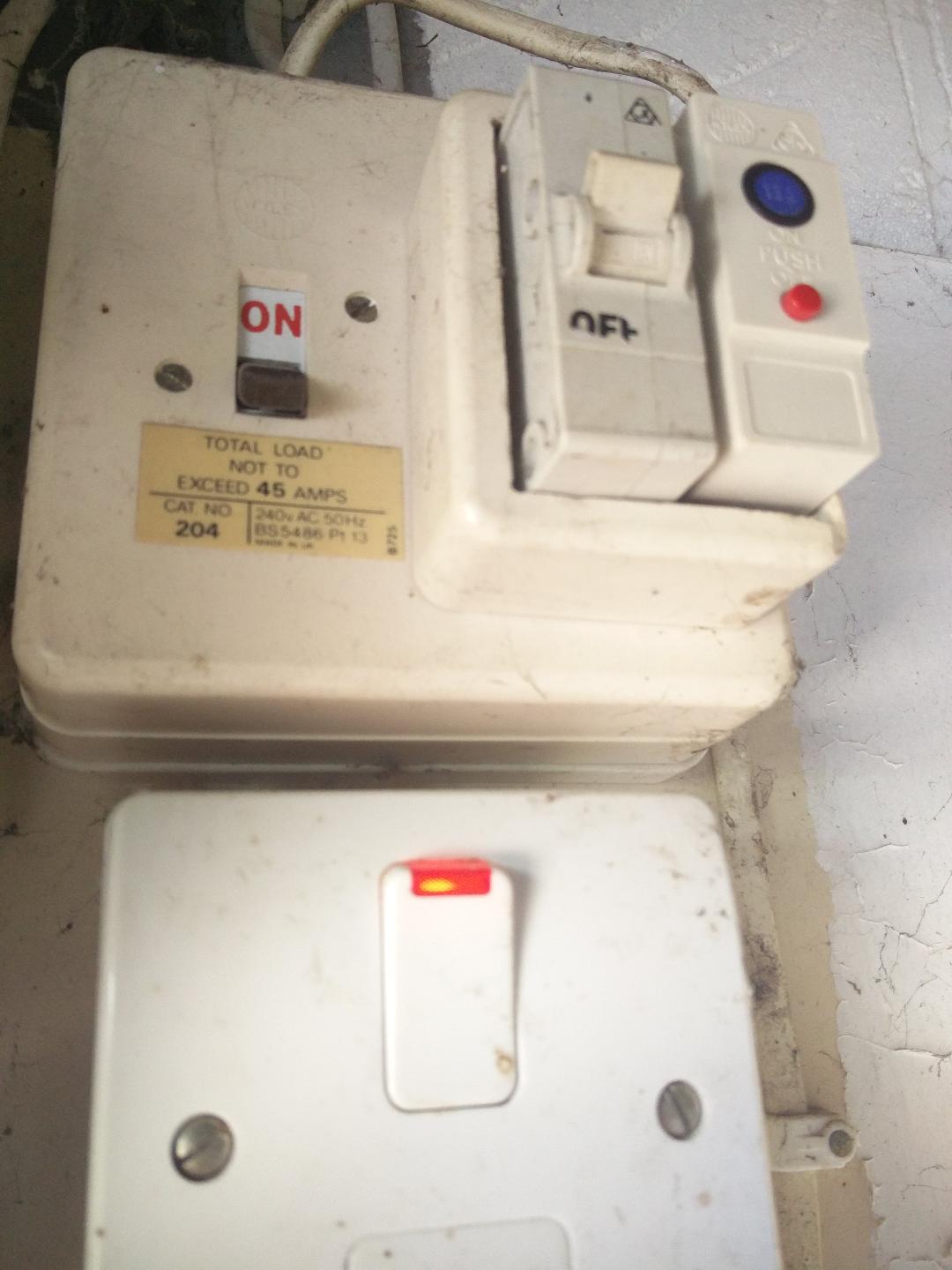

Garage fuse board: I suspect this needs to be updated to allow another connection to the home office? and to bring it up to modern standards?
The illuminated isolation switch at bottom of photo is for our sensor light, I think the 15A blue fuse is for the power sockets in garage.
You need to find out how the Garage is cabled and then we can determine how best to approach this (but personally i'd have a separate feed). Ideally the Garage & Home office should have their own RCD/RCBO discrimination if a fault occurs otherwise the house circuits on the RCD will lose power too.

In my opinion, you have a 32A connection to the garage.
I see no point in updating the existing fuse box in the garage to provide a new circuit. The existing one us doing it’s basic job.
If you put an MCB in there it would have to discriminate with the 32A MCB in the house and that would greatly reduce the total current available at the office to maybe only 16amp.
I would simply extend the feed to the garage on to the office thus providing a total of 32A. A small CU in the office to provide isolation for the various circuits there. It will not need an RCD, there’s already one at the house end.
You’ll need an electrician to design the cable sizing as will have 10+25 metres distance from the supply. We have no information on the cable sizes on the existing feed to the garage.
the electrician will be the one who needs to certify and NOTIFY this work. better to find one and ask him your questions.
PS Send a pic of how the power feed comes in to the garage and connects to the garage fuse board. Will better be able to judge what might be achieved.
