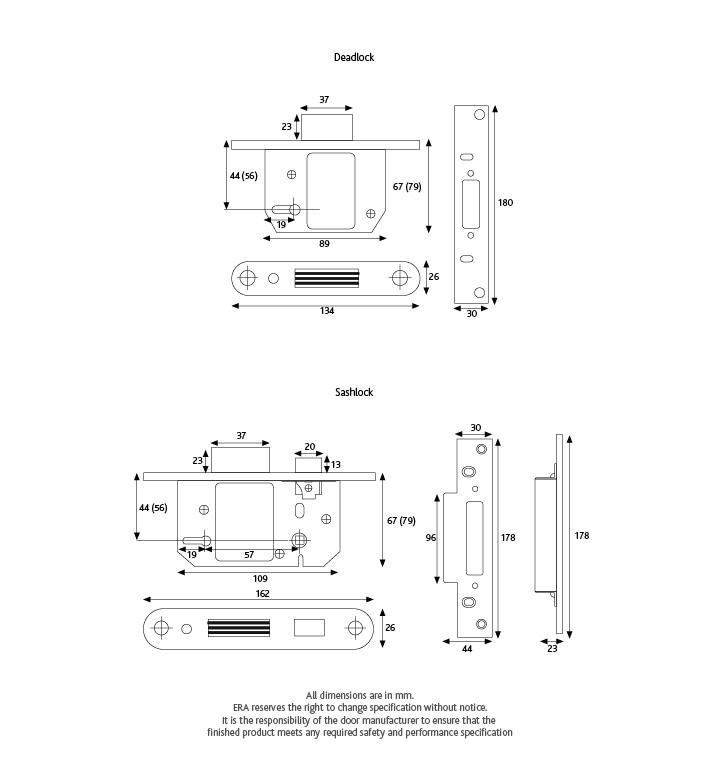

Thanks everyone for your advice - apologies for having not been back on here sooner.
Having had a look at the locks, I have concluded that they are knackered - I have tried both sets of keys in each and neither work properly in either lock.
My wife also tried to use the locks whilst I wasn't around one in particular is now really broken - the key can sometimes turn all the way around with doing anything and then suddenly it opens the lock.
I think that I am going to take the hit and buy two new replacement ERA locks (and perhaps look after them this time) - one thing that does worry me is that the locks that I currently have, appear not to be BS3621 compliant, which would have screwed up my insurance.

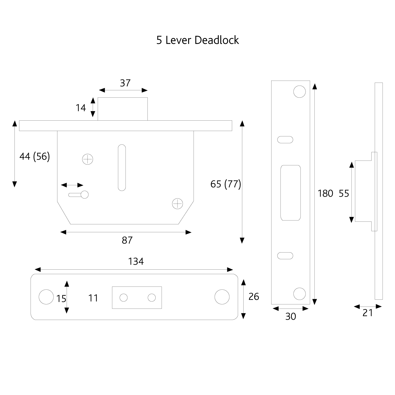

I have taken the locks out and have done some measuring (with advice from the internet).
It seems that they have the following:
Case Height: 65mm
Backset: 44mm
Case Height: 87mm
Forend Length: 134mm
Forend Width: 26mm
I have read that the following two companies are pretty reasonable for locks and have found models on each that would appear to fit:
https://www.lockshopdirect.co.uk/pr...era-261-31-67mm-(2-5-inch-)-20549/#detailtabs
https://www.locksonline.co.uk/Locks...Era-208-308--BS3621-Invincible-Dead-Lock.html
Is there any difference between them?
They have very slightly different names and the latter one has gold keys.

As far as I can see, this
https://www.eraeverywhere.com/defau...-british-standard-deadbolt-mortice-door-lock/
Is ERA's latest version of the 5-lever BS3621 deadlock.
To my eye, it looks the same as the "locks online" picture which seems to have four anti-saw rods in the brass bolt, rather than the laminated steel type. They offer free keying alike, which is very useful.
"lockshop direct" charge an extra £8 per lock to have them keyed alike.

Wow - very impressive. As you say, the Locksonline lock does seem to have a different bolt (I never would have noticed that in a million years) - I assume that the anti-saw rods must be the superior?
Plus, if the brass key is better too, I shall definitely get that model and do exactly as you say - i.e. keep them as master keys and create a number of copies for operational use.
the bolt type might have been altered as production progressed. I don't know which is better, the BS test includes resisting attempts to saw through it. I spotted later that the ERA has photos showing both types so I don't know which is newer. You could give them a ring.
