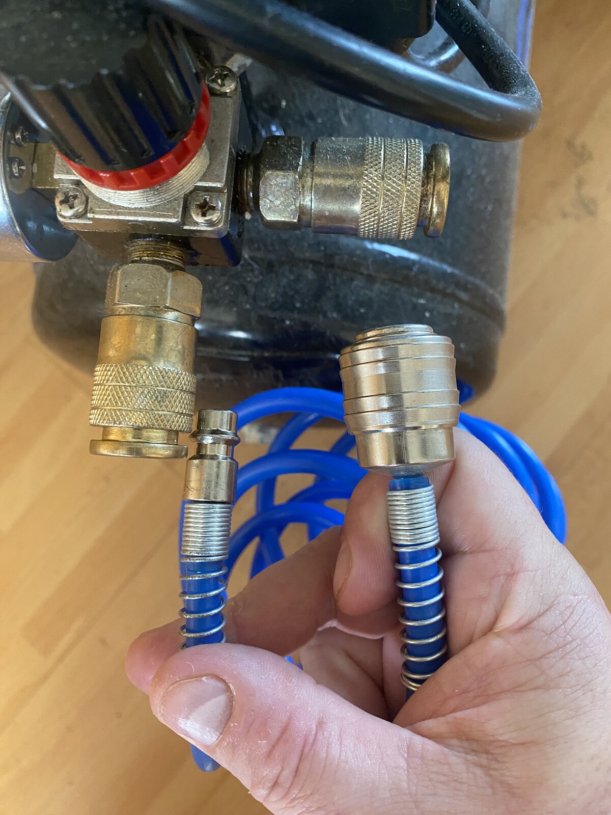

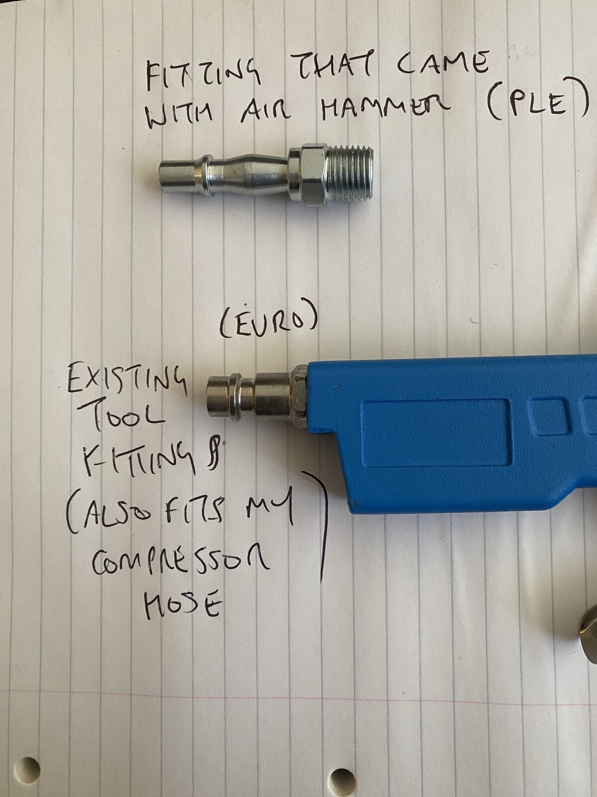

My existing tool ends that fit my cheap female to female spring hose. Plus the longer PLE fitting that came with my new hammer gun.

It seems most air line is the longer PLE type?

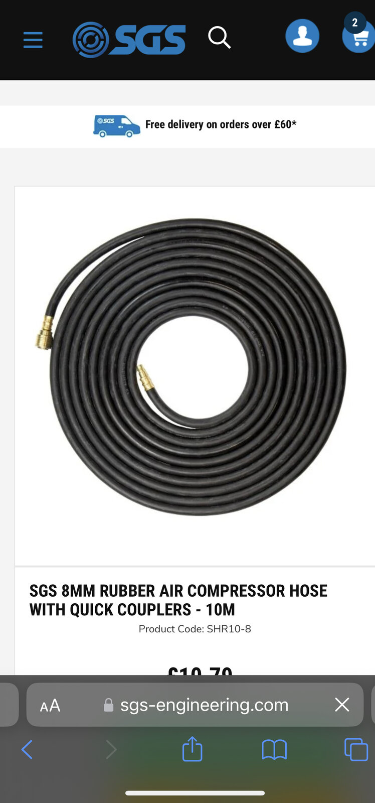

Any suggestions on what to use as standard and what 10m line I require?

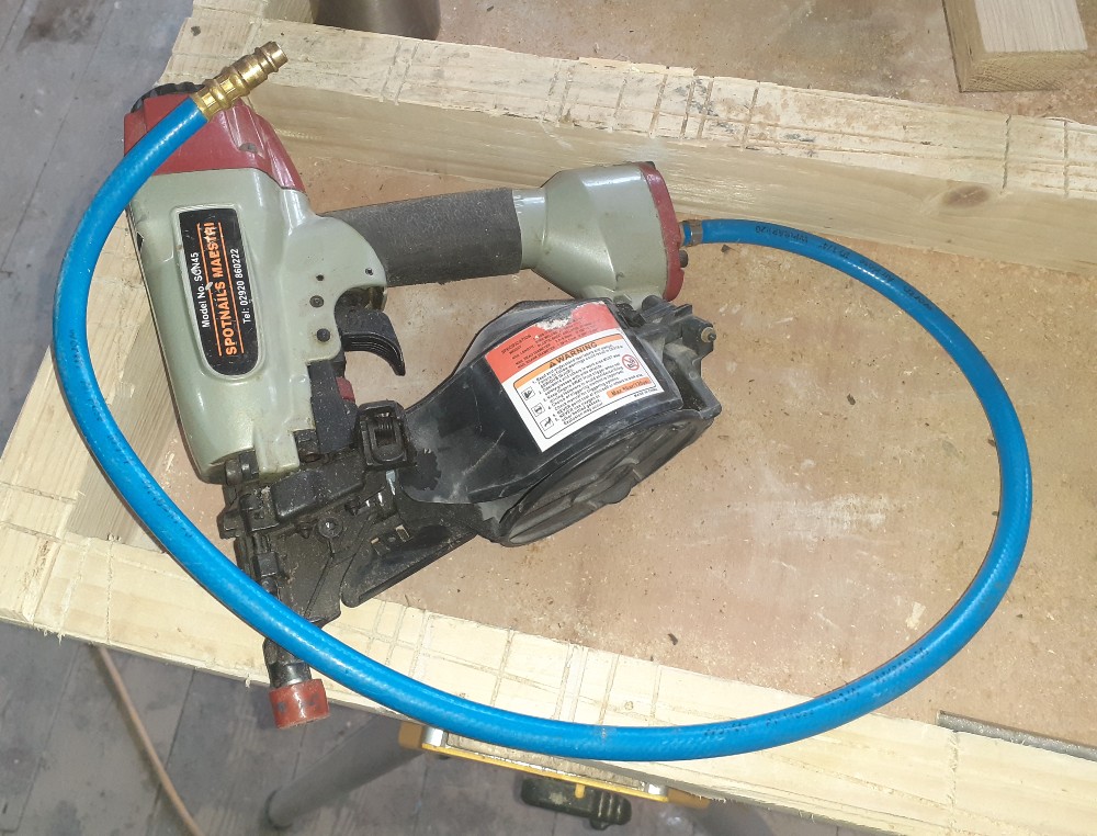

I use pneumatic tools for sub-flooring and structural flooring work (nailing) and I've been on Euro fittings for maybe 20 years, having chosen CEJNs over PCLs in the 1980s. With high air volume tools the Euro fittings are streets ahead of the old PCL types because they have a bigger 'ole, so have a higher flow rate (not surprising as the PCL connectors date back to about the 1920s or 30s). This makes PCL a poor choice on tools such as needle scalers, etc. The only time this affects most users is if they need to run a very long hose like I sometimes do (say 50 metres plus), when you find some tools can become a bit breathless. PCL connectors also seem more likely to accidentally disconnect than Euros.
So one vote for Euros here
Incidentally, PCL manufacture their own Euro-compatible fittings called "XF". These are Euro fitting and are incompatible with the original PCLs
I'd chuck the "curly whirly" hose - they mark stuff and seem to trap and drag everything around. Especially bad when spraying, sanding or working on finished materials (e.g. polished floors). Something like a 10 or 12mm ID (3/8 in or 1/2in in old money) reinforced rubber hose is best for longer distances (more durable but the black rubber can mark delicate surfaces). For shorter distances in relatively clean environments I use 8 or 10mm ID reinforced PVC. Not as durable, but lighter. I also fit all my pneumatic tools with a whip hose:
rather than have a make connector direct into the tool, which can cause premature cracking of the end casting of the tool with frequent tool swapping (and in any case as I am trade I am also following HSE recommendations on this one)

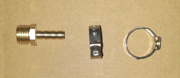

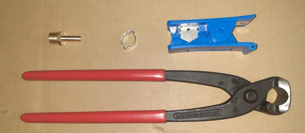

PLE? Most of the hoses I've looked at have either PCL ends or threaded ends, either NPT or BSPT. Most non European tools seem to come with a NPT female threaded body, so I make up my whip hoses by using an appropriate NPTM (male) x barbed air hose connector, a length of air hose, two crimp connectors (which technically require a special crimp tool but in reality can be pressed to fit using a bluntish pair of carpenters nippers) and a barbed air hose x Euro male end. This is a BSPT male x barbed hose connector and a hose crimp with the crimping tool and a hose cutter (sorry, no spare other ends or hose at the moment):
Hoses come in various sizes with dimensions stated as inside diameters (ID) and the banjos come in different sizes to fit them. BTW don't worry too much about NPT and BSPT - BSPT forms a non-air tight connection with NPT, you make it air tight by wrapping the male threads with a turn of PTFE tape before assembling.
The collated flooring nailer in my previous post uses this type of banjo crimp at the body end of the whip hose
There are other hose connection clips such as this type used a lot on cars:
Again, these can be tightened with a pair of nippers. I don't but Jubilee clips as they are quite bulky and can catch on stuff

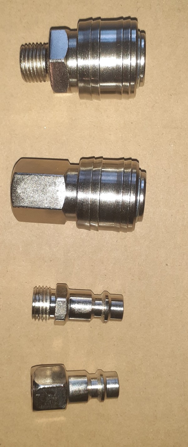

Another way to buy a hose is simply to buy one with BSP threaded ends (often 3/8in BSPM or 3/8in BSPF) and add your own adaptors, such as these (from top to bottom - BSPM x Euro female, BSPF x Euro female, BSPM x Euro male, BSPF x Euro male):
They are all 3/8in (I think), but 1/4in is another common size, especially on smaller tools with limited air consumption
Hope this helps

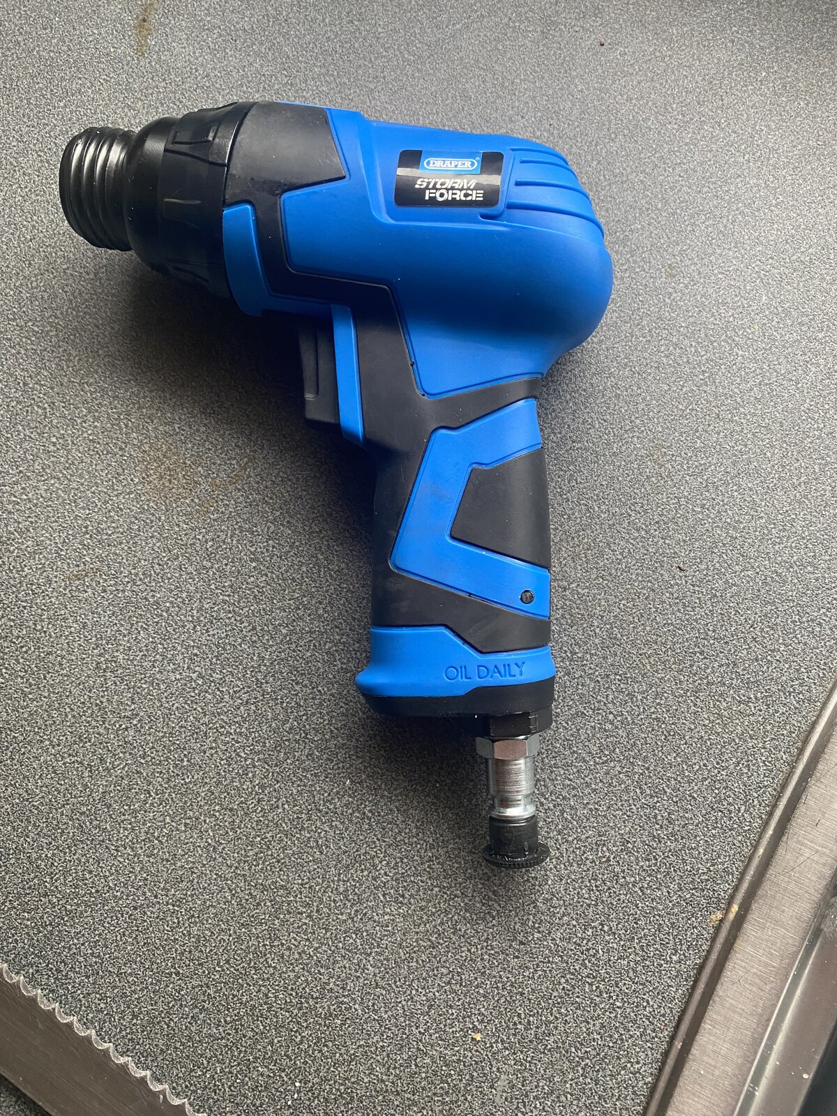

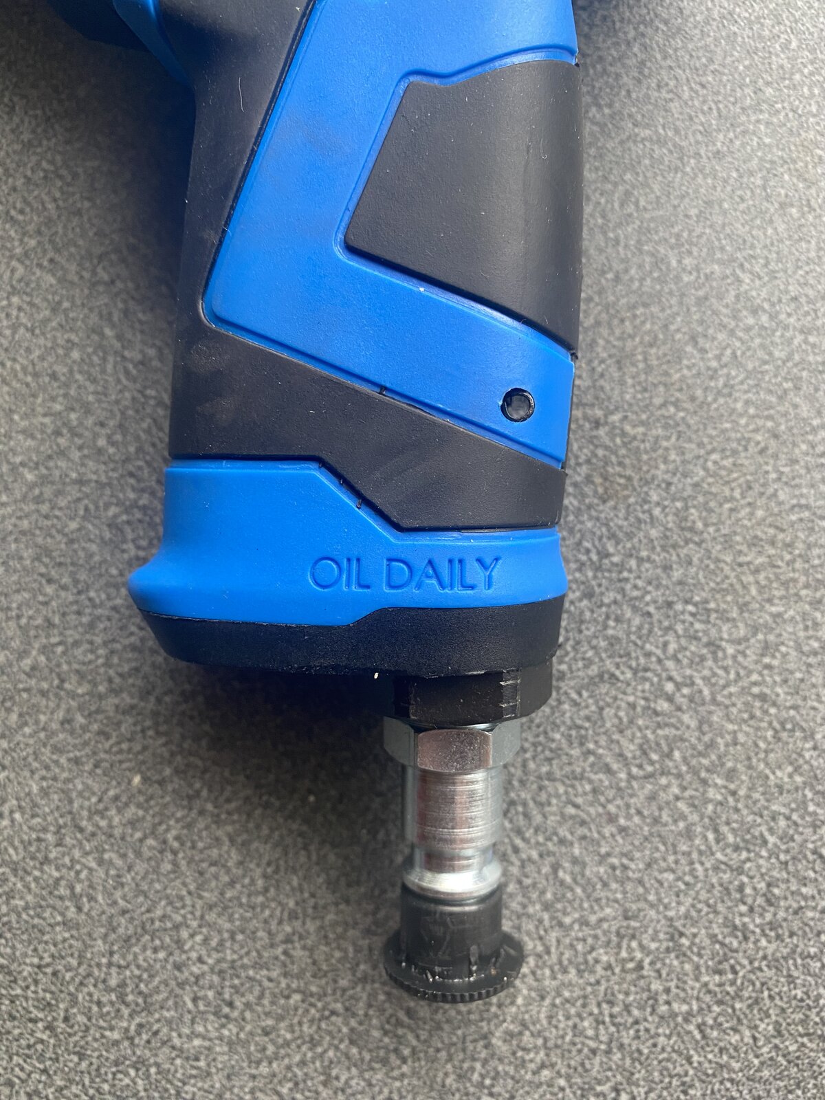

Also I have just had a scraper air hammer and it has oil port on it.
Nothing in instructions on what to do with though ?
You can see through the hole as in pic.
Can I use the compressor oil in it plus how much and how or does it go in that tiny hole?

I used to use an in line oiler, that was jointed into the air line itself.
This used to keep the air tools healthy enough, but the oil consumption was excessive (dripping out of the tool itself) so I abandoned that one.
Occasionally I'll squirt some thin oil into the air connection at the tool itself - or maybe use the oil hole with a trigger oil can. The tool will shoot most of the lube out anyway.
This is a big no-no if paint spraying, of course!
Regularly drain the air tank though - you'll be surprised at what quantity of rusty watery gunge comes out.
If it's a piston compressor there will be an oil level sight hole or a dip stick on the compressor unit.....if it's a diaphragm one this doesn't apply.
