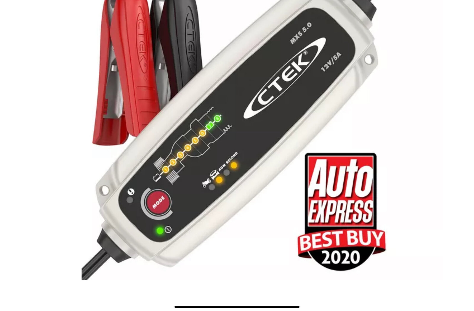

The Ctek is the well known one, but there are others.
Mine has maximum charge rate of 3.8 amp with early one and 5 amp with latter one, and it quickly drops to lower charge rates, so a 90 Ah battery can take days to recharge.

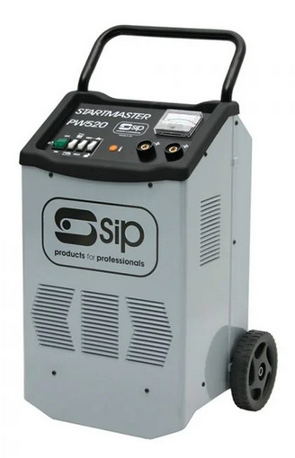

We have one at work like this 1705632606503.pnghowever at £265 they are expensive. And darn heavy. Some Ctek can cost £300 for the 25 amp version designed for caravans, and this is the problem, the battery will not last long with a cheap charger. My father-in-law and mother both had stair lifts with 7 Ah batteries, father-in-laws the batteries never needed changing other then when he unplugged it, but mothers needed new batteries every couple of years, the more the lift was used the longer they lasted, as they were slightly over charged.
