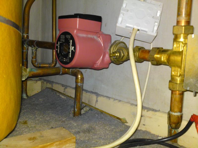

Hello
You say the system is working ok, radiators are getting hot and hot water ok, pump is on number two and all rads from your posts appear to have been bled numerous times. How long has this been happening and what controls do you have on your system, i.e trvs three way valve, etc etc.
Hi mr methane
The controls i have, there is 1 trv on a downstairs rad (on max), a 3 way valve by the grundfos pump, air vent next to hw cylinder, F&E tank in loft, digital room stat and digital heating/hw timer unit The rushing noise has been there for a couple of years i would say, heating and hot water work fine, not much air in any rad when bled, dont hear noise going through rads, sounds like its going round in a loop pump to boiler and back ?? its finaly annoying me enough to try and sort it.
Any ideas that i could try ??
Cheers mate,
Steve.

have you noticed if the noise is still present when the boiler is heating the hot water cylinder?
Some photos of your pipework around the boiler, pump, motorised valve and cylinder might help.

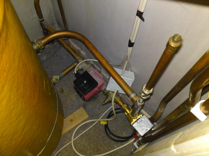

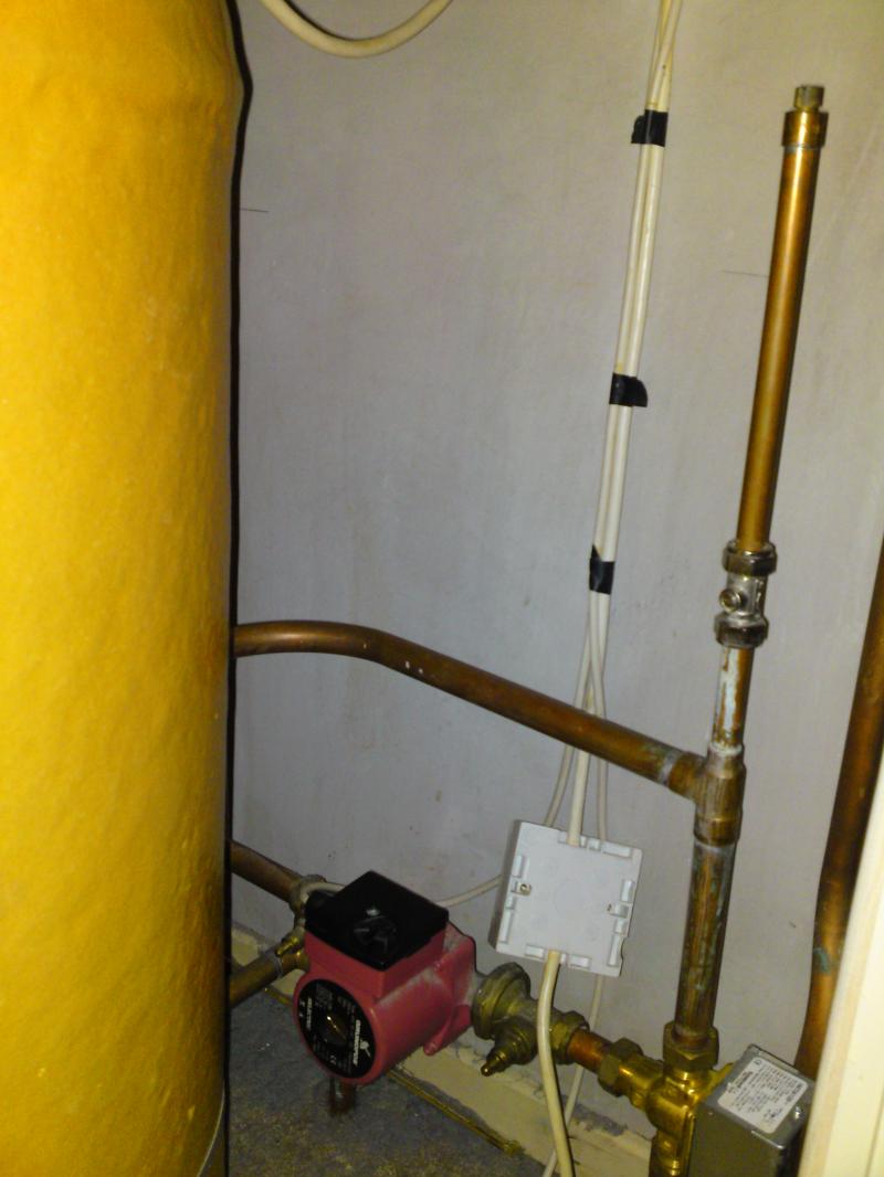

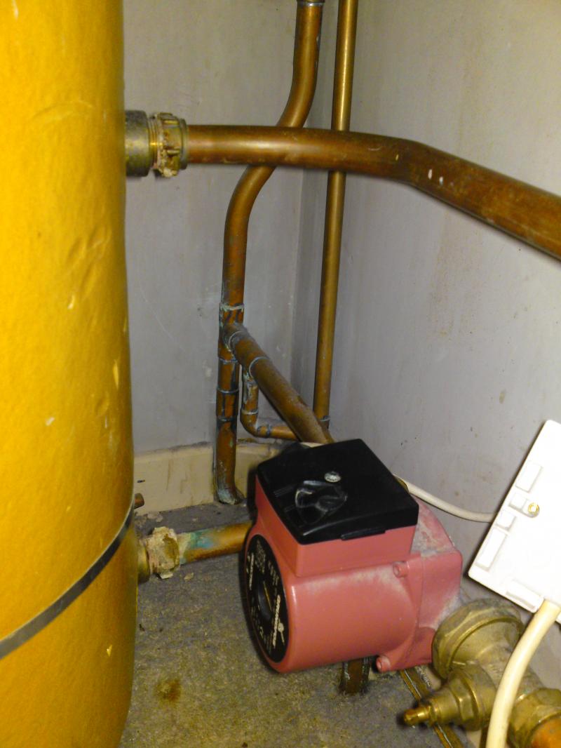

I've taken some photo's as requested.
Cheers mate,
Steve.
coming out of the motorised valve is a vertical copper pipe with a brass fitting on the end. Have you bled it?
I can't see a balancing valve on the pipes that go to and from the cylinder coil. Is there one? Do these pipes go cold once the cyl is up to temp?

Yeh I bled the vent pipe, hardly any air came out, loads of water.
F&E tank - level ok, not much sediment in bottom (3mm) well below outlet, have not checked if pumping over or sucking (will check tomorrow).
No balance valve on pipes to cylinder coil, when cylinder is up to temp, the lower pipe starts to cool but not cold, the upper pipe stays hot.
I also noticed that the 'top up' pipe going up to the F&E tank gets warm (all the way up to the ceiling, not sure if its just heat conducting ?)
Pump speed set on No. 2 (4 bed house) Boiler has settings 1 to 6, its on No. 4

air is not being encourage to vent due to the orientation of the expansion pipe. velocity of water is carrying the lighter air along the pipe into the pump. ideally i would step up the horizontal pipe at the elbow to 28mm then teeing off for open vent followed by the cold feed. You may find possibly a blockage on cold feed is causing air to be drawn in through open vent pipe (poss unlikely though as you've done rad test described).
There is a tip on here somewhere about putting a cup of water over end of vent pipe when system is running and seeing if it draws up water out of cup
