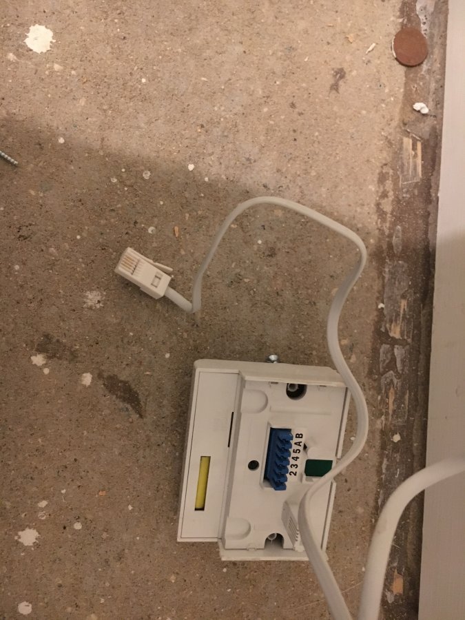

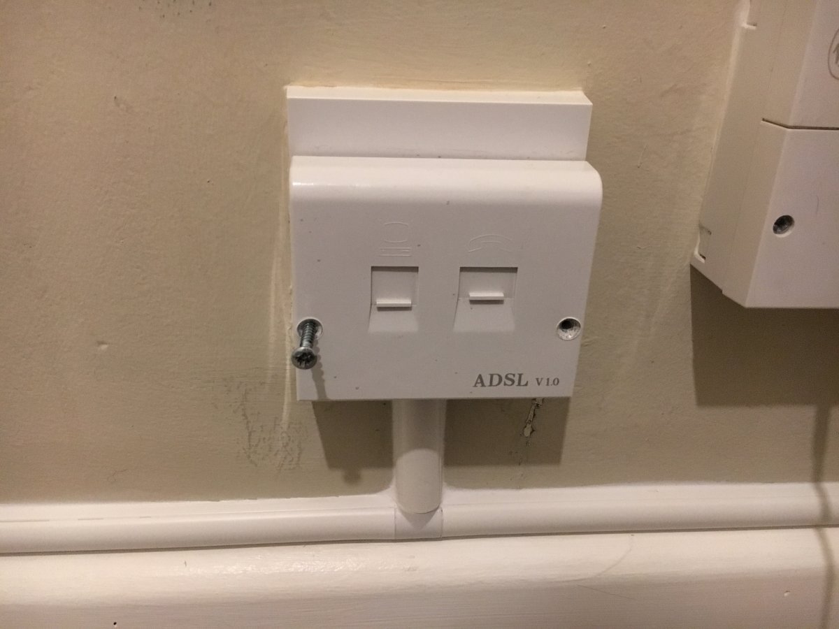

Hi,

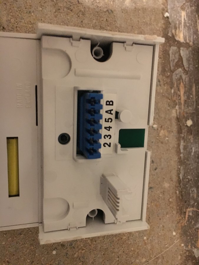

I have just moved my Yale alarm to a new location and was wondering if the telephone connection can be hard wired to the connectors in the back of my ADSL face plate?
I have attached a few pics of what I am on about. If it's possible does anyone know the pin outs for the connection?
Many Thanks
Will.
The wires in that flat cable will be stranded cores, which are not suitable to go into those IDC connections on the back of the ADSL filter. You may get lucky and it'll work for years, or you may get intermittant faults that bug the hell out of you for years instead!!
How does the cable connect at the alarm end? If it's just an RJ11, then you could run some solid core cat5e between them and crimp on an RJ11 plug which is designed for solid core, then punch that cable into those IDC connections.

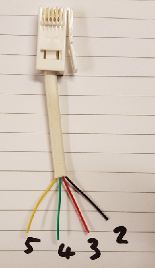

If you do just want to risk it with the stranded cable, cut the BT plug off and strip the piece you have cut off like this just to check the colours. You can see how the wires come out in a line with flat cable, relating to the numbers on the socket. (pins 1 and 6 aren't used)

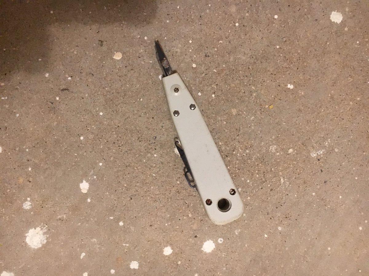

You may have different colours in your cable, but just lay it out like this to work out your own colour code. Then strip the other cut piece and punch them into the IDC holes using a tool like this.

A cable like that ought to use 24awg stranded wire, which ought to connect into an IDC connection (albeit not designed to, as warned), but a cheapo lead could use thinner wires in the cable like 26awg, which won't make contact.
What tool did you use to push the wires into the IDC slot?

Sorted it. The alarm only had two active wires. So I connected them to pins 2 and 5 on the back of the ADSL face plate. To overcome the wire width I stripped of the end and bent back the bare wires on itself and then punched it in with a punch tool.
