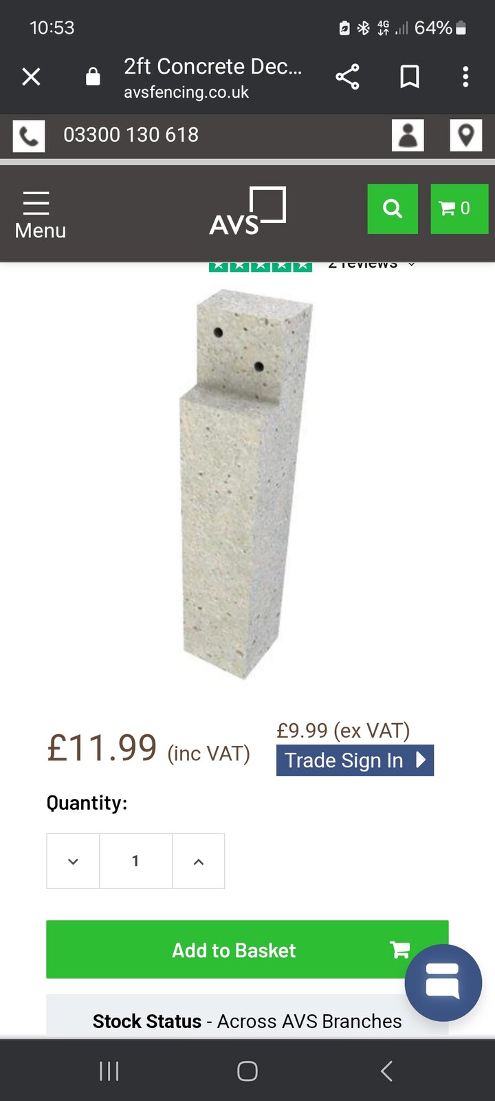

There is an access gap to my back garden that is equal to width of my hips and that is it, so getting a digger down to bottom of the garden is impossible as is getting a wheel barrow down there.
I am building a summer house/workshop so it needs good support.

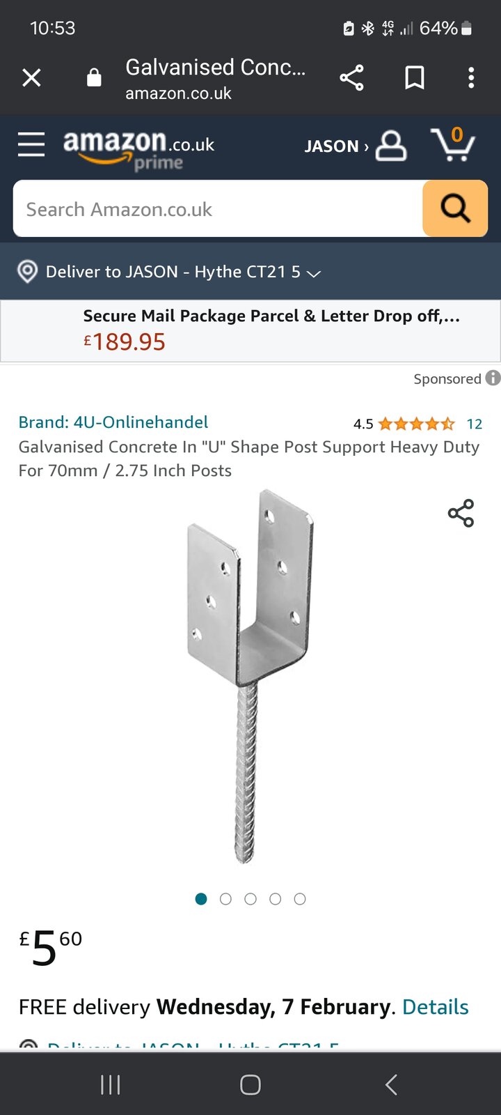

I was looking at possibly using the concrete posts as per picture set into concrete, much like the principle for fence posts. Or making shuttering to form concrete piers set into the ground and then pushing the galvanised supports into the concrete.
Do you think either is feasible, I'm concerned about the shear capacity of the notched concrete post.
If it's anything like a concrete fence post, it will be heavy and dense. If it's designed for a deck it should take a shed.
But for for the cost of it all, why not just knock up some concrete pads and sit the building on concrete blocks?

Looks like a good method to me, if a proper footing isn't possible. Although a chunk of metal sticking out of the ground definitely will rust eventually, galvanised or not. Rebar is normally completely encased in concrete, which preserves it, and even then steps are taken to stop the concrete getting too wet. It should outlive most of us though.
