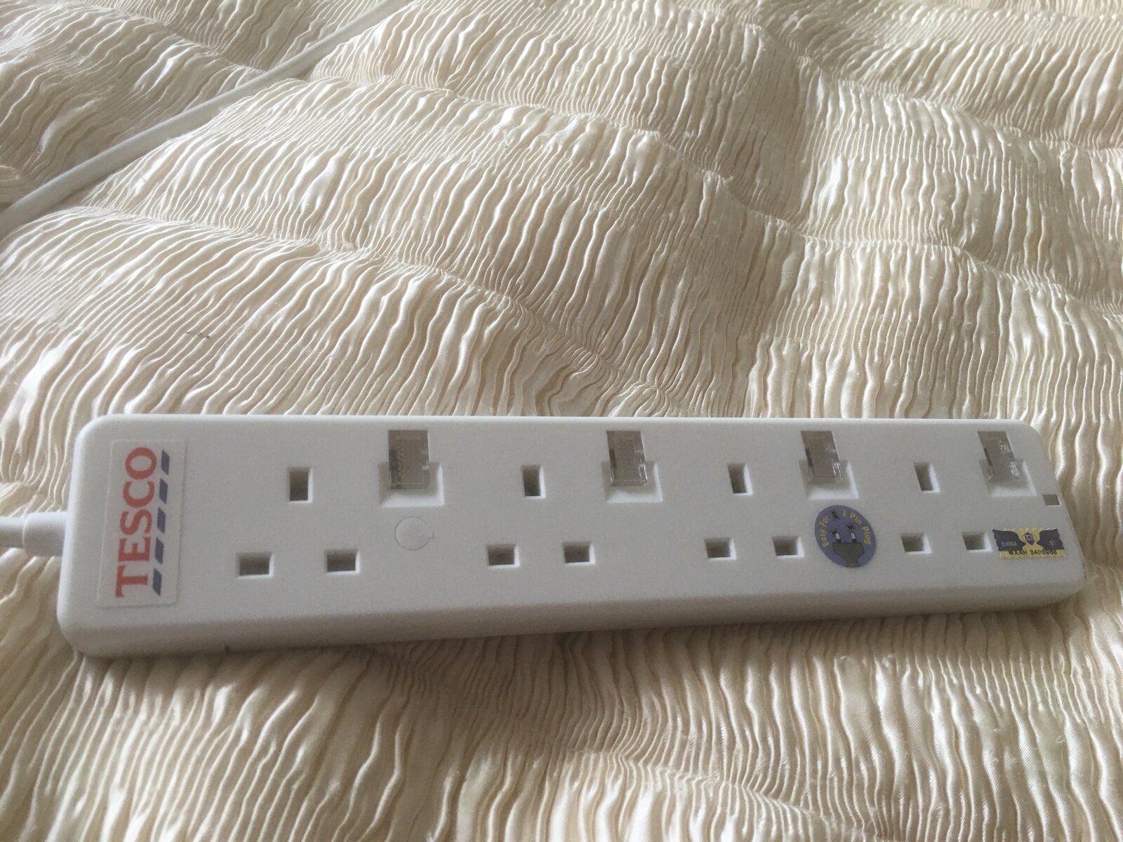

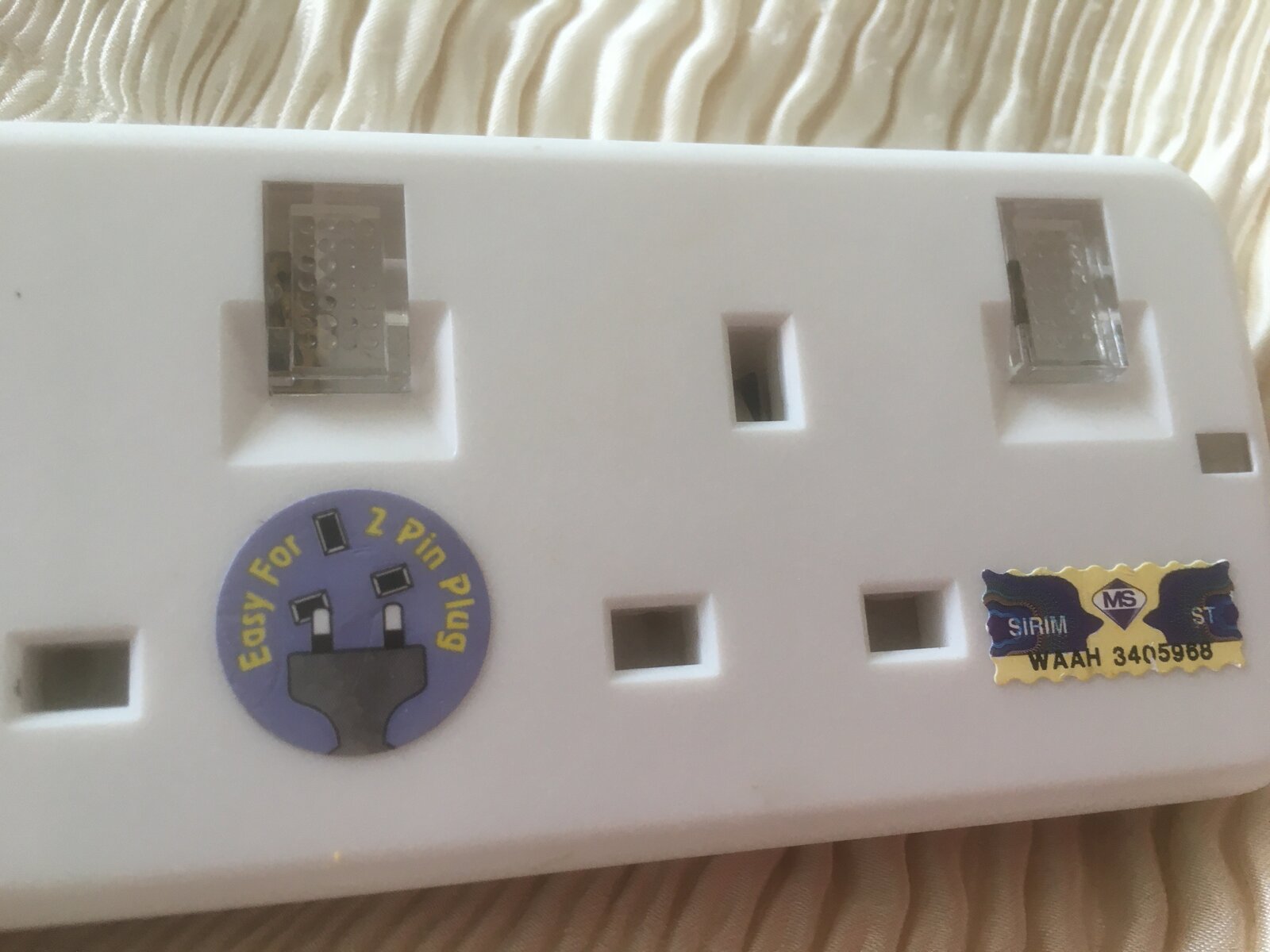

No, this is what you need. No 24/25 here.
http://www.plugsocketmuseum.nl/British1.html
Available in a range of colours in any supermarket in Malaysia, around 10p. All Malaysian students here bring a handful back when they return from their first summer break home.
Another "useful" gadget from Tescos in Malaysia. It has dimpled shutters so a Europlug will go in. The SIRIM label is the Standard and Industrial Research Institute of Malaysia (SIRIM). So it must be OK then!
It's not compliant with BS1363 but other than that I don't really see how an extension strip that can take both BS1363 plugs and Europlugs is any worse than an extension strip for any of the many socket types used in Europe.
