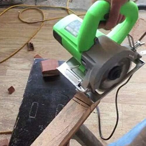

Also, I just noticed that the third photo on the blade I previously linked to
https://images-na.ssl-images-amazon.com/images/I/512ELGxRyJL._AC_.jpg
shows an angle grinder different to any I have seen. Making it more likely that these are intended for a different market.

Yes. That looks like a chip limiter design, although I'd expect to see a BG Test logo and probably a TUV logo as well on it somewhere if it had been tested and approved for use in Germany (the brand suggests German, perhaps)
I think it's a tile saw, not a grinder. These look like a circular saw but run at a far higher speed and are designed to cut heavy ceramic floor tiles using a wet diamond cutting disc. I've occasionally seen commercial tilers pull one out to whip up a section of heavy duty floor tiling to make repairs - they are better guarded than ordinary angle grinders (meaning that they are mandated by a few main contractors) and are sometimes designed to work with water (dust) suppression. Also seen them used dry to make trimming cuts. Firms like Makita, deWalt, etc still make them or have made them in the past
