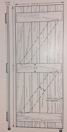

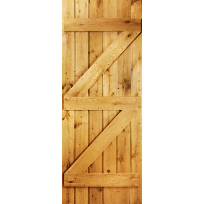

When making a ledge and brace garden gate what is the minimum and maximum angle a brace should be positioned at? From what I've read the angle should be 45 degrees or more. If it's more than 45 degrees what is the max range?

For it to be 45 degrees the door would have to be very short, or very wide.
I do not speak with any authority but surely it need to be a long as it needs to be? The longer the door, the greater the angle will become. I cannot, off the top of my head, work out why any angle under 90 degrees will be an issue.

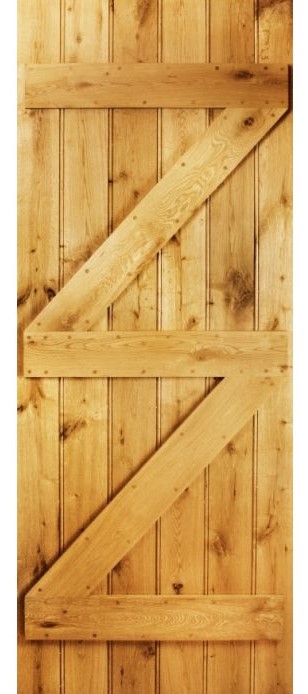

But they should both go in the same direction. From the hinge side upwards to the latch side.
Gives the effect of two Z's sitting one on top of the other with a horizontal bar running between them.
In the case below, the hinges would be on the left side.

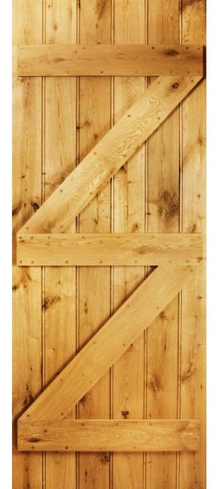

They can be made either way

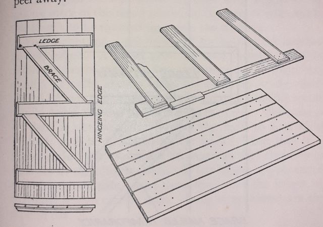

But did you just leave the end of the diagonals cut flat?

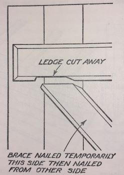

or did you seat the ends of the brace in notches cut into the ledges to stop them moving?

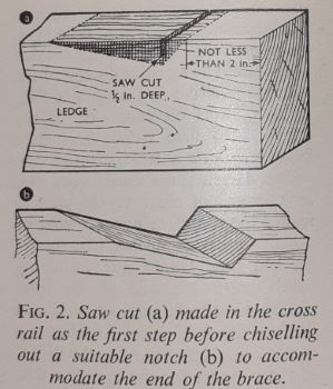

That's one of two methods I was taught - the other is this:
The "modern" way of not putting a notch in there puts all the strain from the brace into the planks alone, and of course planks can swell or shrink (especially if they are outdoors), so the gate is more likely to droop if you don't add that notch. The fact is that ledged and braced gates will always droop a little, but notching the ends of the diagonal bracesn reduces the tendency, but if you want to avoid that completely you need to go to something like a framed, ledged and braced frame with a planked cladding which is a lot more work
That's not what I was taught - and not what I've taught apprentices, either. The braces should always run diagonally upwards away from the hinges

I do know about the slanting pockets for the ends of the brace, but it was made for me by a skilled-seeming young local joiner who cut them flat.
Yes, thats what we were taught in woodwork at school and the way I have made them.
