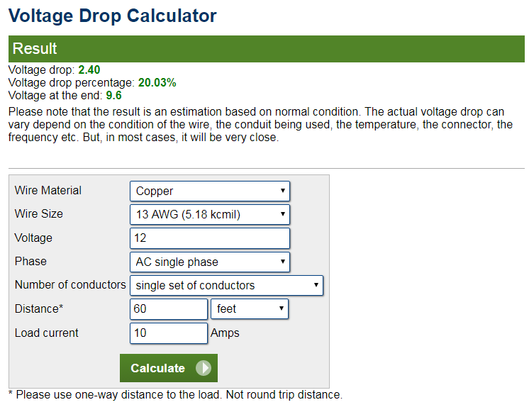

I get 2.4V drop with the calculator ???
What have we done differently?
I get nearer 3V working it out myself using -
Resistance of 2 x 2.5mm² is 14.64mΩ/m (you wont need to add anything for conductor temperature rise; might be a bit less for cooler)
x 20m. x 10A /1000 = 2.928V drop, so 25%.
However, if your lights are evenly spaced from beginning to end of the cable, then you can halve that - or allow for whatever spacing the lights have.
Ah- thanks for the reply. I selected 18 awg thinking the kcmil was the mm2.
So is a 3v drop acceptible, or does it depend on light I am connecting?

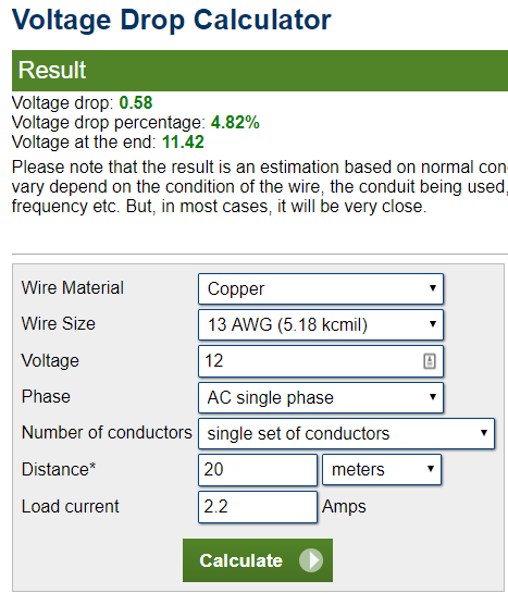

Having a search around I have seen a 5% (0.6v) drop is acceptable?
If this is the case, for a 20m cable run, I can have a maximum of 2.2amps or 26watts - is this correct

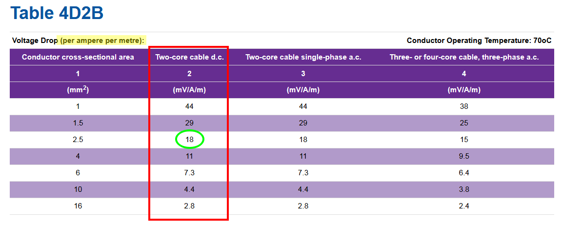

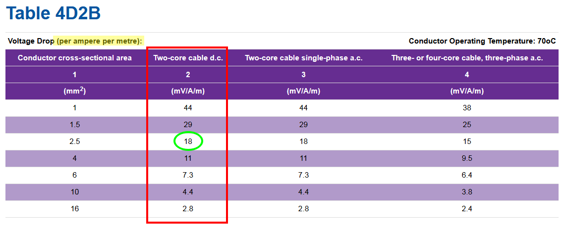

In any given length of cable, voltage drop is proportional to current.
So the total drop of any cable depends on its length, and how much current is flowing - the longer the cable, the greater the drop. The higher the current, the greater the drop.
It follows that one characteristic of a cable is its voltage drop for a particular current over a particular length and at the sorts of currents and lengths found in low and extra-low voltage final circuits, millivolts (of drop) per amp per metre are the most sensible unit.
So that table shows that, to use your scenario, 2.5mm² cable will have a drop of 18mV for every amp of current for every metre of length.
If you've got a 10A load, over your 20m the voltage drop will be
(18 x 10 x 20)mV = 3.6V
