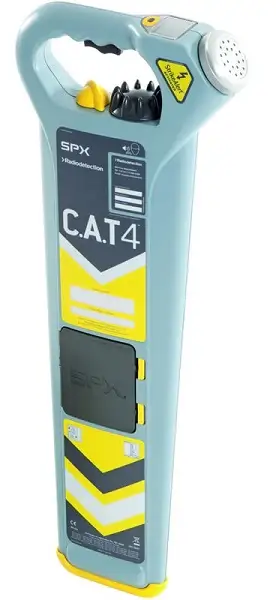

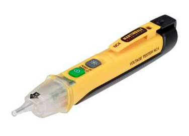

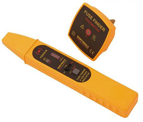

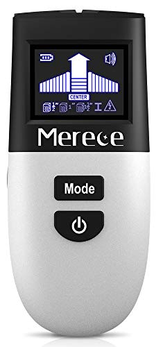

These are all contract less detectors upload_2022-4-11_12-6-35.png upload_2022-4-11_12-8-10.png upload_2022-4-11_12-10-28.png upload_2022-4-11_12-12-18.png and all very different, they detect electric and magnetic fields with varying degrees of distance and reliability. I had a combined magnetic and voltage detector used in the main to test solenoids, it was not cheap when compared to simple volt stick, and I found it very helpful, but it was an indication only, and one needs to understand it's limitations.
So before removing a switch from the wall it is possible a detector upload_2022-4-11_12-24-28.png upload_2022-4-11_12-25-24.png may show if live or not before removing the screws, but once screws are removed you want a more reliable test, even the neon screwdriver upload_2022-4-11_12-29-2.png is better than contract less testing.
