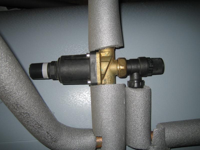

Could be muck in the strainer in the multi-function valve. These should be removed and cleaned annually when the cylinder is checked over.

Probably the non-return valve or pressure reducing valve chattering. Usually comes as an all-in-one combination valve. Has the inlet strainer ever been cleaned? TRy that, if not replace the combination valve.

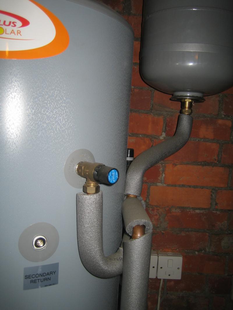

It sounds like the noise is coming from one of these widgets attached to the cylinder

The chattering noise has been happening ever since the system was installed so is it possible the pressure relief valve just was never set correctly ?
ta
CIDER you are the winner ! :!:
Mr Santon came round fiddled with the expansion tank (apparently it was the daiphram vibrating too rapidly)
Bizarrely he turned the expansion vessel upside down ... and replaced the rigid copper with a flexible hose
And that seems to have sorted it
