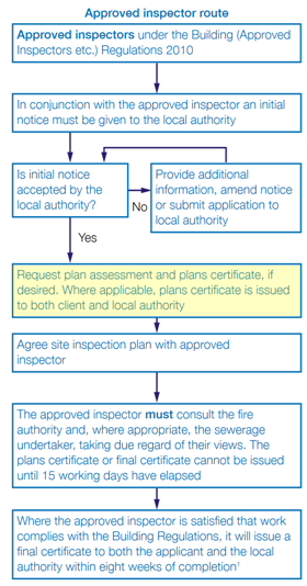

Hello Ive had an acceptance through from Building control and im wondering if its recorded anywhere else? The main reason for this is just incase the private Building control firm were to go bust. No reason for me to think they will but as the only proof I would have of things like depth of footings etc would be photos I wonder where I would stand?

Basically, AIUI, the way it works is that you notify Building Control that youre going to be doing notifiable work.
You can either just say "Im starting on dd/mm/yy, and I will of course comply with the Building Regs", and they rock up now and then to check what youre doing/have done.
Or you can say "here is how I plan to comply with the Building Regulations" and they look at your plans and say "Yup - if you do that it will be fine" or "No, that wont be any good", but once you are at the point where the man he say yes, you crack on and they rock up now and then to check what youre doing/have done.
Or you can go the private approved inspector route where they rock up now and then to check what youre doing/have done. And it does look in that scenario as if the inspector has to tell LABC its going to be happening, LABC might want more details than "Wes gonna be doin an extenshun", and your appoved inspector can optionally ask them to assess the plans and issue a "certificate" to say "Yup - if you do that it will be fine".
I don't know if they call it "certificate", but they send a letter after BC notification saying if all is good in the plans and highlighting any fault/recommendations.
