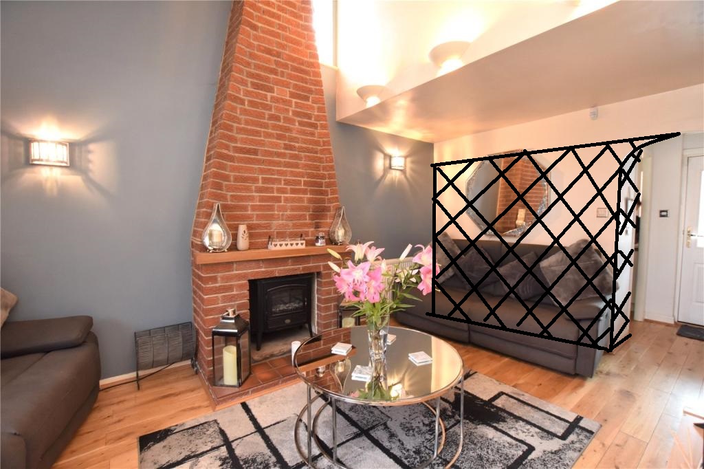

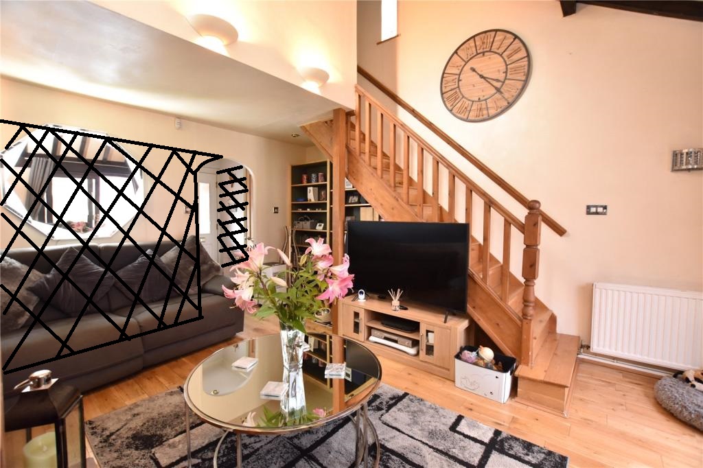

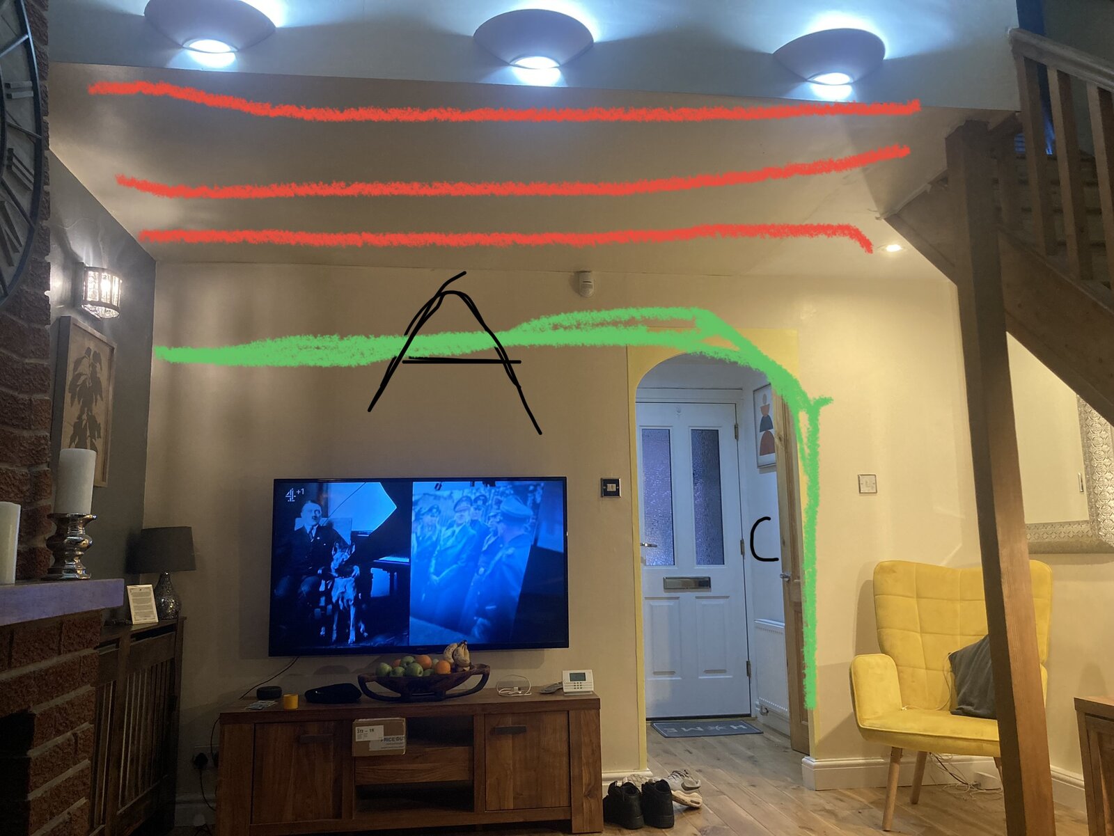

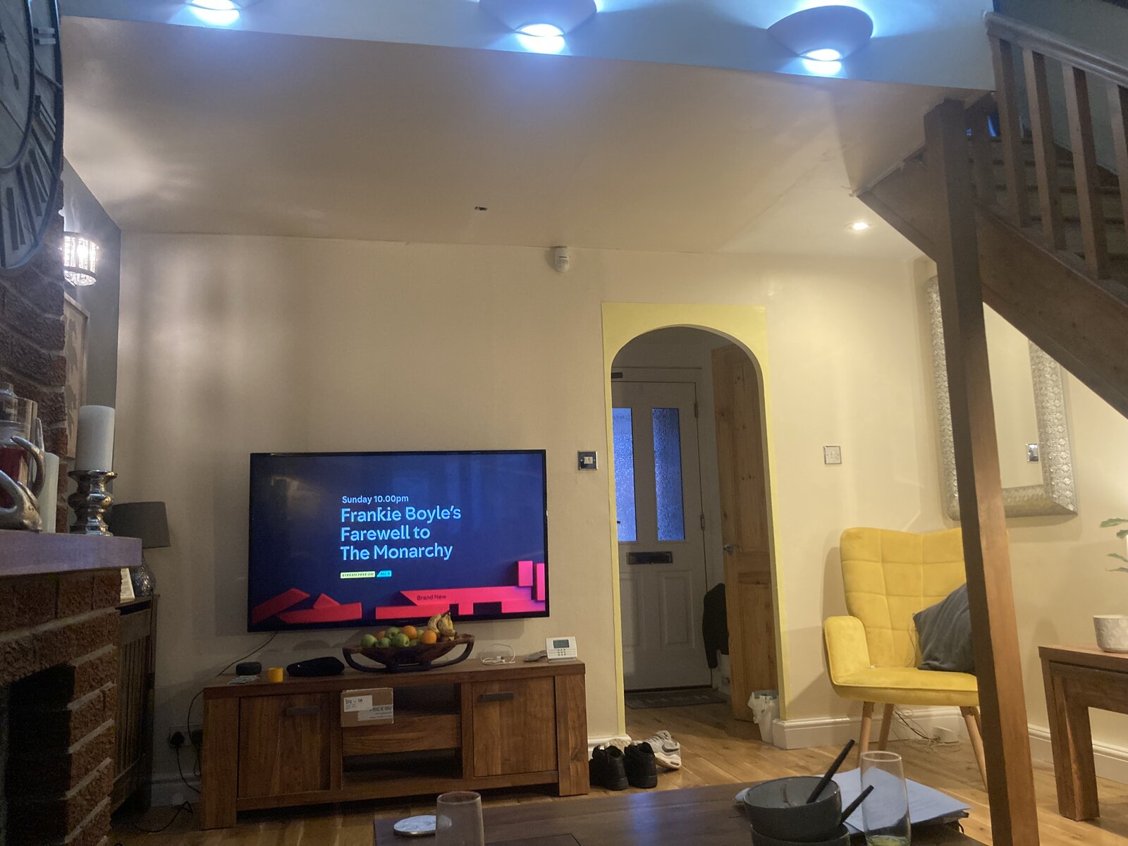

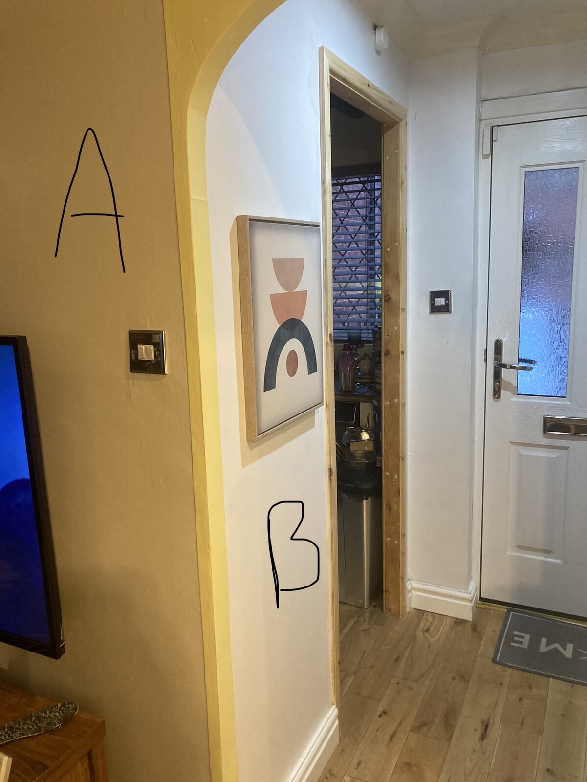

Hello. I’m wanting to take out 3 walls to make the living room open plan with the kitchen. I’m sure the walls are just partition stud walls as I’ve drilled through them to attach various things. However, I’m sure I’ve read somewhere that stud partition walls can also be load bearing?

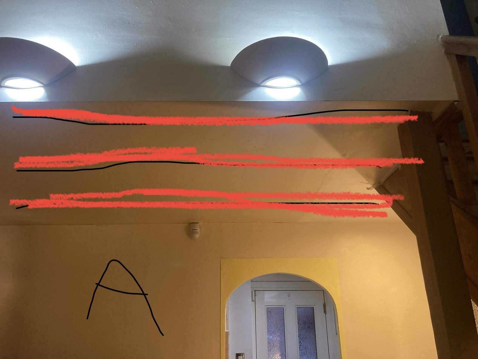

The wall ‘A’ I’m wanting to extend the arch and take out the remaining wall indicated by the green line. The red lines on the ceiling represent the beams I’ve located. Wall ‘B’ that runs at 90* to wall ‘A’ appears to be a stud wall around 70mm think the same as wall ‘C’ which I’m also wanting to take out.
Is there any way I can check further?

Try tapping the walls, you can generally identify plasterboard, use a strong magnet to locate the studs by their steel fixings. That will build up a picture of the structure. Wall C might be an extension of the structural spine wall in the inner room as that is where one end of the red beams sit.
What’s above the wall A at first floor level? Stud walls are not generally structural.

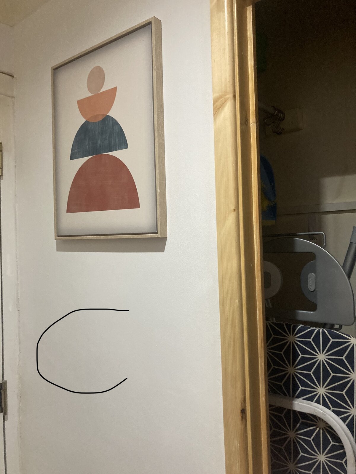

Hi there. Wall C is again around 70mm thick and when I tap on it feels hollow. I’ve managed to get my phone camera into one of the down light holes and record a video. The beams run across wall C and it appears to be plasterboard on top of wall C between the beams and the wall if that makes sense
Above wall A is a bedroom and I don’t think this wall is load bearing as it sits parallel between two beams so I can’t see how it could be load bearing.

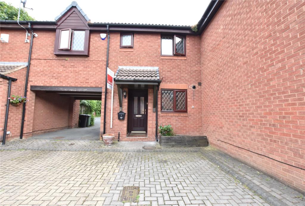

I have attached a typical layout of the house. As you can see it is two stories with the main bedroom to the left overhanging as can be seen on the front view pic. Within the layout, you will see that the left drawing shows the original layout of the living room & kitchen. At some point wall 'A' was blocked up where it originally entered into the kitchen. I believe this was done to improve the layout of the kitchen. However, doing this has blocked out the natural light path from the kitchen window into the room hence me wanting to now take walls. I have also indicated the 'A' & 'B' out & make the room open plan. The kitchen units I was planning on moving to the cupboard space once wall 'C' was removed. I have also indicated the approx location of the prop & joists. As you can see wall 'A' runs parallel between two joists hence I am sure this isn't a load-bearing partition. The walls that I am not too sure about are 'B' & 'C'. But as I said in my previous comments they feel like partitions walls but I am not sure if they are adding to the structure of the house.
Looks pretty good , B cannot be supporting much. But I would remove the greenery from the gutter...

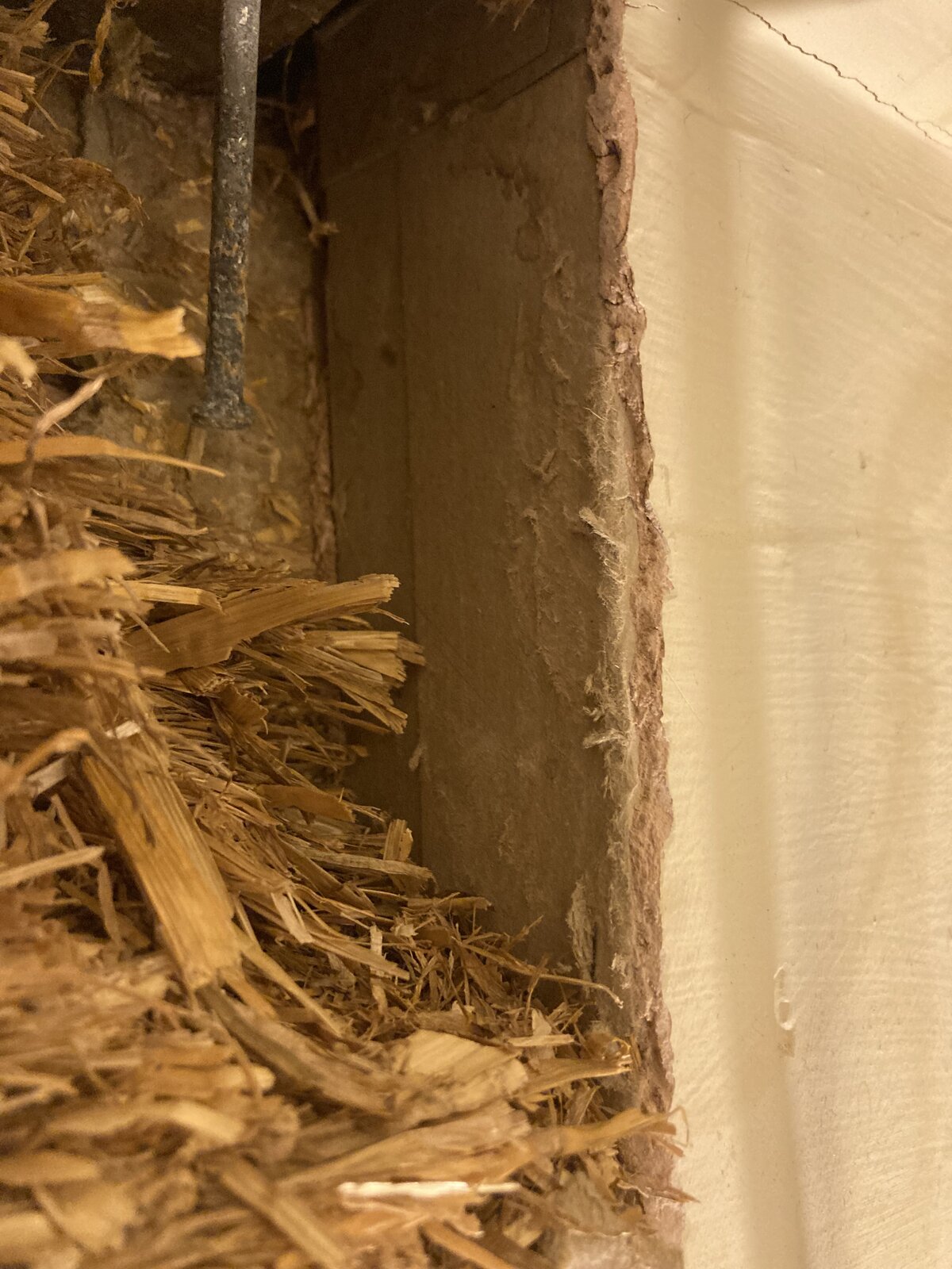

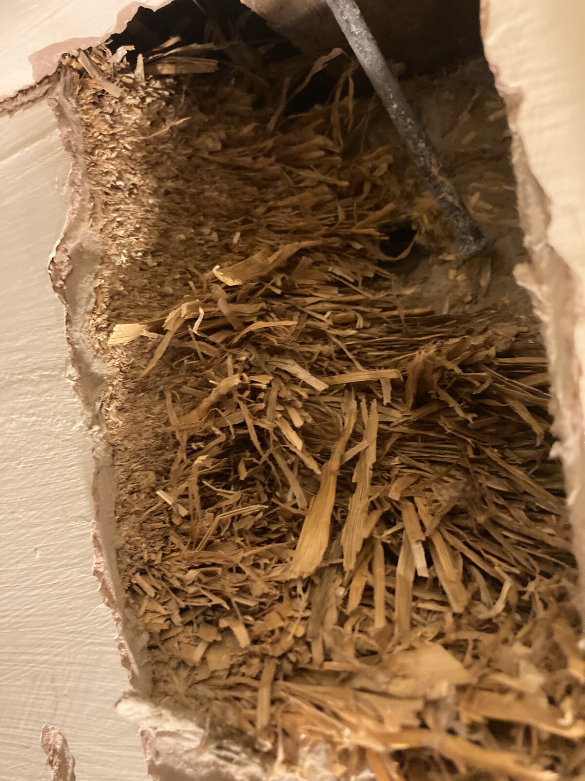

I cut into wall ‘C’ last night right at the top and the partition walls are not the stud type as first thought. They are made from strawboard and I can’t as of yet see any frame.
Those just look like insulated panels, you can see the void above, I doubt you will find a stud partition, those are formed off site as panels and put in. time for brave man like noises...if it was me I would rent a few acrow props and a scaffold plank to run down the length of that wall... to be sure.
