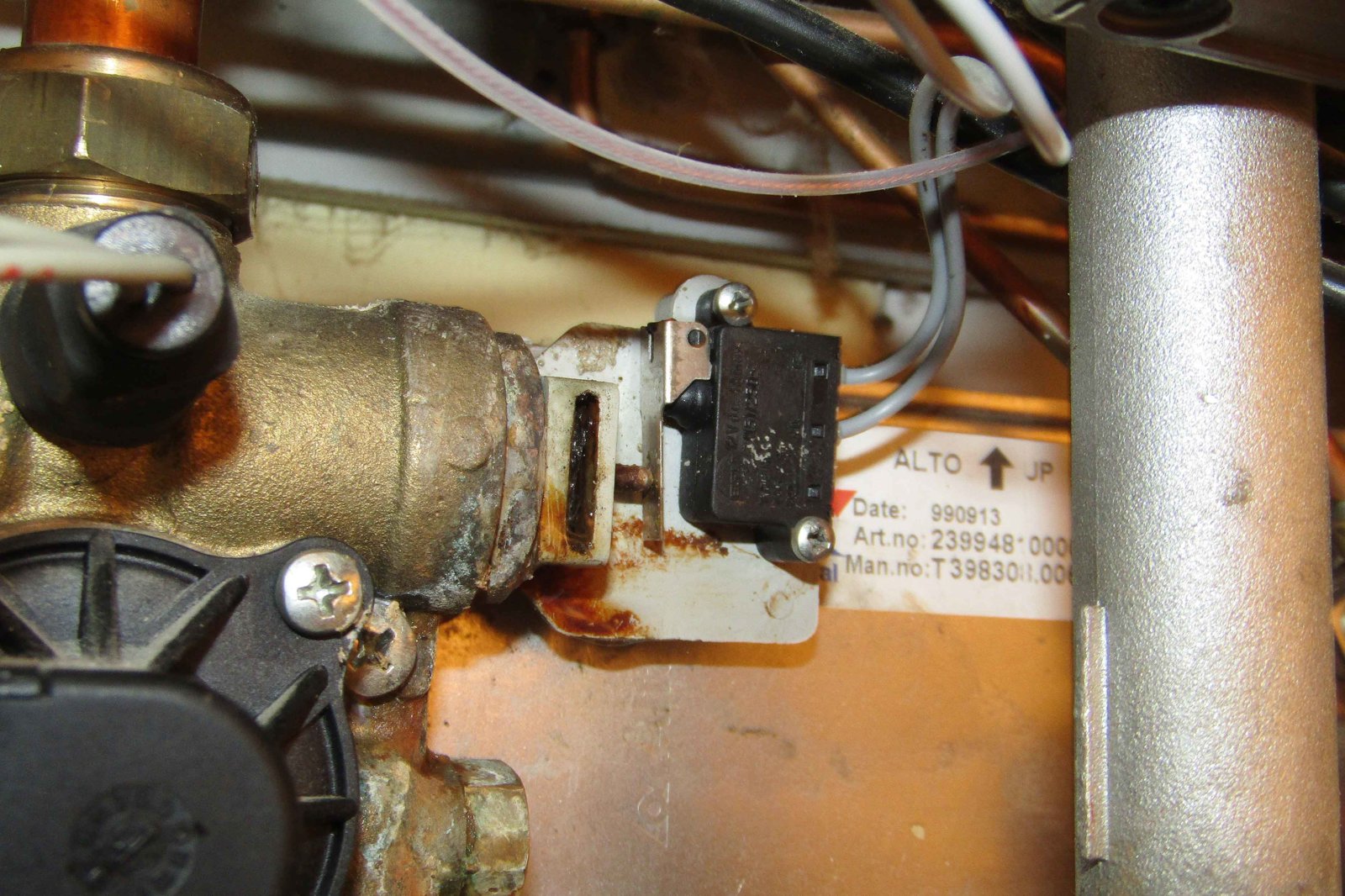

Hello and thank you for your input so far. It is appreciated!
I have attached some images, to help you help me please?
It clearly shows the leak coming from where the micro-switch base connects to the diverter valve.
Any suggestions and instructions please?
no need to turn the cold water supply off, just release the boiler pressure and place a towel and a bowl under it and swap the tail piece in your pic, but clean the spindle well with steel wool before fitting the replacement
Thanks Ian.
I presume, when you say tailpiece, your are talking about the plastic mount/bracket (grey) holding the micro-switch?
If so, please can you tell me how it is fixed to the golden metal diverter valve unit?
Thanks,
Thanks,
How do I swap the tailpiece please? How is it attached to the main part please?
the bit you undo is in the picture , try looking in the instructions yourself first then you might be a little wiser ;) , a little self help helps a lot to understand what your undertaking
Um.... there are no instructions in the booklet that came with the boiler? (n)
it just unscrews, make sure you cover the PCB housing with a plastic bag and an old towel as some water will come out, not an amount to worry about so dont panic
Thanks ianmcd!
When you say unscrew....from where please? The plastic piece or from the golden colour rusty nut?
Thanks,
Hello again.
I have a little time to devote myself to this problem.
Unfortunately the plastic piece that holds the microswitch was clipped onto the diverter, by a square washer. It has rusted away. I have a new one on order for the end of the week.

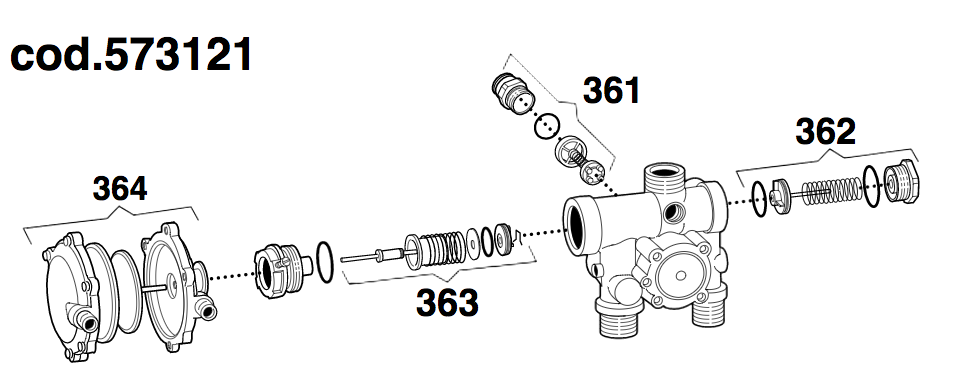

So I unscrewed the nut that holds the spindle and gave it a clean. All seems to be okay but that is where the drip is coming from??????
I unscrewed the nut that holds the spring and spindle. Also gave it a good clean.
So as it stands, I can't really see where the drip is originating from?
Any ideas please? Could it be the washer that goes on the spindle's base, as the washer on the main nut seems to be okay?
(The far left washer on the exploded view 362).
