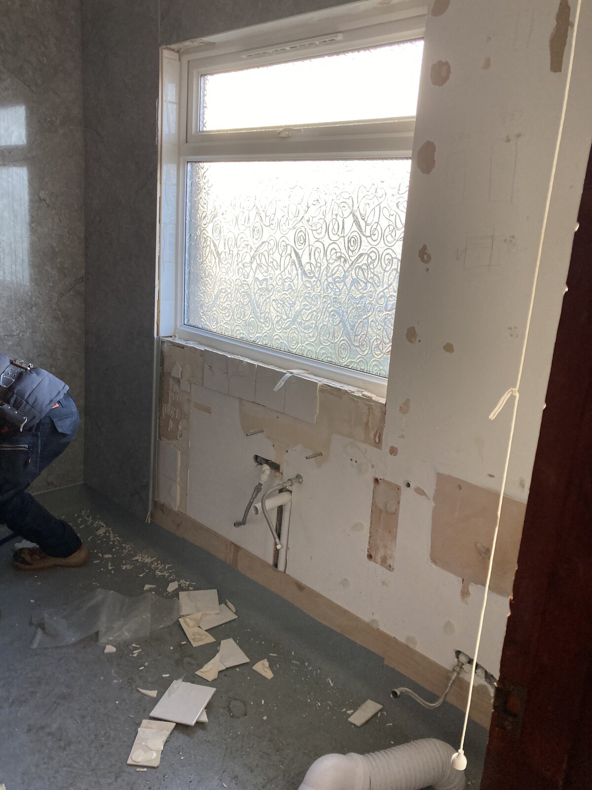

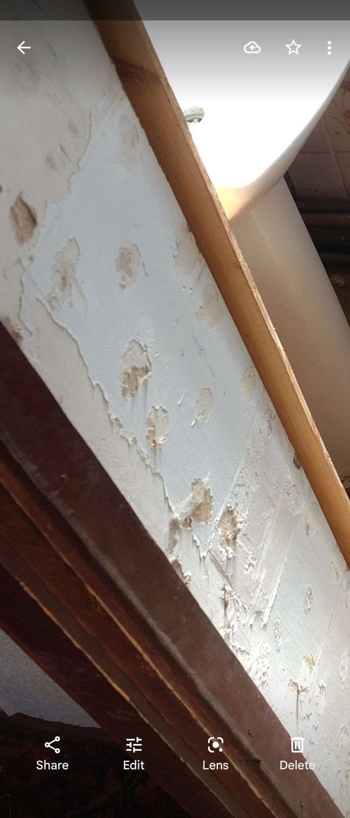

I have been so so worried about all the boards we pulled off. I’m talking every room! I really hope they were just plasterboards. Just the fact the door had AIB has really freaked me out! I’m a 30 year old female and not used to DIY lol! This is in the bathroom and there were tiles on top and then they’d boarded over with wooden slats!
that looks like plasterboard so ok

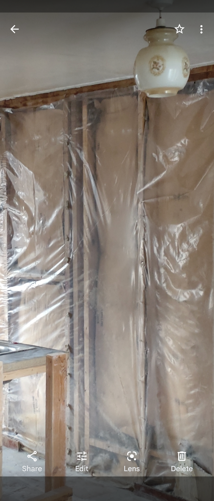

Eee honestly, I’m making myself ill with it. Everything is in bags ready to be taken away and the house is just a shell but now I’m thinking about the insulation in the walls!!! It was brown paper backed and like a fluffy thin wool but long hair if that makes sense. So now I’m googling asbestos insulation
thats just standard insulation dont be worrying about that

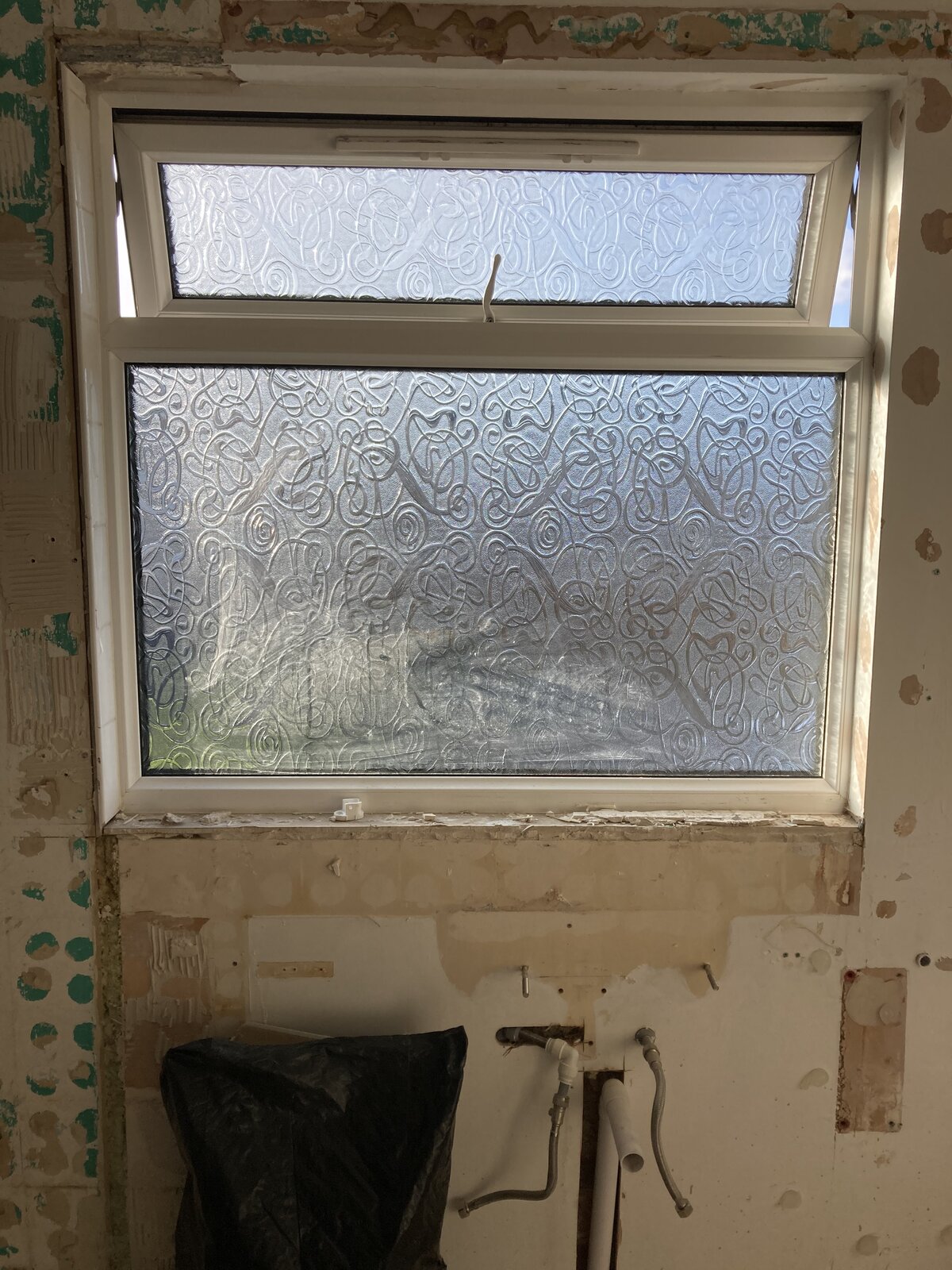

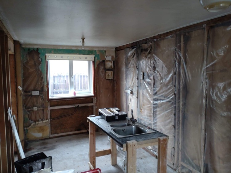

Thank you! This is a newer part of the house that was a bedroom and made into a wet room by the previous owners. Not sure if it’s just cement around the windows but I doubt asbestos?

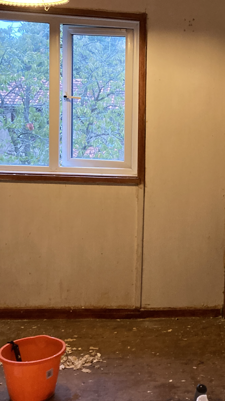

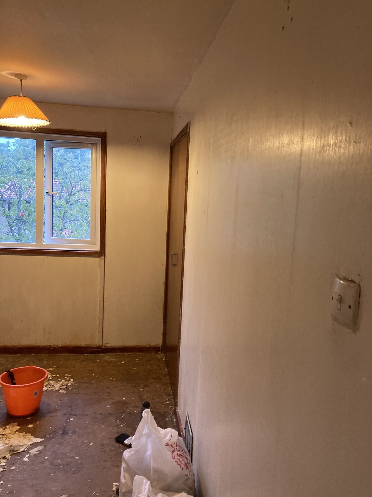

Also this is the thin bosrd I was talking about under the windows in the bedrooms. The side panel I think is plasterboard but the one where the lays are directly under the window is thin and there’s just a brick wall behind it!

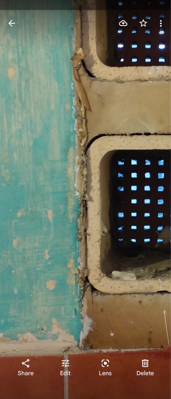

This here is in the kitchen near the window. Those air vents were covered by a kitchen cupboard and apparently used to be used for larders. Hoping the board is just plasterboard again! It’s gone now but I’m panicking !!! ‍♀️

Those thin boards can be AIB only way of telling 100% is testing
It doesn’t look like the AIB board on the back of the door… we took the kitchen one off however, the fact there’s no insulation behind those under window boards makes me wonder.. literally just hate brick x

This was how the insulation looked. So there was a plasterboard (I hope) then the plastic membrane then a brown backed insulation sheet which had been there since the house was built in 1969
