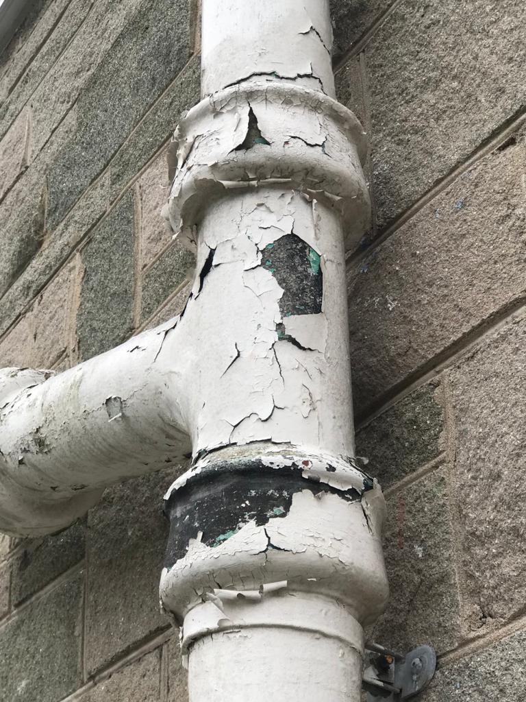

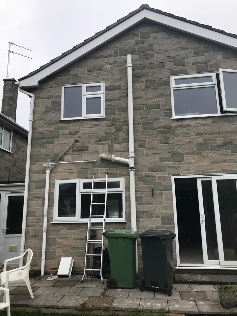

Hi There,
I have a suspected asbestos soil pipe to my 1960's built property in Bristol.
I have two questions..
1) Is there a sure fire way of telling if the pipe is made of asbestos without going through the cost of having it tested? When tapped the pipe makes more of a hollow ringing noise than a thud as you might expect of a concrete type material (asbestos). I have put a magnet against the pipe and unfortunately whatever the material is it does not appear to be magnetic..
2) If indeed the pipe does transpire to be asbestos, I have seen that you can now buy what is essentially a connector of sorts (looks like a pan connector) to take old sized cast iron / asbestos pipe to new size UPVC.. Should I be cutting the existing pipe at ground level, connecting to upvc and then rebuilding from there? Or should I be completely removing the asbestos / cast pipe all the way down to the point it meets the drain (will involve some minor excavation but so be it) and renewing completely?
Any ideas / tips on this would be greatly appreciated

If it is asbestos you don't really want to be cutting it. If it is in good condition and where you want it then seal it (paint) and leave it alone.
You need it testing to be 100%, if you suspect it, you could always use a removal firm. I agree with @oldbutnotdead, don’t go cutting it if you suspect it is.
Put a magnet on it ... if it sticks then its cast . If not then more than likely asbestos
I'd be 99% sure that is asbestos cement, simply by the distinctive shape of the collars. Acid test would be the magnet, soil pipes of that era were either metal or AC. If as you say, it doesn't stick, then you're pretty likely to have AC.
The last thing you want to do is break it or anything else that will release dust. If DIYing, wear disposable overalls, a quality dust mask, dismantle with care, keeping it wet whenever possible to reduce release of dust, wrap it in suitable polythene, and dispose of correctly. Replace the lot, excavate as required (carefully) to expose the underground drain.
Note, the hopper and downpipe are also highly likely to be AC. I'd remove these at the same time and reroute the wastes into the new stack.
Hi, thank you for the response. Very helpful.
Yes, the magnet did indeed not stick so I had pretty much resigned myself to it being asbestos..
I have checked and my local tip will take asbestos as long as it is double wrapped, so I have purchased some asbestos disposal bags, ALL appropriate PPE and will now begin the process of removing the old asbestos pipe myself...
If I follow all correct procedures (which I absolutely will!!) is there any real reason why I cannot do this myself? My plan will be to tower scaffold around the stack and then cut away sections slowly and carefully whilst double bagging as I go...
Thanks all for your help.

You could wrap the installed pipe in clingfilm/pallet wrap before removal
As all the advice above, if you can break the joints you'll generate much less dust. Any cutting will create dust....

I'm 100% with Hugh there - even the pipe bracket is for asbestos pipe.;)
