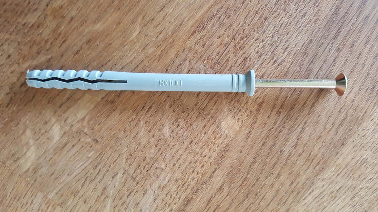

I am wanting to attach some IKEA kitchen cabinets to my garage wall. The wall is a single block roughly rendered wall so before mounting cabinets I would like to put some plasterboard over it to tidy it all up a little bit. Because the electrical sockets are surface mounted I reckoned it would be a good idea to attach the plasterboard using timber battens.
IKEA cabinets can be fixed to the wall using a suspension rail, so my idea was to attach a batten horizontally behind where this rail will be and attach the rail through the battens into the wall. Does this seem sensible? What type of fixings would be best to attach the rail through the plasterboard and batten into the wall? The battens won't be as thick as a regular stud wall so I don't think I can just screw into the wood alone. I'm obviously pretty concerned that this rail has no chance of detaching as the wall unit is pretty heavy!
Thanks for any thoughts.
