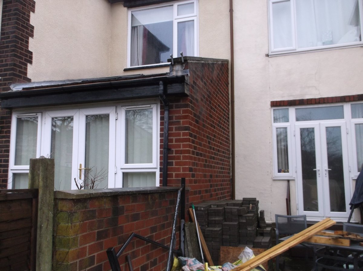

This guy's neighbour has built up to the boundary and used a low parapet wall finished with coping stones (probably cut-down flags actually).
The overhang is about ½", though in theory s'pose it could be 0. The rainwater run-off might cause staining, though.

Thanks for the reply though - was thinking even with a once weathered coping it would still need a bit of a overhang...
