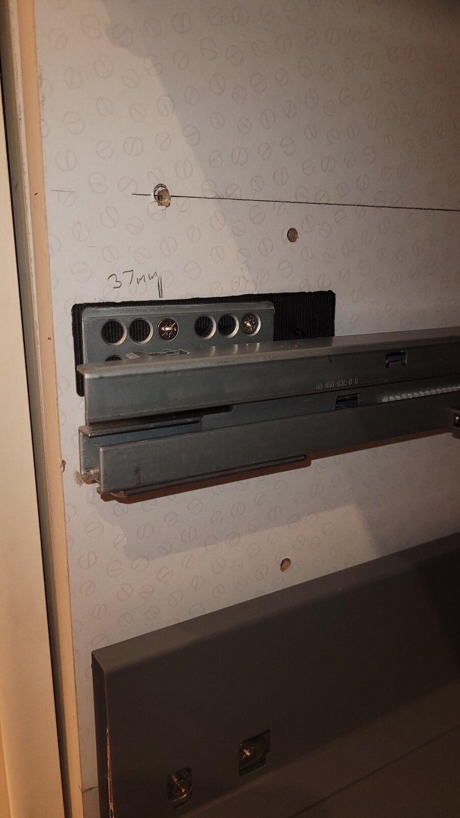

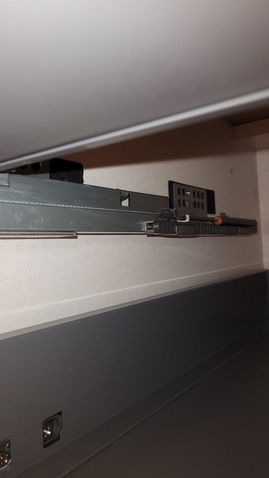

The cupboard might be too wide, just replaced old b&q runners with soft close drawers, a 2mm packer behind each of the screw plates and it works perfectly. The old 500mm Cupboard internal width is ~469mm the new drawers are for 464mm.
Screwed in the first screw on both runners, attach the drawer, fully extended, level ontop mark the back hole on one side, screw in, repeat for second side. Cut a slot out of the 2mm packer, release screw to slide packer in, then a couple more screws in the runners.
Shallow drawers; Screw holes for the top row are ~55mm from the bottom of the drawer front. Gap between drawers/doors ~2-3mm.
