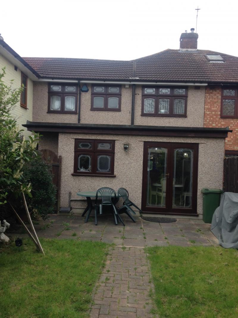

hi All
i need some advice please.
i bought a 3 bed house, which had already been extended at the back-just ground floor extended.
now am planning to build on top of the extension to get more space upstairs.
what do i need to look out for?
how do i know that the foundation for the ground floor extension can sustain the top, if we build on it?
do i need planning permission
how do i go about this whole process, as i have not done this before.
any advice is highly welcome.
please see picture
many thanks
You will need planning permission, do you have any information regarding the single storey extension. The architect, builder and planning office could possibly have info on what footings/foundation were laid.
+1, you would need planning permission.
Before building, your inspector will want a trial hole dug to see if the existing footings would be suitable for the increased loading.
Going back to the Planning aspect - it is possibe your council would not permit 1st floor extensions up to the boundary, so you may have to set it in.
You also seem to have a large extension on the left - that may mitigate against any further extensions?

i have no information or documentation for the single story extension already there.
it was there when we bought the property 9 years ago. i asked for some paper work from the owner at the time but i was told its not necessary as the extension had been there for over 20 years at the time we were buying. i wasn't too worried as similar extensions had been done by some of the neighbors too.
the building on the left is not an extension. its my next door neighbor but his property is not extended. his property is just a bit further down and has a bigger drive at the front. my property is closer to the main road in front with smaller front drive and a longer garden compared with my neighbor.
it sounds like i should start with an architect and surveyor? or which one first?

Get yourself 4/5 buckets or start a pile, a shovel, a trowel, and a core drill.
Dig a smallish hole and keep going til you hit the concrete strip. Core it through if required to find full depth of extension footing.
Took a couple of hours for me and got depth of 3ft, now on drawings can discuss with council, architectural technician etc...

Why would you drill through the footing when you could just dig down the side to find out? :confused:

Unless I'm missing something, there's a window on your neighbours house at first floor level which you'll be depriving of light etc. Talk to some one-man-band architectural technicians, no need for architects. But yes the existing foundations are the start.

I couldn't find it where is was expected, and as I've found later by digging the foundations for the extension, the edge is actually 12" away. It was easier to get the drill out.
Either they went for a 3' strip footing, or my inner leaf is standing on the edge of the concrete. I suspect the latter.

there is actually an alley way between my property and the neighbors. its underneath and leads to the garden.property is semi-linked ie linked at the top with alleyway beneath. so if the externtion goes ahead, it will not be attached to neighbors property, although potendially block some light.
i have spoken to the neighbor and he is ok with it. if the extension goes ahead, there will still be about 4-5 feet between the extension and the neighbors window.
