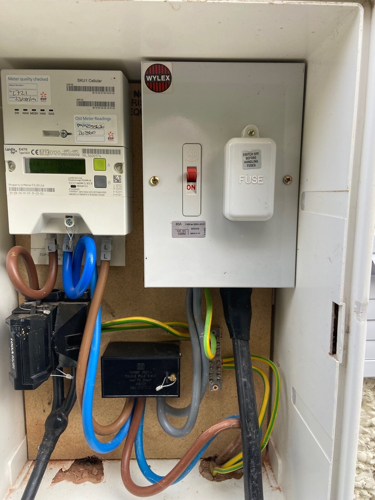

- Is there a desirable maximum cable length to connect genny to domestic electrical network (I have in mind a run of up to 25m)?
- Looking at the layout of installation in my meter cabinet, does the following wiring solution (word picture) make sense?
1. As seen in the pic, the supply from the meter is split at a (Henley) connector block. One P&N pair goes through the house wall (bottom of cabinet) to a 20 way CU (“DB1”) located on the inside of the same wall. The second pair goes to a switchfuse from which the SWA cable seen runs through the house foundations to a second CU (and sub-CU) (“DB2” and “DB3”) in the garage on the opposite side of the house. As I understand, a switchfuse was not required between the meter and DB1 because the separation is <1m.
2. Setting aside (for now) any question of physical space limitation, my idea is that the meter tails should be diverted to a ‘break before make’ changeover switch, which would have a corresponding feed from a genset source via a 32A male inlet socket mounted on the house wall outside the cabinet. a P&N pair from the changeover switch would then lead to the connector block. If the need to use the genset arises, I would wheel the genny to its operating location, connect a 32A cable between the genny outlet and the male inlet socket, then throw the changeover switch.
I’d appreciate any and all comments and observations on the above. TIA.

I do not profess to be an expert on this specific topic, but it seems to me that the most significant point that you haven't addressed in your plan so far is earthing.
From the photo you've supplied, you appear to be on a PME or TN-C-S earthing system, although the usual sticker warning of this is not present. Your DNO will not take kindly to you relying on this earthing system when using your generator, and you will likely be expected to provide your own in the form of earth electrodes. However, the DNO may well place restrictions on how your earthing system may be connected to theirs, and as far as I'm aware, having a switch in an earth conductor is forbidden, so a discussion with your DNO's technical department may be necessary with regard to what they will accept. It should be noted that the DNO have their own set of rules separate from BS7671 and it is not always straightforward to satisfy both.
Yes, you're quite right on the earthing arrangement. The DNO earth is TN-C-S as you surmised.
I had thought of installing an earth rod in the operating location and I would make the connection if the need to use the genny arises. Not foolproof but I'm not looking to achieve that,

The problem you may encounter with that is than in some (admittedly rare) fault scenarios, the voltage on the DNO's earth can rise significantly above that of the local "true earth", and if such a situation does arise, there are 2 possible issues. If your earth electrode is already connected, a significant current may pass between the DNO earth and yours, so you would need to ensure that your cable is of sufficient size to deal with that. If, on the other hand, you were to connect your electrode whilst such a fault existed on the DNO network, you could receive a significant shock, and/or arc burn due to the potential difference between their earth and yours. On the flip side, the DNO would be extremely unhappy if a fault on your side somehow raised the voltage on their earth to a point where it could be dangerous to someone working on repairing a cable. Also unlikely, but not impossible.
Earthing can be a tricky one, a good few radio amateurs have experienced unfortunate side effects due to incautious connection of radio transmitter earthing rods to mains earth.
Hmm. So is the answer, when using the genny, to isolate/disconnect the DNO earth from the MET and connect the local earth? Is there a switch one could use to do that?
That may be a solution. There may be more than one solution. At this point you're going to have to do some reading I'm afraid.
Switching of earth conductors is generally prohibited, but there are certain exceptions and it appears your situation could be one. You'll need to look at BS7671, regulations 543.3.3.101 & 537.1.5 for a start, and all the other sections referenced by them.

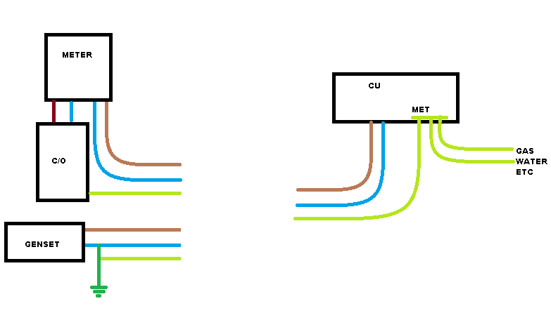

Thanks for the input. All adds to the rich tapestry. :)
At what point does the earth connexion become sacrasanct?
The DNO provides L,N and possibly E. The electrician does everything following those 3 terminals.
If the property were instead run off a generator and no DNO supply existed, would those 3 terminals be provided as part of the electricians job?
Would it not be proper if those 2 sets of terminals sat side by side and the 3 wires moved between them as required?
Something like this:
