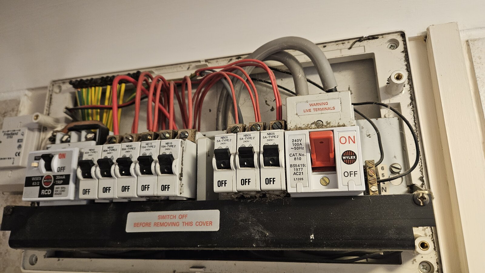

I'm having my board replaced with a new dual rcd one. My electrician opened my old one thats been in place for 25 years and I noted some units that have been doubled or sometimes tripled! See attached photo.
Is this bad / risky practice? I know very little but would be good to understand what previous owner/electricians were doing. Were they just saving having to put in another unit? Is this acceptable?
The 3 on the far right are smoke alarm and lights. There does seem a spare slot (thinking of an EV charger) but now I'm wanting to replace the whole board.

Main switch, surge protection, RCBOs for each circuit.
A dual RCD clearance special from a DIY shed is the same as you have now with an extra RCD to cover the lighting. Entirely pointless and what was being installed 20+ years ago.
A fault on a circuit takes out half of the others as well. Just what no one needs.

Thanks thats useful, appears to be more space efficient too
They are, however you should also get one with several spare spaces to allow for extra circuit in the future as it's likely to be there for several decades.
Cancel the dual RCD and opt for a RCBO board.
Doubled - could be a ring
Tripled - could be a ring with a spur at the board
Be prepared for extra costs
The EVSE will require a dedicated RCD which interrupts all live conductors. Very few brands/models of RCBO will meet this requirement.
The single modular width RCBO does come in duel pole versions, but only the line is monitored for over current.
The problem is they seem to only come as type A, you can't it seems get a type B as single width, but if there is 6 mA DC detection and disconnection then does not need type B, and at cost of type B would not want to go down that route.

Interesting statement, given that you seem to be 'condemning' a CU for being "at least 30 years old" :)
