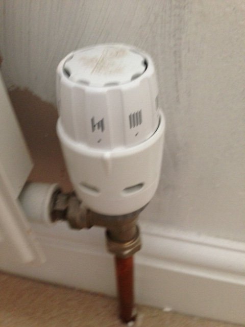

Hi guys,
I have been doing some reading and I think I need to balance my radiators as the heat is uneven and the bottom of the radiator for our downstairs radiator tends to be cold.
I have read I should be adjusting the lockshields but for both of the upstairs radiators I cant see where I am supposed to be adjusting....
They both look like this:
Can you please help?
Thanks!
That's a Danfoss lockshield valve. You adjust it with a 6mm allen key.
