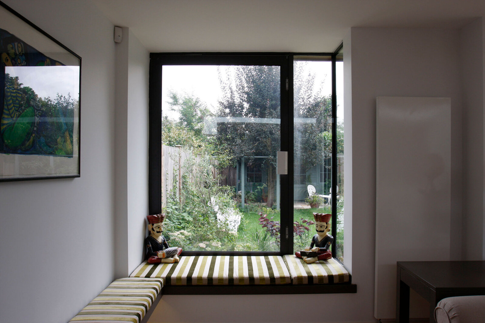

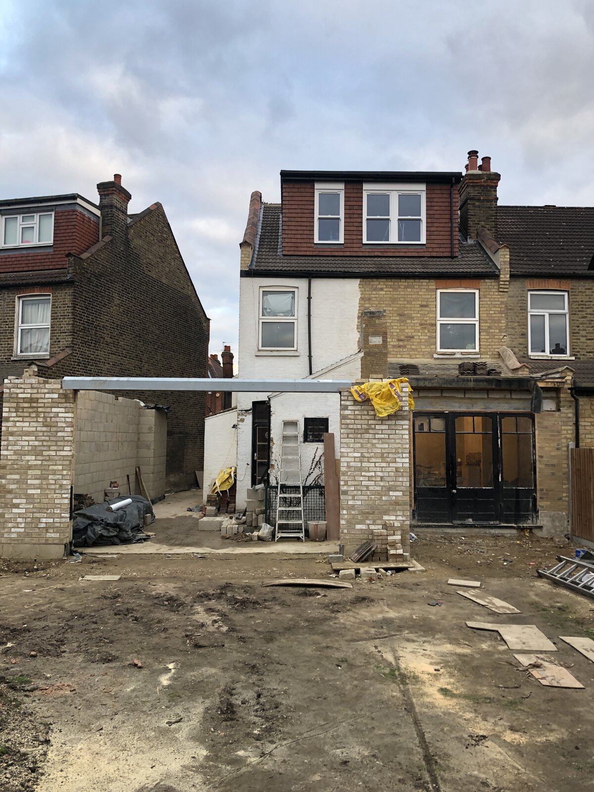

Hi all
Looking into installing one of these on the rear of our house. Got some rotten French doors to remove, and the opening will be partially bricked up. The "oriel window" will extend out by 300mm so needs a base structure to sit on. The window manufacturers have given me a drawing showing a steel frame for it to to sit on, but for a cavity wall (our external wall is solid 9 inch).
So after discussing it with some builders the frame could go through the wall and angle down and be fixed on the inside (make sense??). Ive been told the steel could create a cold spot inside though? Could this frame be made of timber? The width of the opening is 2.4m wide (!) x 1.5 height and 300mm depth.
Any thoughts!? Ive attached the tech drawing, a photo of an example window and our opening where the window would go (on the right of the rear of the house, not the large opening for future set of sliding doors)....

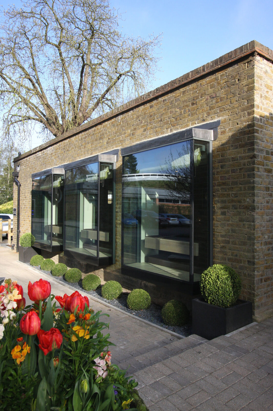

I have built large oriel windows (two of the biggest were about 2.5 metres high x 3.5 metres across) where we used timber framing to keep the weight down. In that instance (and 2 of the other 3 oriel windows on the same building) we were fixing into SFS (metal wall framing) - and all the walls were very thick. I suppose the weight of the glass, the timber frame and its' cladding, together with the amount of projection from the wall are all factors you'd need to take into consideration. The biggest issue might well be pull out of the lintel and masonry above the window
In the instances I was referring to the structure comprised four 4 x2in softwood ladder frames with 18mm plywood glued and screwed to both sides of the frames and to the front faces. They were insulated and over cladding was in zinc.

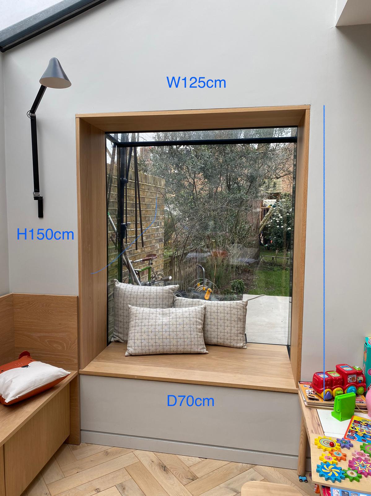

I'm pretty confident that a torsion box structure made using plywood skins glued and screwed onto a joinery grade timber framework is going to be strong enough to carry both the glass and a couple of people. Have you got any dimensions? Can the load be transferred into the roof or floor above the window?

2.2m wide, 1.5m high, oriel window is 300mm depth, window seat within window and back into recess is700mm
Ignore the measurements on the attached photo but this is quite similar to
What we are looking to do
