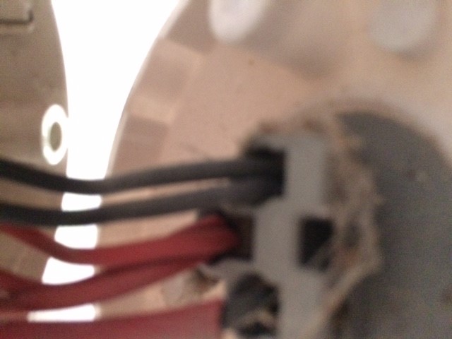

Hello friends,
I need your help to replace my old bathroom celing light to a new one.
The old ceiling light has many wires.
3 red in one slot (live all the time)
1 red in one slot (live only when the switch is on)
and 2 black in one slot
My newer light has only slot for three..L,N and earth.
How can fix this, pleae help.
Can I buy a 3way wago connector and put the 3red live wires and
1 red in Live Slot and 2 black N is another slot?
Please help.
You have the right idea.
The three reds (Permanent live) put togther in a separate connector.
The 2 blacks go to the light neutral 'N'
The single red goes to the light live 'L'
Earth is self explanatory
